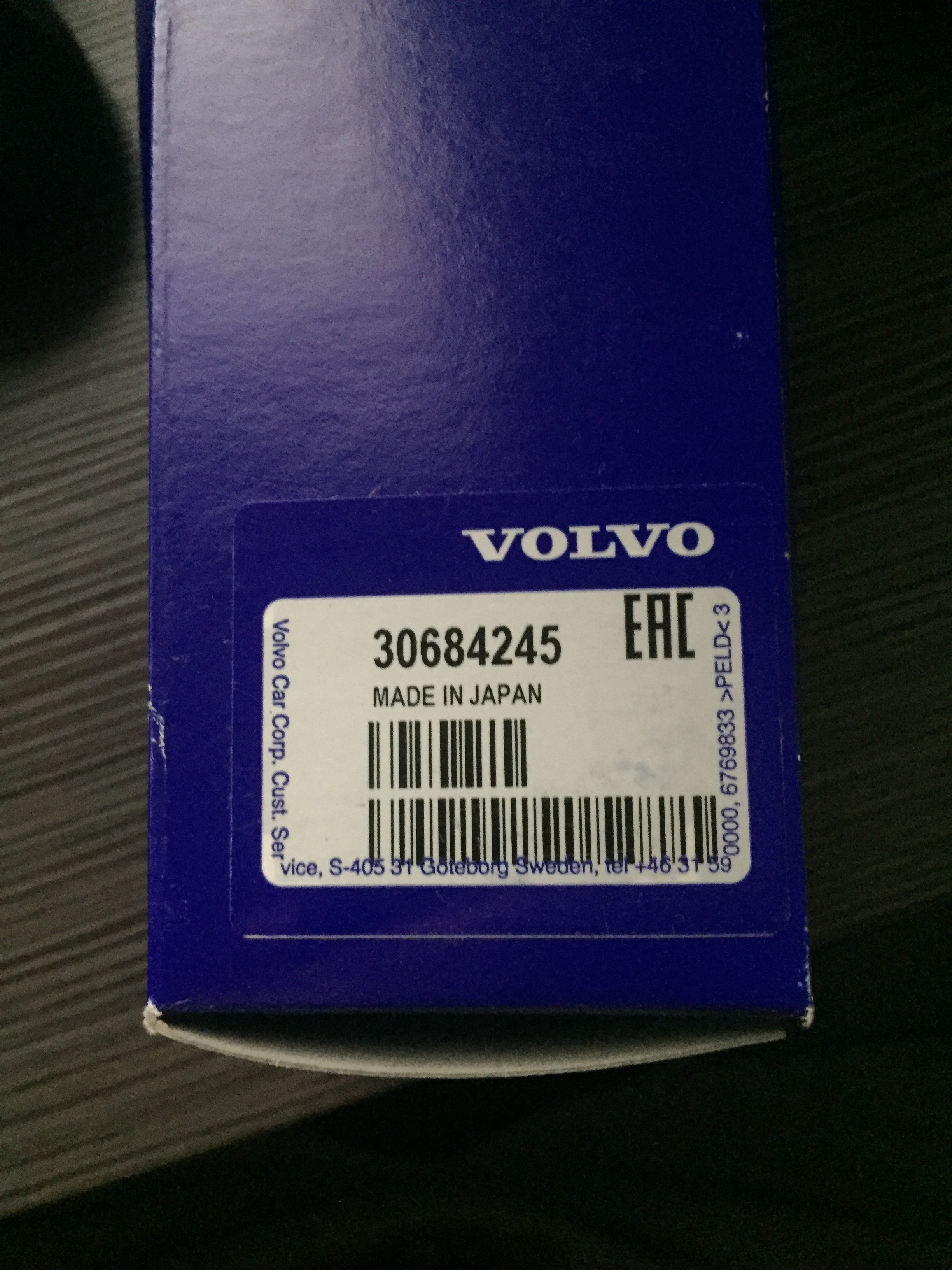

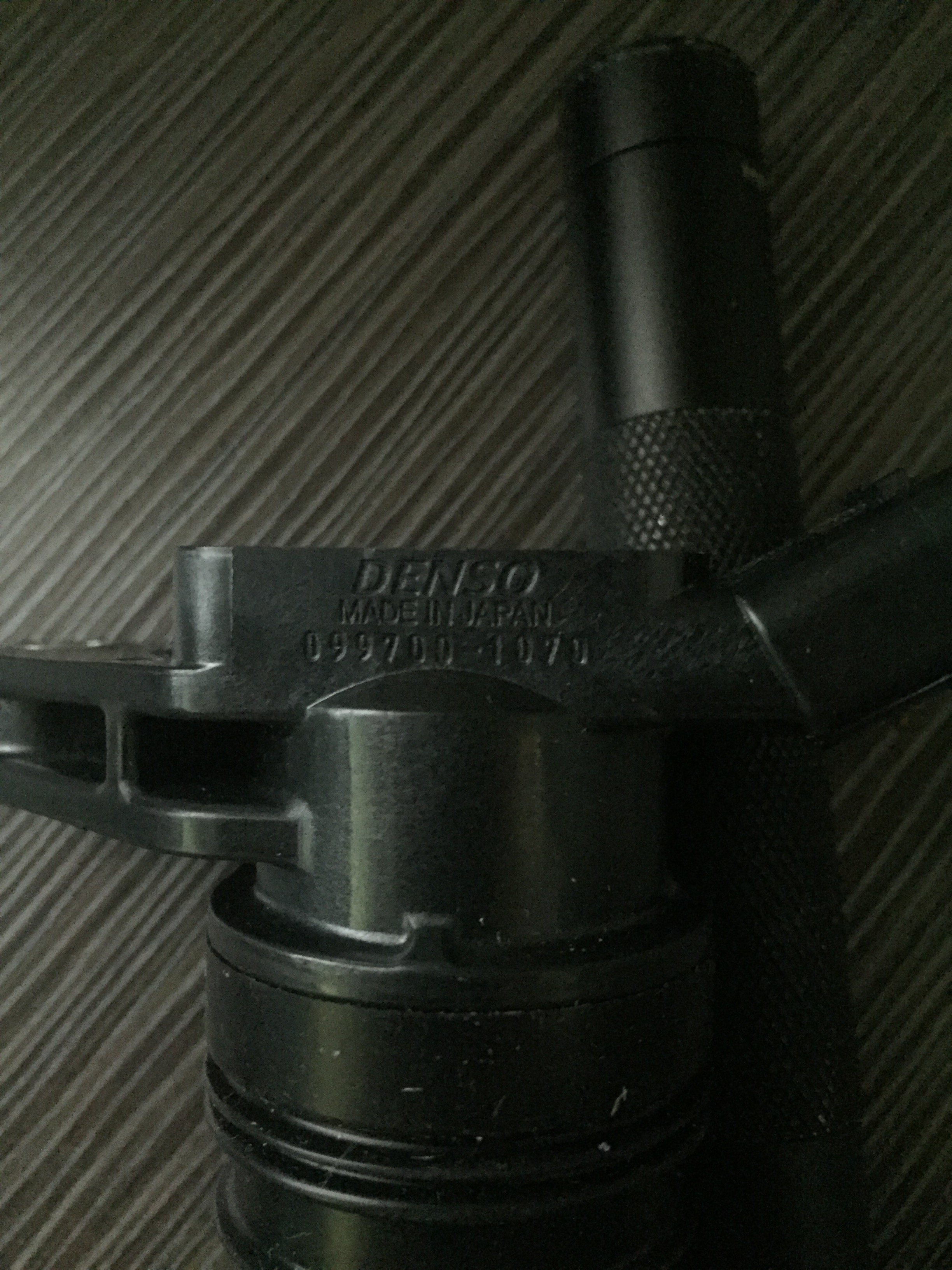

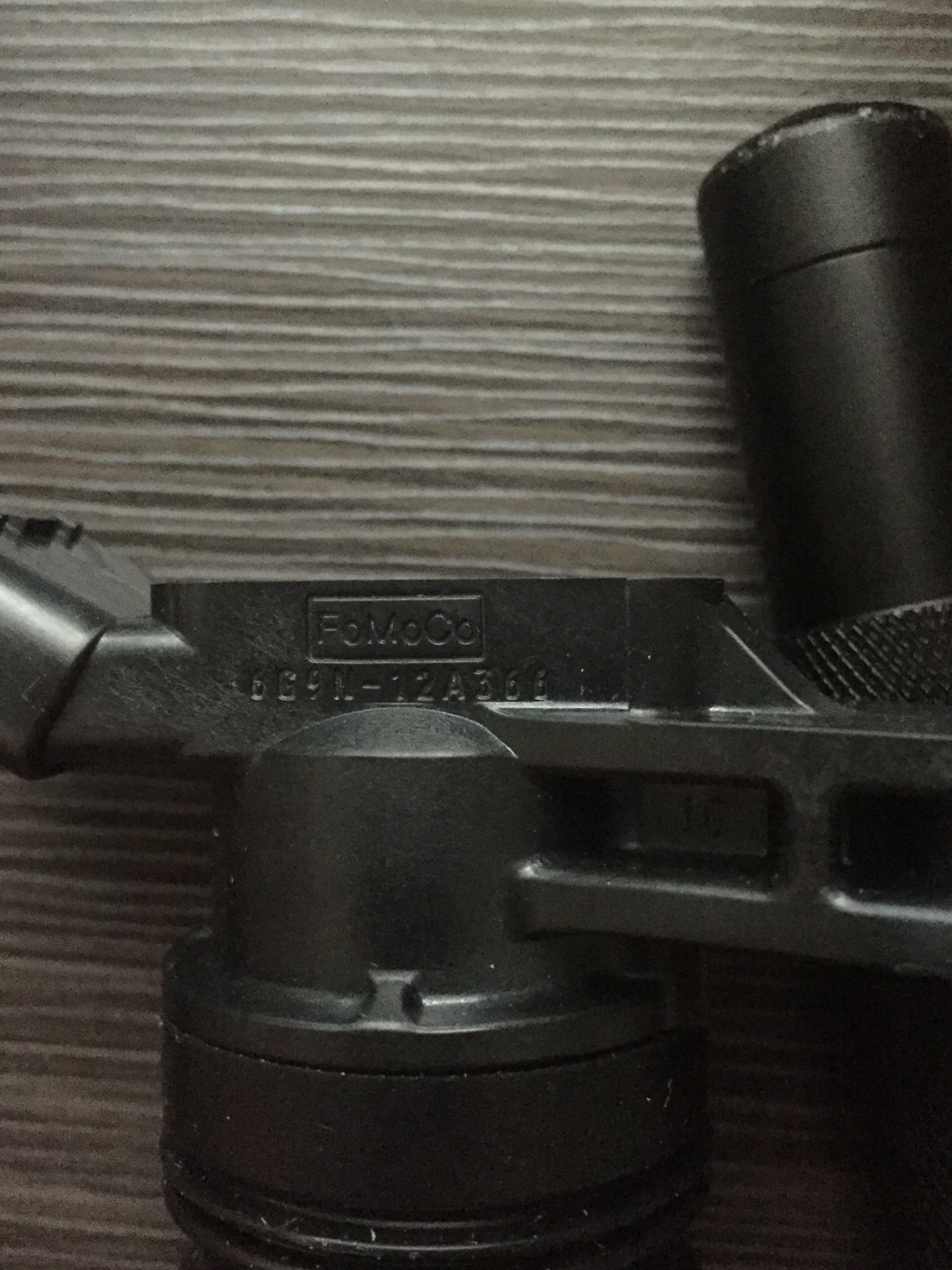

Post by pgill »
Xheart and Matt,
Here are the picture from the new coil that I bought
30684245 Volvo (Made in Japan)
6g9n-12a366 FOMOCO
099700-1070 DENSO (Made in Japan)
Do the Delphi coils have the same FOMOCO number? (I can see the FOMOCO in the picture at RockAuto but I can't see the number)
Thanks
Paul

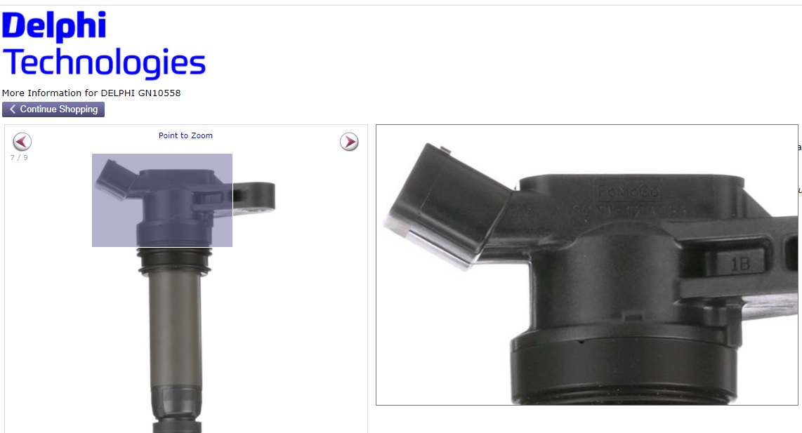

The DELPHI GN10558 direct ignition coil set I received from Rock Auto does not have either FoMoCo or DENSO engraved. The box sticker says, Made in China in 10 languages.
I had similar concerns – make, model, brand. I chose to work with the explicit 3-Year Warranty stated on Rock Auto order. After your Borg Warner product info, it assures A Bird in the Hand is Worth Two in the Bush.
pgill
Posts: 798
Joined: 27 August 2018
Year and Model: 2010 S80, 2008 LR2
Location: California
Has thanked: 115 times
Been thanked: 185 times
Post by pgill »
XHEART,
The picture from ROCKAUTO does show FOMOCO
It seems a bit deceptive that the parts you received aren't marked the same way.
