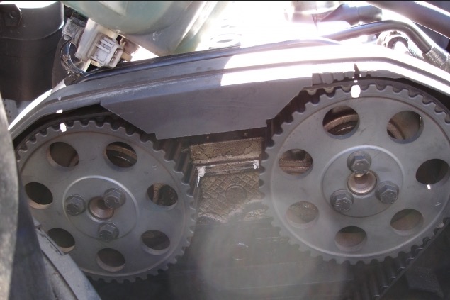

I have a question. Last summer i've replaced my timing belt. But i didn't have enough money for the crankshaft pulley.
I've bought a new one today.
Here's my question. To replace this crankshaft pulley, have i to block the 2 belts gears as i didi when i replaced my belts last time ? Have i to do my timing belt again ?

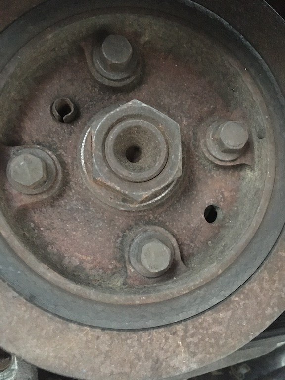

It has 151 000 kms and it's an OEM part, so, installed in february 1995. It's seems to be a litlle bit old for a OEM part...All parts ofmy timing are new, excepted this one.
A picture to be sure we're talking about the right part.

Hi Manov, like Misha says, why do you think you have to replace it? Some cars have rubber insulators on the crank pulley that can break down with age. They are to reduce vibration (damping).
So unless you have a rubber insulator on your pulley (I can't recall just now if these cars do) there should be no real reason to replace it unless it is showing huge amounts of cracks.
Now if the crankshaft oil seal is leaking or the seal face is bad on the crank pulley where the seal is, leave it alone. If the seal is leaking and you have to remove it if it makes you sleep better then change it out. But if all is good, don't waste time and money.

It never fails and there is nothing that can fail on it unless it is bent or hit by something...in fact your old one is good enough just like brand new one(if it is OE Volvo).
There is absolutely no need to touch it at all.
No gains and no losses too.

Hy Buddies,
Before to close this post, i would ask my question again : to replace this crankshaft pulley, have i to block the 2 belts gears as i did when i replaced my belts last time ? Have i to do my timing belt again ?

You don’t need to remove or block the time belt , Manov. I would leave the SERP belt on and use an impact to remove the three M6 bolts, then remove the SERP belt and the harmonic balancer
Oops. Made mistake. You need to remove the 30mm crank nut , too.
