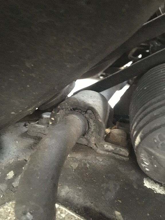

Bushes :

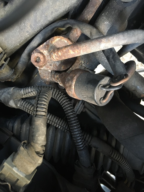

A last for the road :

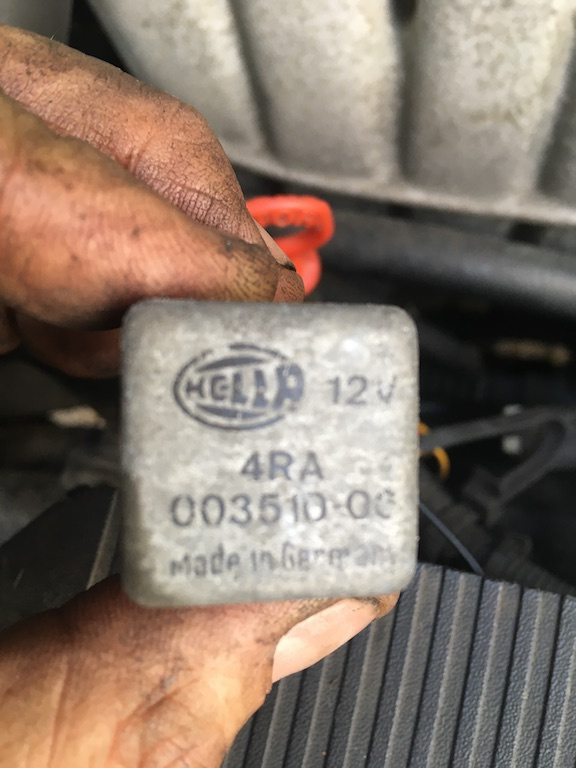

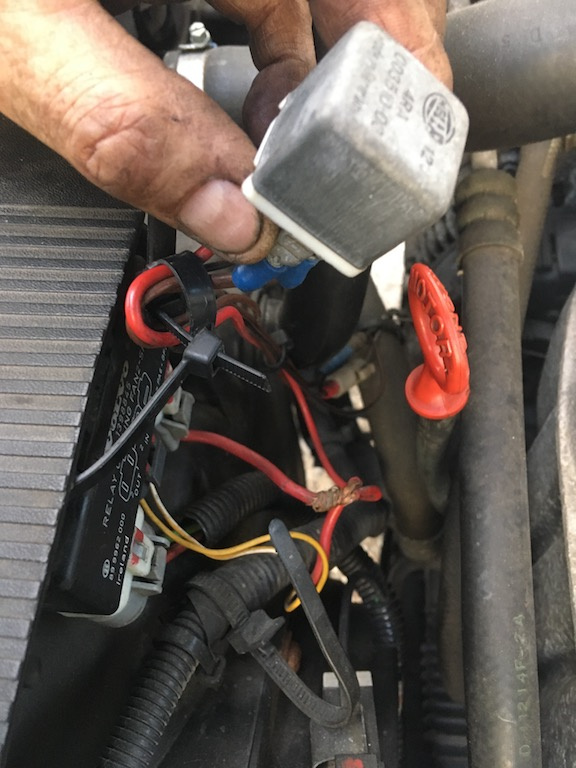

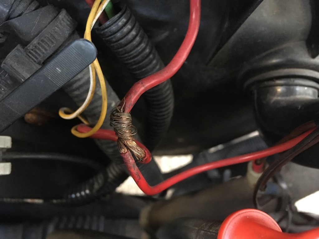

Ouch... I would clean up that wiring!

About the wiring, i have no idea on what this relay as to do for a job in the engine bay... I will make more pictures and post them.

That is strange, I'm not sure what the relay is for either. Looks like it could be the secondary air injection relay, but it wouldn't be tied into the fan power wire like that.

Search on web it’s a SAAB relay apparently…

I'd put all zero of my pennies on it being for driving lights.
ARB bushings don't look great either, I'd add then to the to-do list. The last pic is just map sensor and ac lines, of it's functional then its fine.
