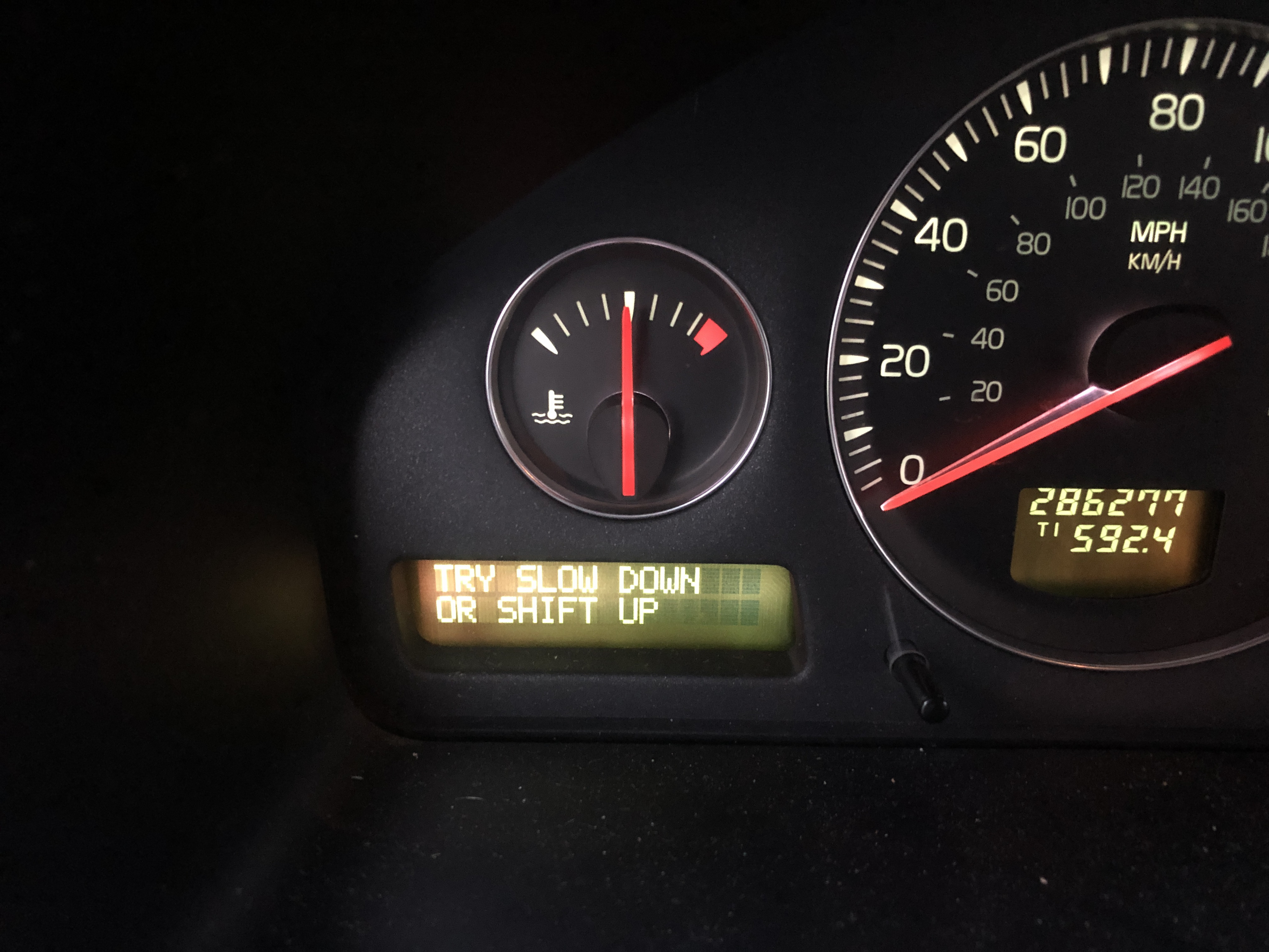

2004 V70 NA 5spd at 286k mileage.
Wagon runs well if air conditioning is off. When AC is on, the car will throw P0300 and P0420 code. Check engine light will flash and show "Try to slow down or shift up" message. If I keep driving, the car will run rough and hard to keep speed over 50 mph.

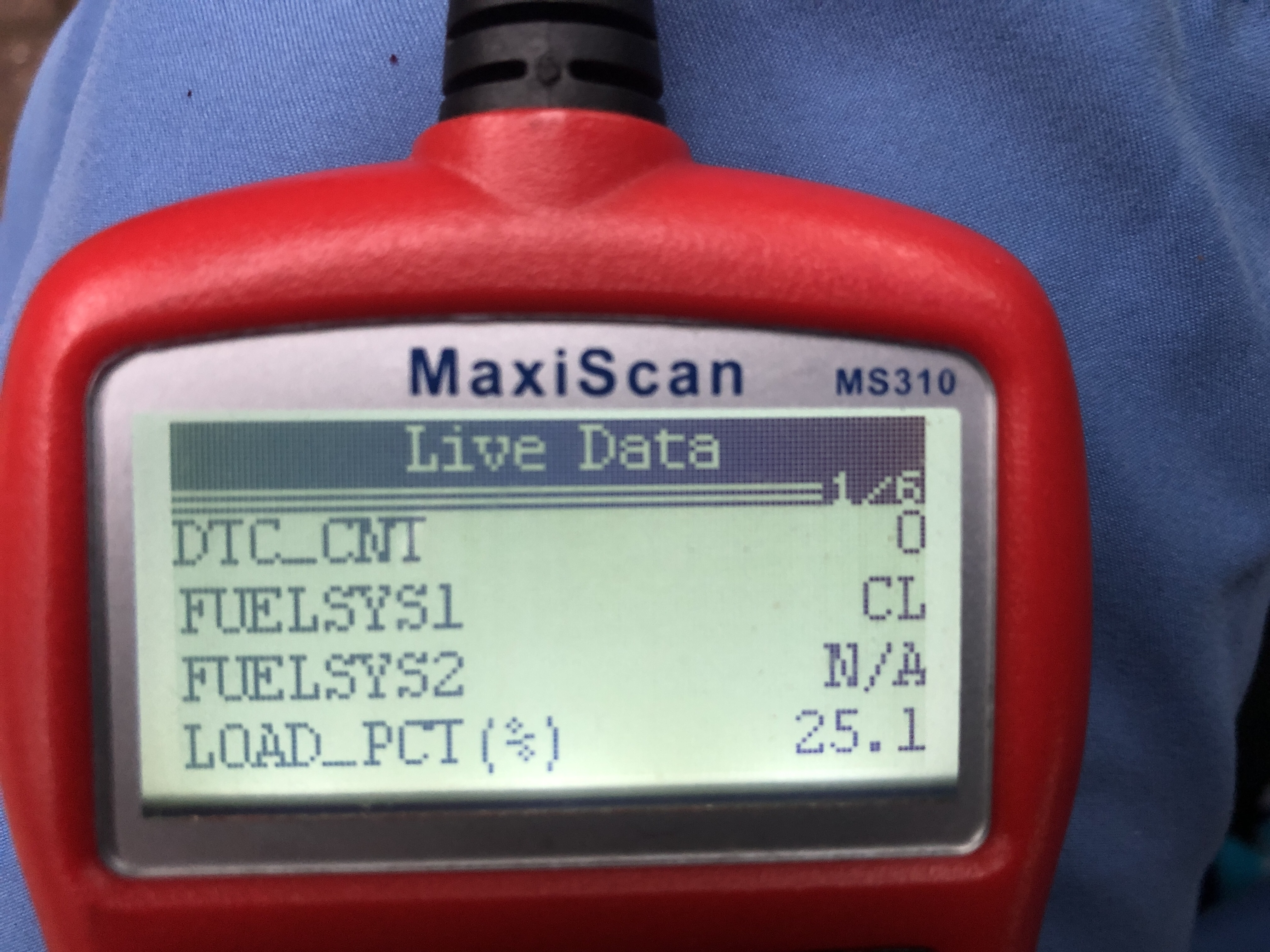

The small scanner gave some reading of fuelsys is CL under idle.

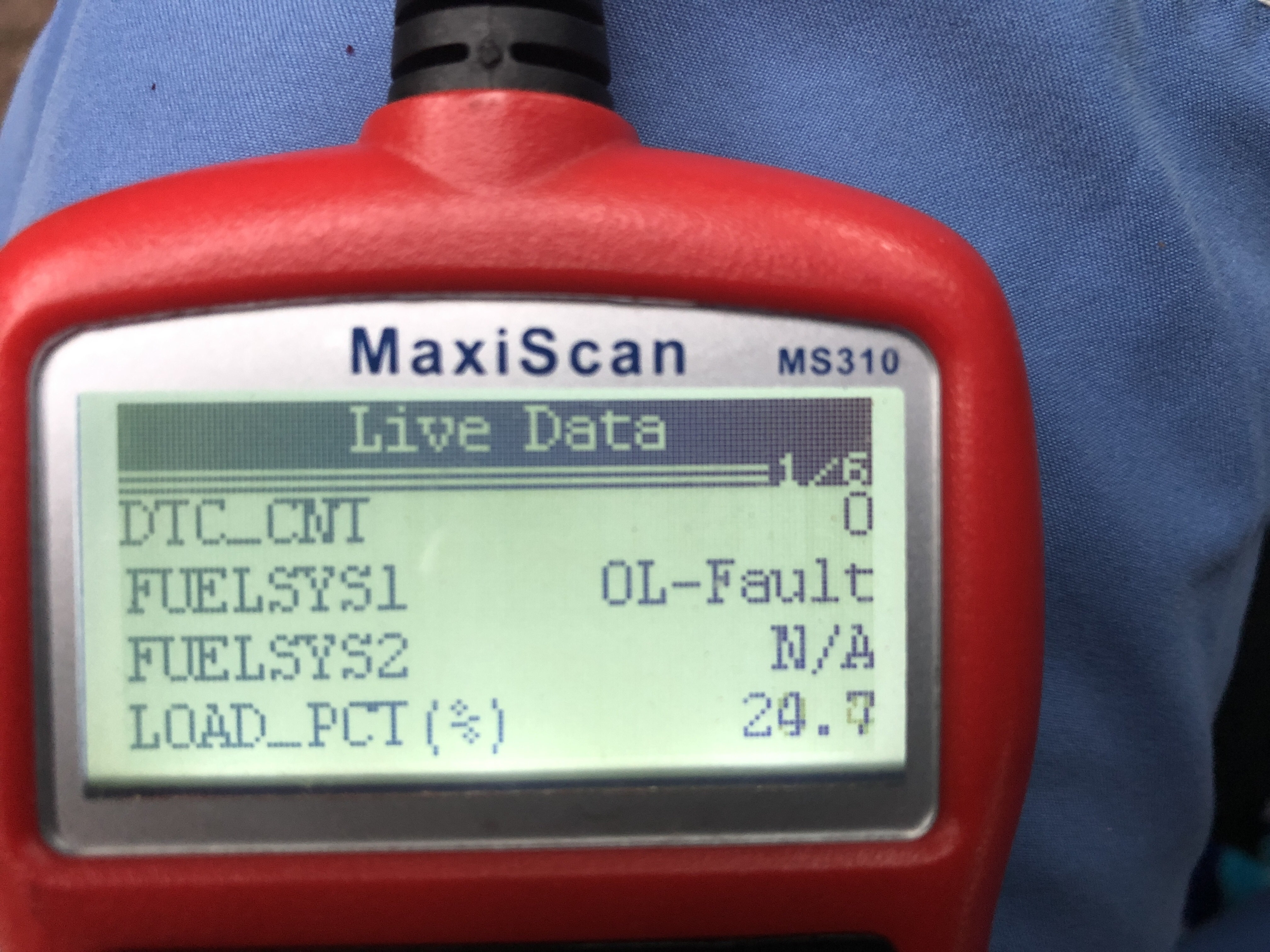

When I raise the RPM to 3500, the fuelsys is OL-Fault. The CEL starts to flash and misfire.
