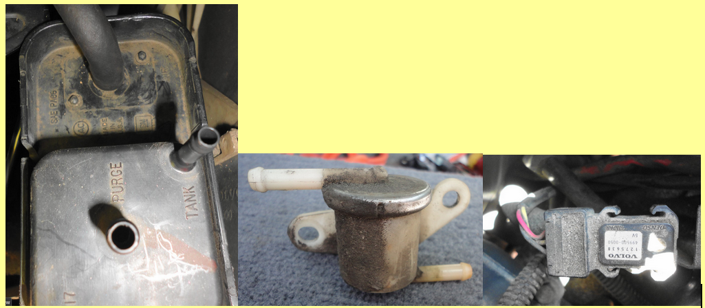

Begin with thanks to Deepsouth for his EVAP write up from 2014. For once, a system that matches that in my 1998 V70 with the canister in the front fender. I've smoke tested everything in the front end that I can do alone. Maybe this evening I can get some help to pump smoke back toward the tank. Two person job.
Here is a photo of some components:
I shotgunned the cannister purge valve and replaced it. Code came back.
I am suspicious of the shutoff purge valve and am thinking about applying some voltage to it to see if it even reacts.
Deepsouth mentions a pressure sensor and the rollover valve (pictured) back by the tank. I have the back of the V70 all apart and access to the fuel pump area, so I will try to look at these.
BIG QUESTION: What is the sense of the forum on how likely each of these components is to fail ASSUMING (will test) no leakage of air into system?
