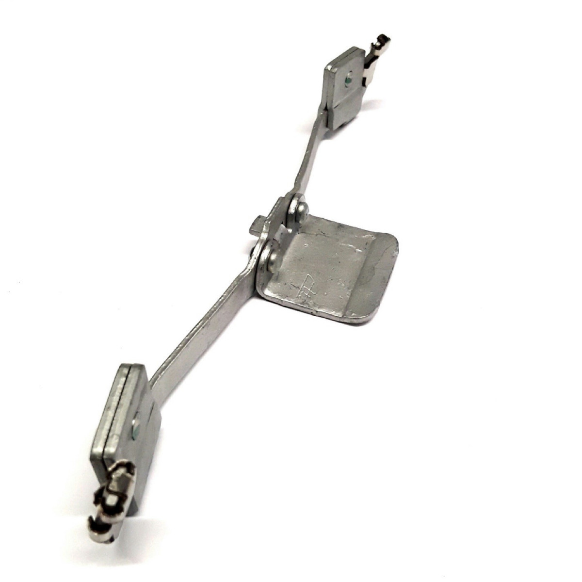

The 328mm front has double pot caliper, and the pad damper looks like this-
328mm caliper damper.jpg (73.81 KiB) Viewed 32673 times
If you have this damper on your front brakes, you have a 328mm rotor. That's it.

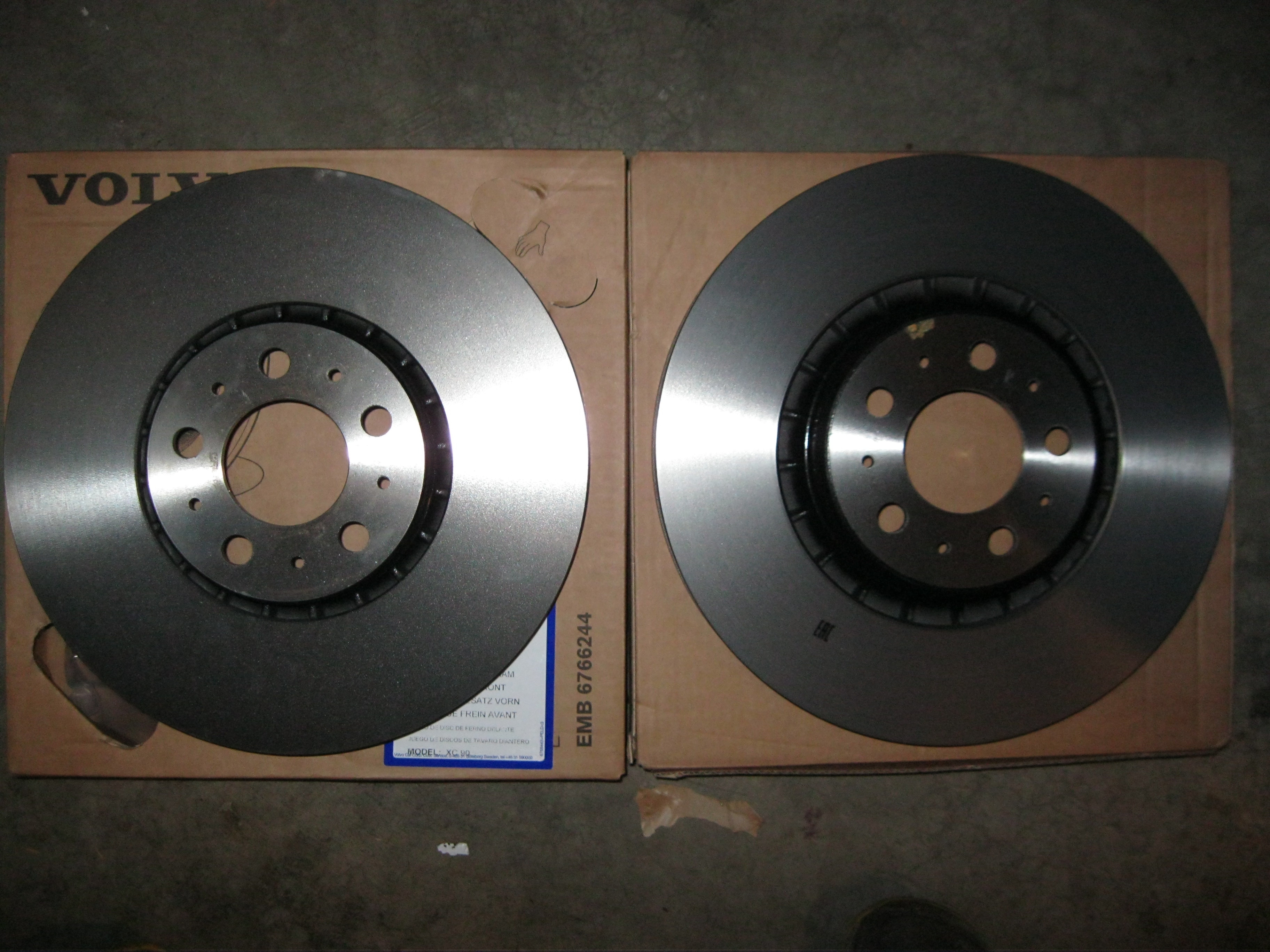

I'm going to add to this.
First photo is a 328mm rotor on the left, a 336mm rotor on the right.

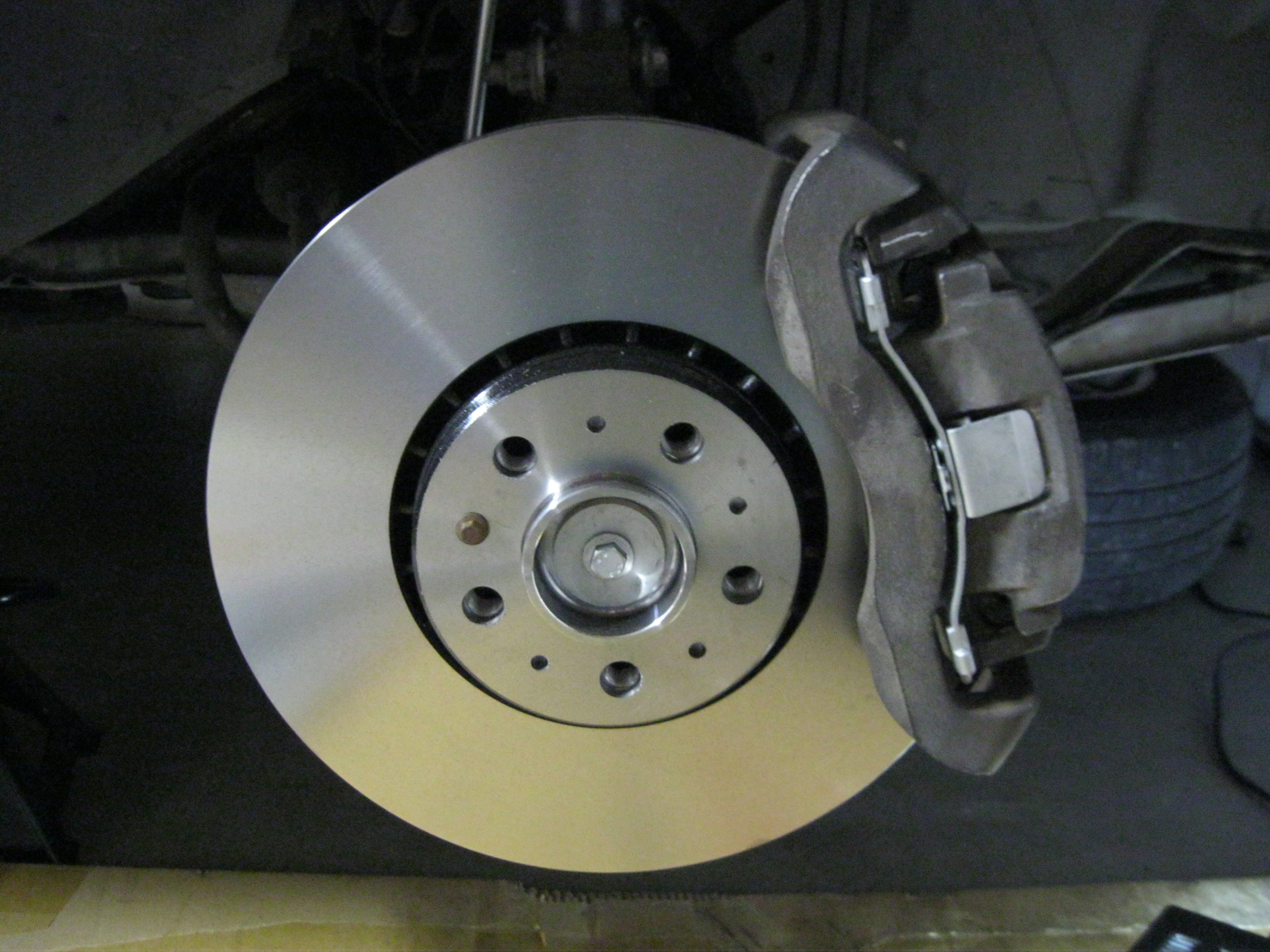

Second photo is what it looks like when you're tired after a long suspension rebuild weekend on your "new to you" '06 Ocean Race and you don't realize until your forum friends point it out that you have a 328 rotor on a 336 calipered vehicle. It's the express reason I have two sets of rotors in the first photo.

BTW, how does one remove the anti-chatter clip on the twin piston caliper? Didn't try to hard to figure it out, but it was not similar to the single piston clips I know well. Is there a "trick"?

Top photo is 316 or 336 for the front, 308 rear. I only have the photo of the 328s as I made a mistake when ordering them (the correct 336 are on the right).
Don't know exactly on the 328 clip but I saw this mention in Swedespeed:
"Insert the screwdriver IN the notch and then twist/pry. It's visually counter-intuitive, but it'll pop out with ease. When I tried to remove it the first time, I fussed with trying to pry off the retainer under the notch, etc. to no avail."

This is accurate. I use a flathead screwdriver in from the center of the wheel and pry and twist it out. The clips rock out of the mounting holes. To replace, simply align them up and I use a hammer to tap them back in place.
