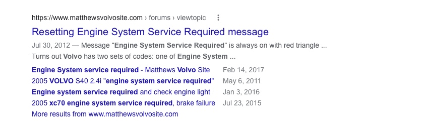

oh....I see this has been asked before many times......sorry!
asked before.jpg (62.8 KiB) Viewed 1315 times
So I'll ask him the mileage. Did it hit a service interval maybe?
