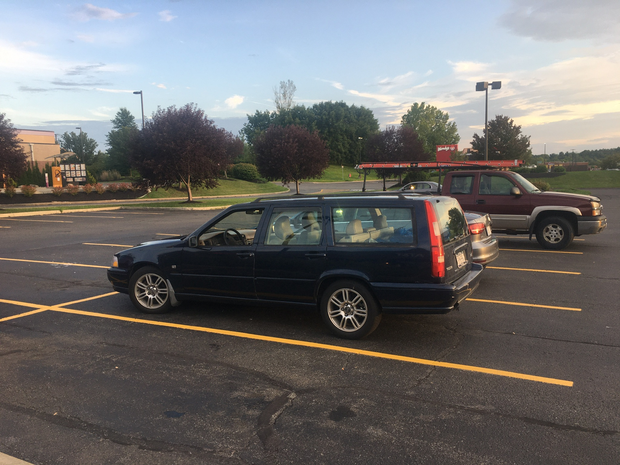

I love the IPD Blue stance, good for 17 vHP additional
