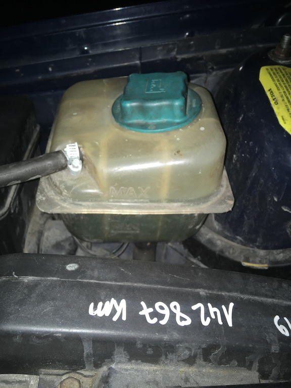

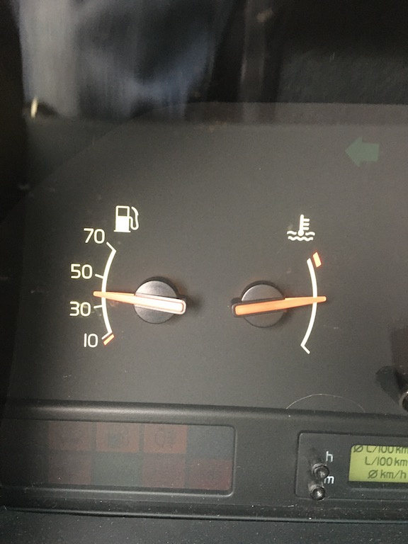

Next new new (final),
So Buddies, at first, i used the car tonight for a small trip. The gauge is always a bit higher than the middle. May be the circuit must be dirty. Does anyone ever used stuff like LiquiMoly for coolant circuit, does it worst it ? I have to test the fan, and its relay, not sure everything is allright over there
The coolant level after have parked the car next to the trip didn't drop (I replaced the pipes better than it was and tightened the clamps a little bit, without forcing anything. This Gran'Ma is delicate...) :
The radiator was dry. I don't worry anymore for the trip to home (but i will have actually a closer look anyway) :

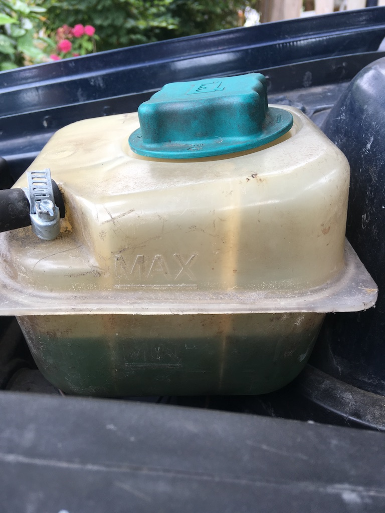

Episode II : The leak strikes again...
So, tonight, while Cat-woman was bringing home my 2 kids, at the moment they arrived to park 850, the light temperature low level started to switch on. After having parked the car, Cat-woman opened the hood and looked to the cool tank, and the level was near the bottom of the reservoir... Damned !
Once for all, i must replace some hoses. And here's my question : In comparison, it costs me less to go through IPD USA and have the parts shipped from them, than to buy them here. Here, the parts sold by Volvo are at Volvo price, the OEM parts sold by individuals or other structures are cheaper, but with shipping costs (for example, a hose 12 euros and 15 euros shipping costs...).
We are walking on our heads here.
So here it is: is there someone on MVS :
- who could order the parts for me via the MVS link, and send them to me?
- to know a supplier of these tubes in Europe?
I want to upgrade my hoses to silicon, but apparently only IPD offers them in black. I'm not interested in the blue ones at all. The funniest thing is that the silicon hoses at IPD are cheaper than here.
I think about Neil's explanation about the radiator leak and the seal issue. I would start by replacing the hoses at first to see if it solves the problem. All hoses are OEM ones (1995)...
Any advice is welcome.

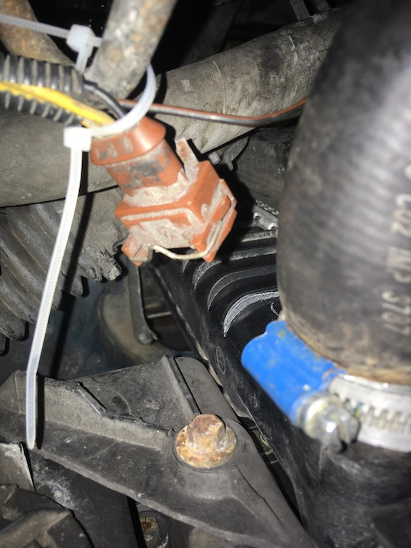

Edit :
Trouble found: thermostatic probe in the pipe that was not tightened properly. Anyway, the hoses were originals onces, to replace them is necessary.
