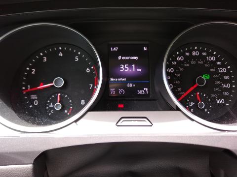

Here is a 20 Tiguan with less than 4,100 miles on factory 0W-20 oil. Can't find many new oils with the latest VW Factory Spec so have to go with the newer L-Moly in 0W-20 from FCP. Never driven the thing hard. One way trip in May from Raleigh to Lynchburg yielded over 37 MPG and a round trip a week ago 35 MPG from a 2.0T motor. Not gut less but not fast either but does glide due to the 8 speed once up to speed. City Avg is about 24 MPG.
The May trip followed a slower moving truck while last week at regular highway speeds.

Hi June!
Standard operating procedure is to reset the MPG on the on-ramp. That way I'm measuring actual highway MPG, not the various city streets to get to it...
I always get to 6th gear ASAP and drive 5 MPH over the limit.
Be careful getting close behind 18 wheelers to draft. They don't like it.
I'm pretty sure VW standardized on Castrol synth for the 1.8 and 2.0 4-cylinders. That's factory for my '17 Alltrack. I don't know the weight. I'm sure it varies by region. I've gotten over 40 MPG many times on an easy drive to Castle Rock and back. Usually an easy highway drive will return 35 MPG without trying.MoVolvos wrote: ↑24 Aug 2021, 08:30 Here is a 20 Tiguan with less than 4,100 miles on factory 0W-20 oil. Can't find many new oils with the latest VW Factory Spec so have to go with the newer L-Moly in 0W-20 from FCP. Never driven the thing hard. One way trip in May from Raleigh to Lynchburg yielded over 37 MPG and a round trip a week ago 35 MPG from a 2.0T motor. Not gut less but not fast either but does glide due to the 8 speed once up to speed. City Avg is about 24 MPG.

Great to know you can get such high MPG. Others have said they obtained over 40MPG. The drive to VA and back has lots of hilly terrain otherwise I think the car is capable.
