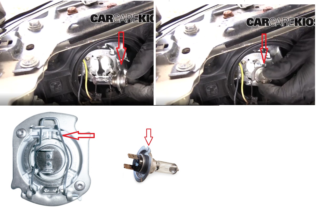

Youtuber "Peppermint" has a nice video for 2001-2004 S60, V70 (Glass type headlight assembly with H7 bulb) here
(For 2005-2009 HL bulb, see the link in video):
Please note that for 2001-2004, the H7 bulb has a tab that needs to point vertically at 12 o'clock position.
You can install it wrong (H7 tab pointing at 6 o'clock etc.), the beam intensity at night will be a bit off, not the end of the world.
But the correct way is the H7 tab points UPWARD...See photo...
