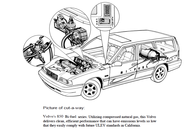

We're about to undertake a like-for-like engine & auto gearbox swap from one 1999 V70 CNG car to an identical CNG car. I think across the pond you were sent a few factory CNG 850s back in the day (see piccy). For this swap, the cars are CNG V70s
