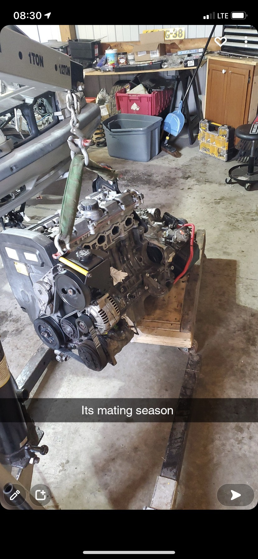

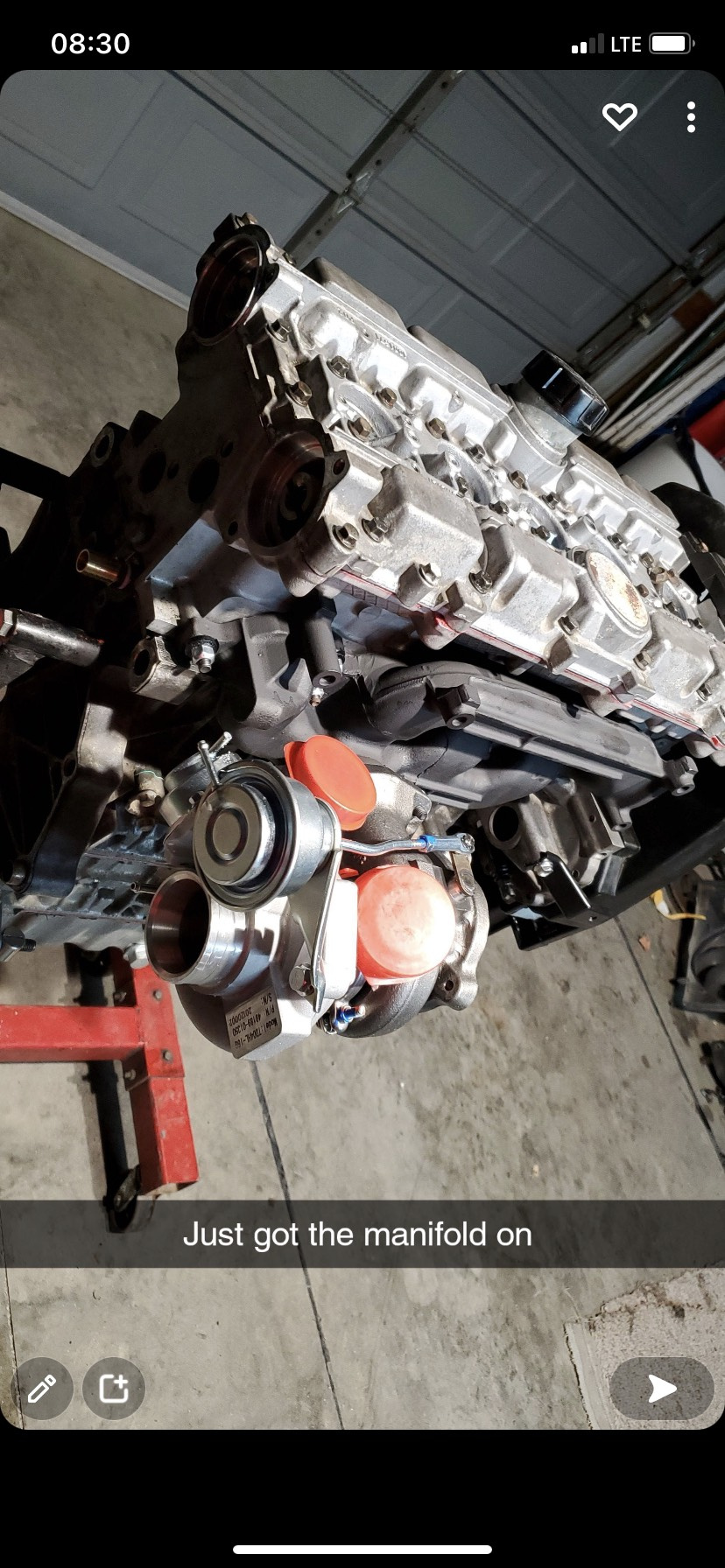

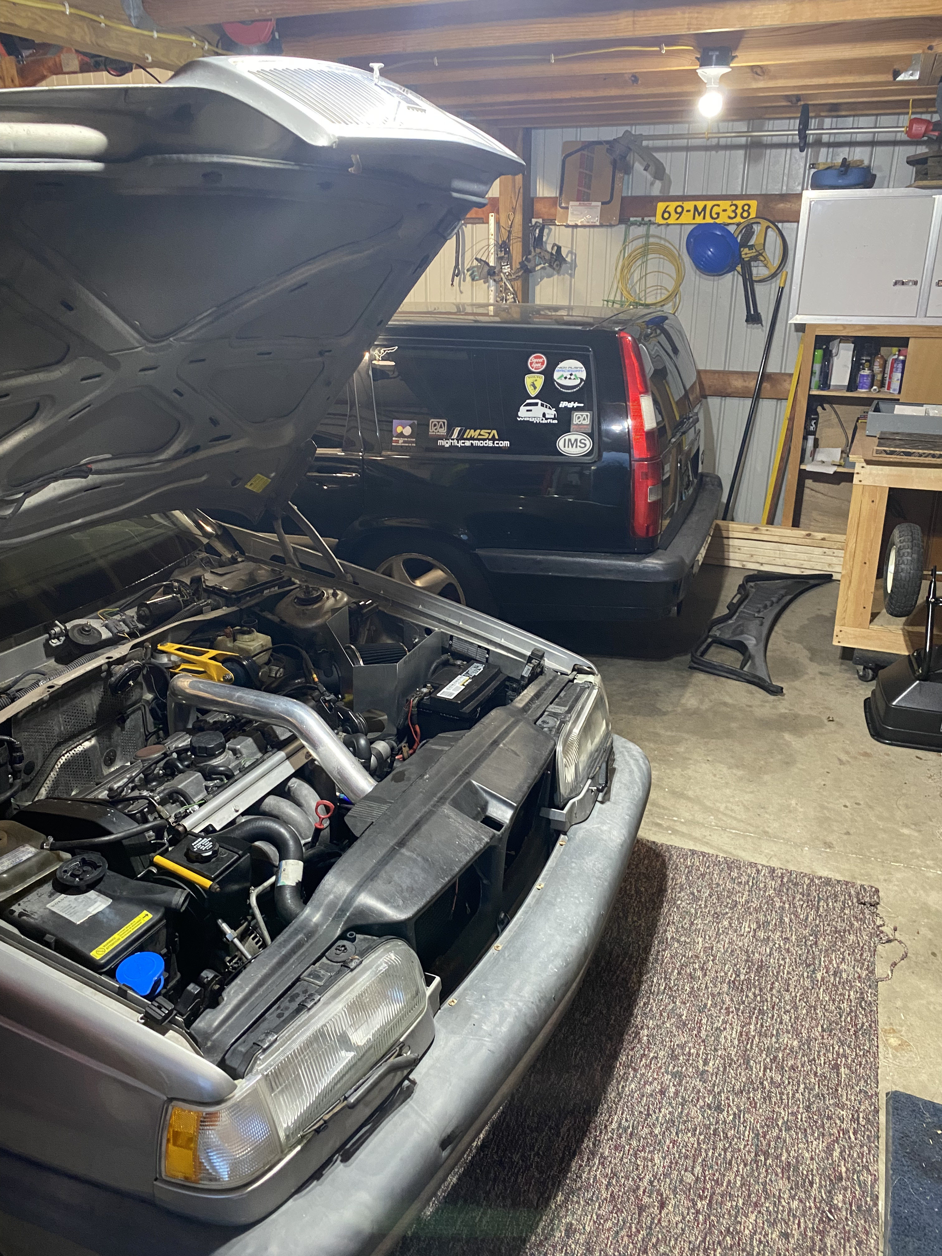

Over the past 6-8 months my dad and i rebuilt a T5 from a 96 850R and put it in my 96 850 Turbo wagon. we went all out with speed parts we had, reverse intercooler kit, ipd turbo control valve, ipd short ram intake, auto trans cooler, etc. We did fresh rings, bearings lifters, valve seals etc. The engine block and head were machined and cleaned. I dissasembled and cleaned the oil pump which all looked good, and put it back together and ran it. I put in fresh 10w30 for the break in and first 70 miles, and it will develop about 70psi when idiling cold. The issue is after it has been running and gotten hot the oil pressure will drop to around 14psi at idle, making the idiot light flicker on and off, driving it will be around 25-30 psi. I then changed the oil for fresh 10w30 for the next 1000 miles, and it is still doing the same thing. I bought the wrong radiator and the oil cooler was on the wrong side so rather than buying a new radiator (i waited too long to return) i enlonged the hoses using some an fittings and some modifications. I was wondering if possibly my low oil pressure issue is because of the extra length, or maybe i have the hoses reversed and they are not flowing correctly, not letting oil to the cooler to cool it off. do you guys have any thoughts? obviously this is very worrying for me and I would like to figure out the issues if i can. Thanks for reading!

I thought about buying the proper radiator, but I'm not swimming in money. I deleted the stock trans cooler with an IPD external one, thus having an unused cooler element on the wrong side. Being outside the return period for the radiator, I used some hydraulic wire reinforced hose we had at work and crimped ends on it. used the hardlines and had a friend tig threaded adaptors on them, then pressure test them for me. all of this cost me a case of beer.
