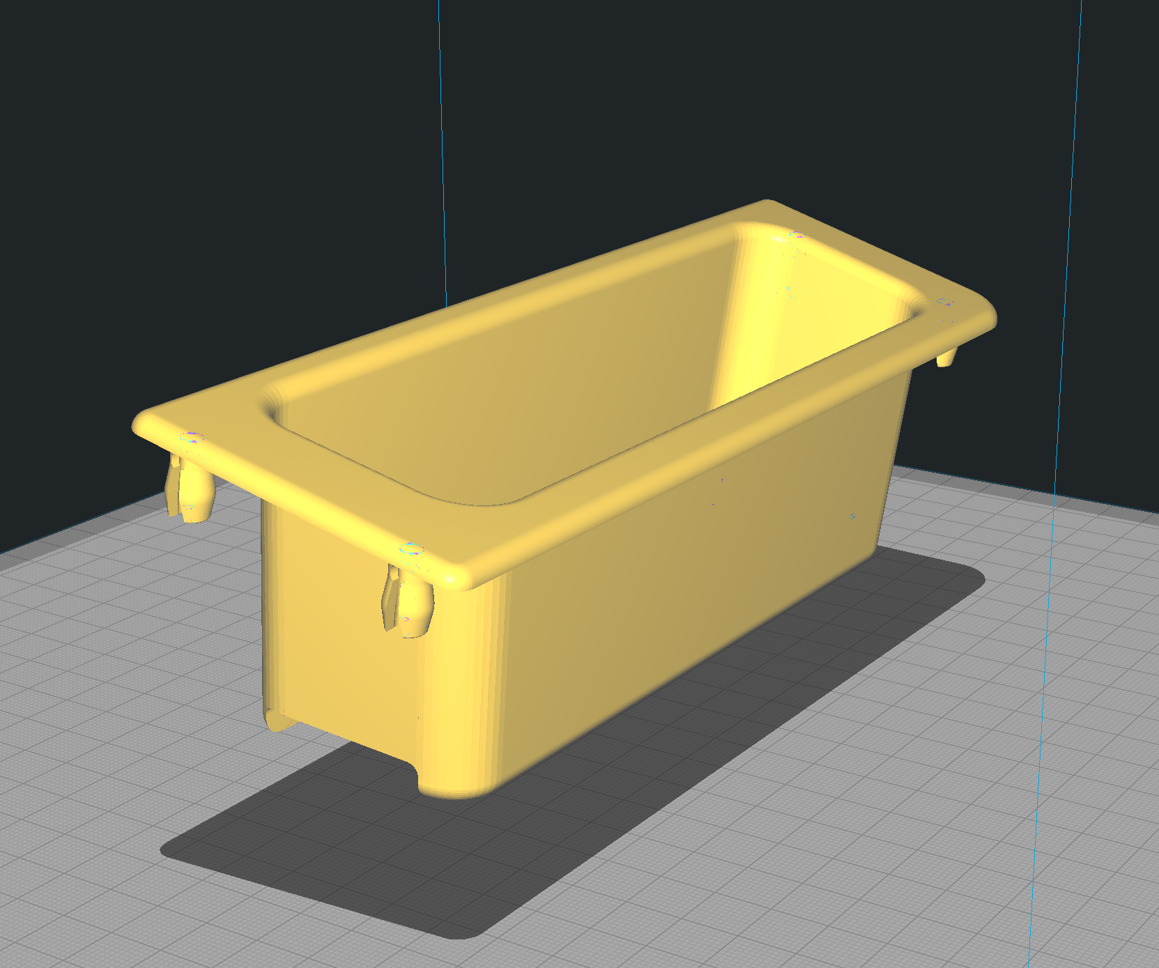

Ive uploaded my first volvo part model. My door latch trim was in pieces. I know these are cheap to buy but I wanted to try making one myself. It worked but I would advise using a UV resistant material such PETG, ASA or ABS. I made the first in PLA and it warped pretty badly and gave off an odd odor.matthew1 wrote: 01 Sep 2021, 19:10Sorry about that. I put those into a group, but didn't make the group "allowed in uploads". I fixed that, so they should go up.ZionXIX wrote: 01 Sep 2021, 15:45 It says invalid file extension on all 3 of those extensions. If I really start modeling more parts, I may have to make an account of thingiverse and just link my projects here. Some of these files can get quite large.

The original skp file is about 6MB and the stl export is 15MB. Not too bad but these are small models. If Im able to achieve a dashboard design I would estimate a few hundred MB. The uploads seem to be working.

Even if these grow by a magnitude it's not a problem. Thanks for these examples.
Good work on the models. I did some in the 90s, and I know how much time and effort it takes.

ZionXIX - what software tools did you use to make that shape?

I used Google sketchup to model the part. I exported to cura for slicing before sending to the printer. I basically took all the measurements with a caliper and modeled it out one line at a time.BlackBart wrote: 02 Sep 2021, 10:47 Can someone explain to a layman the idea of 3D printing steel / aluminum car parts? I can see printing the shape in a resin, which becomes the master for a mold, where you then cast a metal part. But many have to be high strength, or even forged, to do their job.
