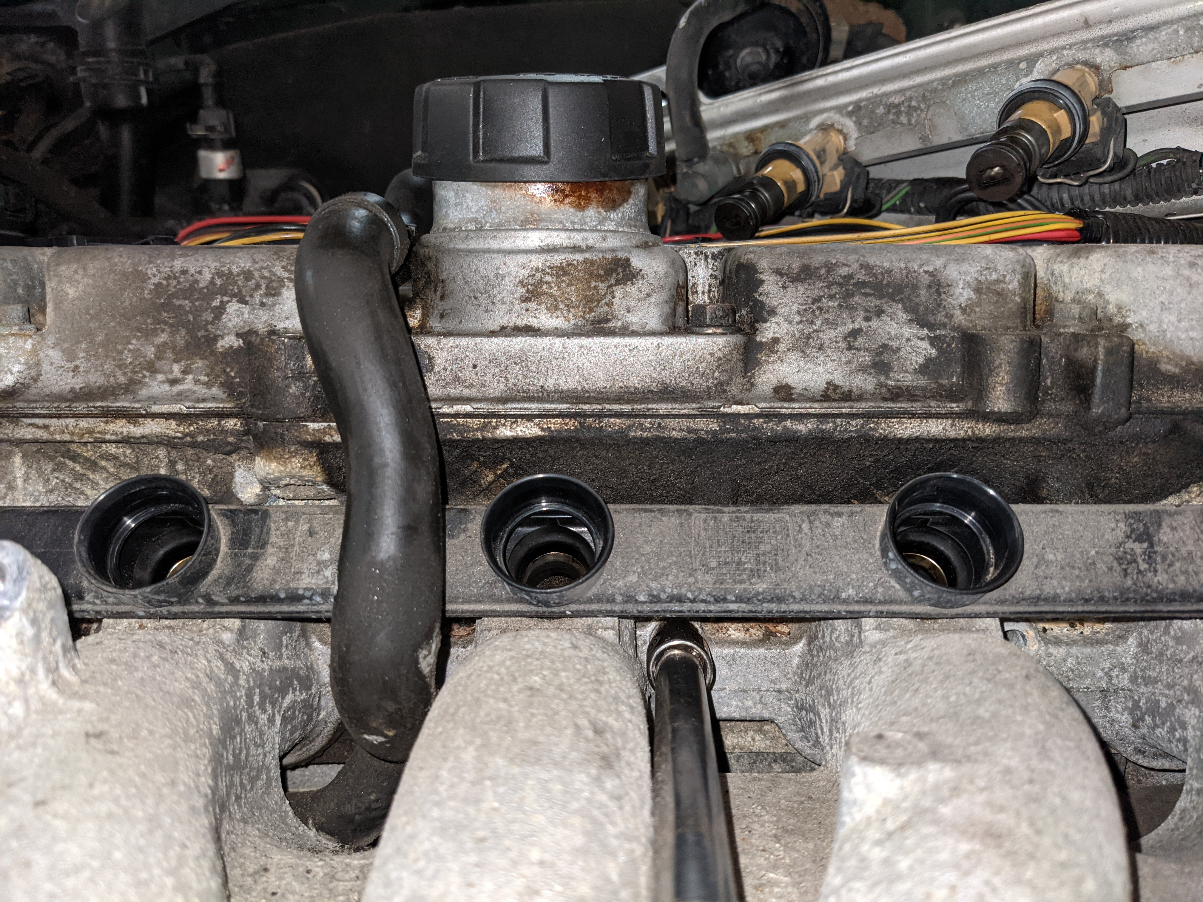

How do I remove the plastic fuel injector fume rail from the intake manifold (black horizontal piece with holes in the pic)? One post said it "pops right off", but all the moderate pulling and prying I tried didn't budge it. I assume that I need this off before sending the manifold to the solvent bath. Thanks.

Mine doesn't have that piece added, but I'd think that when you remove your intake it should become obvious how that piece comes off. If it's not attached with a nut, bolt or clip then it just pulls off like the fuel rail.

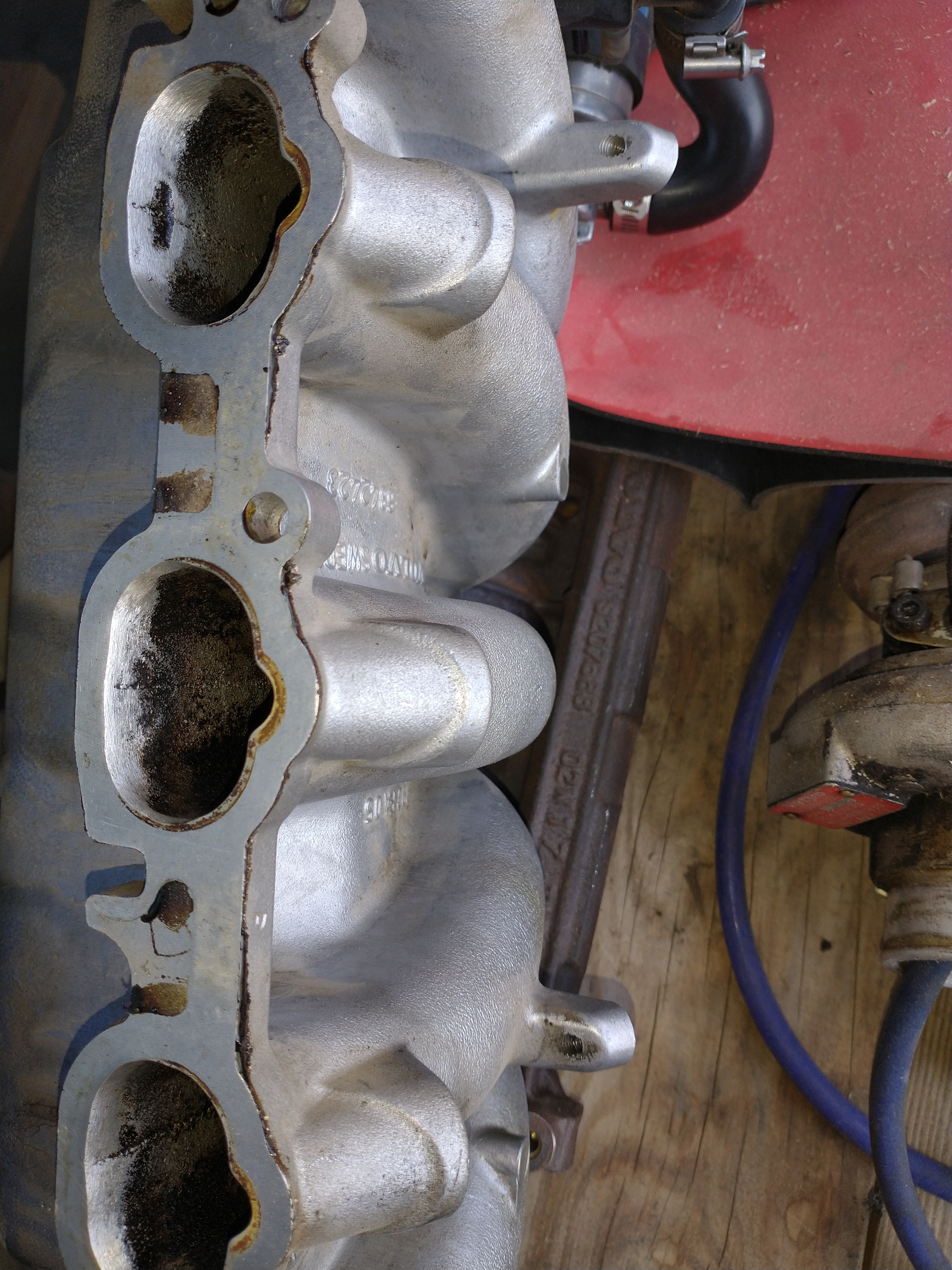

Here is a pic of mine after I recently removed it. Not perfect but I think ok.

Looks like the Seafoam cleaned the loose, wet buildup from the interior of yours. Thanks for the tip.
And how did you get that exterior so clean? My entire engine is dry and white, not shiny and silver like that.
