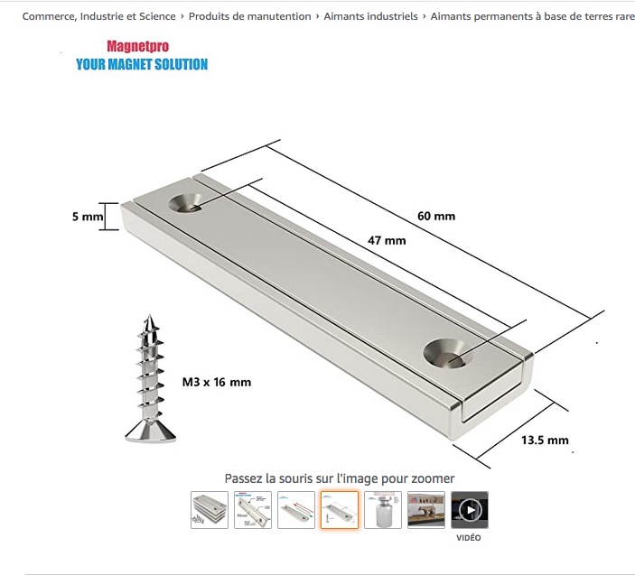

The slides work very well, I cleaned and re-greased them, but the latches that act as brakes are worn. How would you go about locking these drawers while handling the beast? I was thinking of straps (not great in terms of support), or a long magnetic bar placed on each side vertically, which I could remove and fix on the sides after handling the cart.
I specify that I don't have anything to weld, otherwise, I would have welded a screw at the top and one at the bottom, and I would have put a flat iron.
Install these parts in the slides ?
