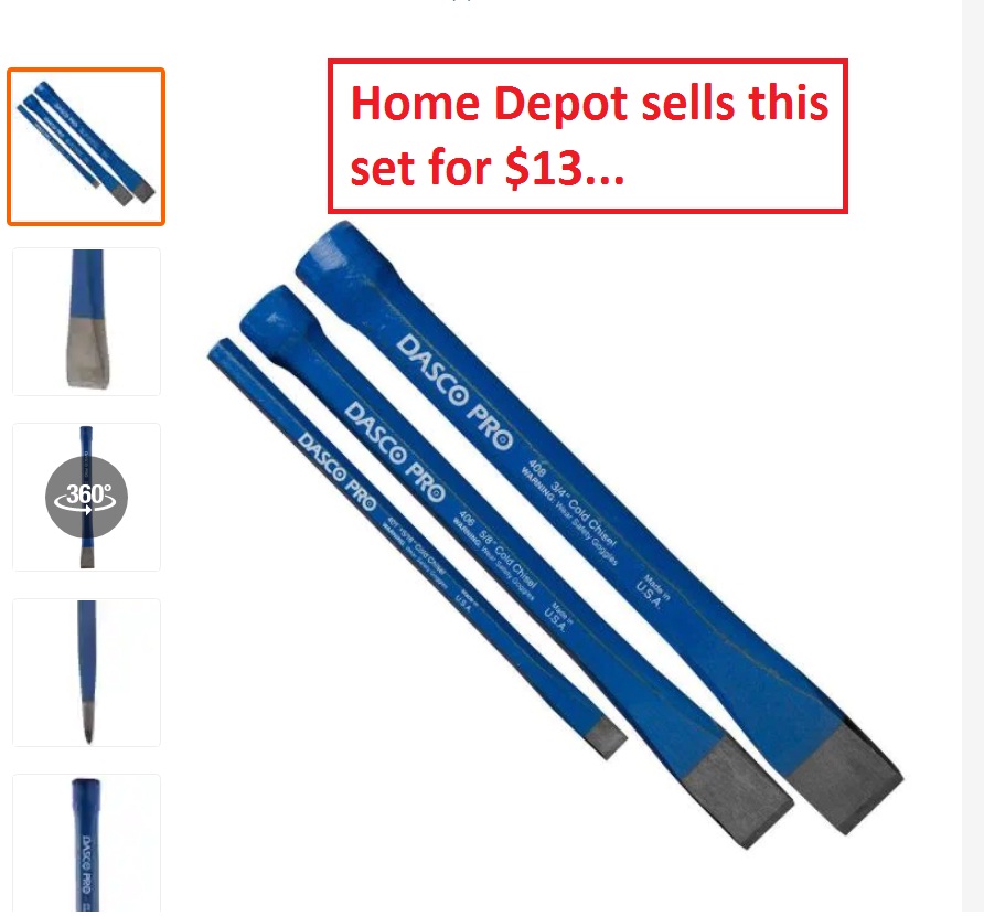

This is the set I used. Home Depot sells it for $13, I used the largest cold chisel in this set bc it had the correct thickness to wedge in between the trans and the tripod.
As mentioned above, I used cardboard on both sides of the cold chisel to protect the trans and tripod.
Just rotate, gentle tap with hammer, and rotate until the C-clip open end facing downward...
