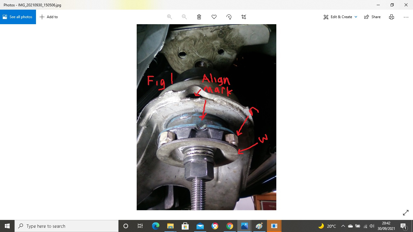

Thanks for the suggestions, ive got three done and doing the third oval shaped one, the bushings are marked "00" year 2000 original bushings and they still have life left in them.
I broke 2 drill bits and bend the large washer using fig 1 setup, the pressing force was too much on the washer just using a bolt. fig 2 setup proved much better and no bent washer
figure 1
figure 1
figure 2
figure 2
figure 2.jpg (157.77 KiB) Viewed 3378 times
subframe bushing install
bushing install.jpg (123.85 KiB) Viewed 3378 times
