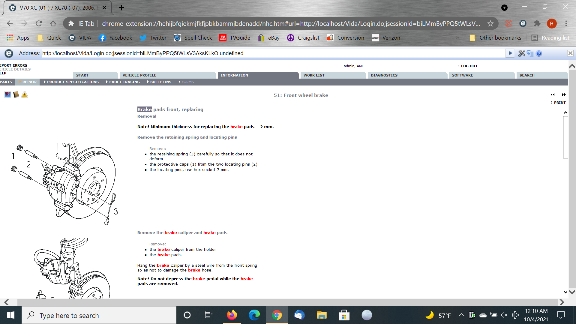

Is the brake pad retaining spring intact?
A broken spring was the source of a grinding noise on my C70. Let the brake pads ride on the rotor.
See #3.
See #3.

@ RickHaleParker, yes the springs where in place, verified when removing the brake calipers.
