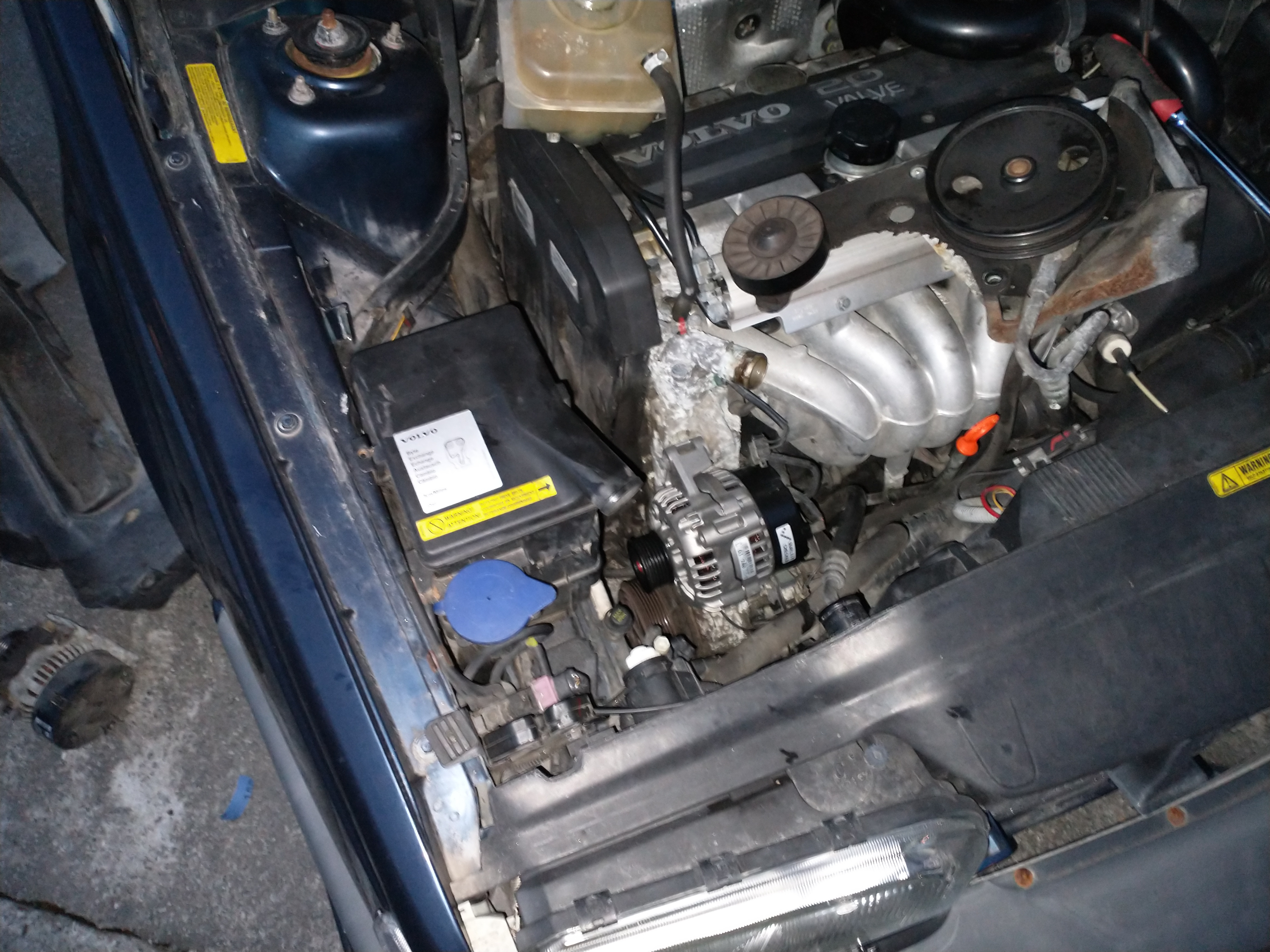

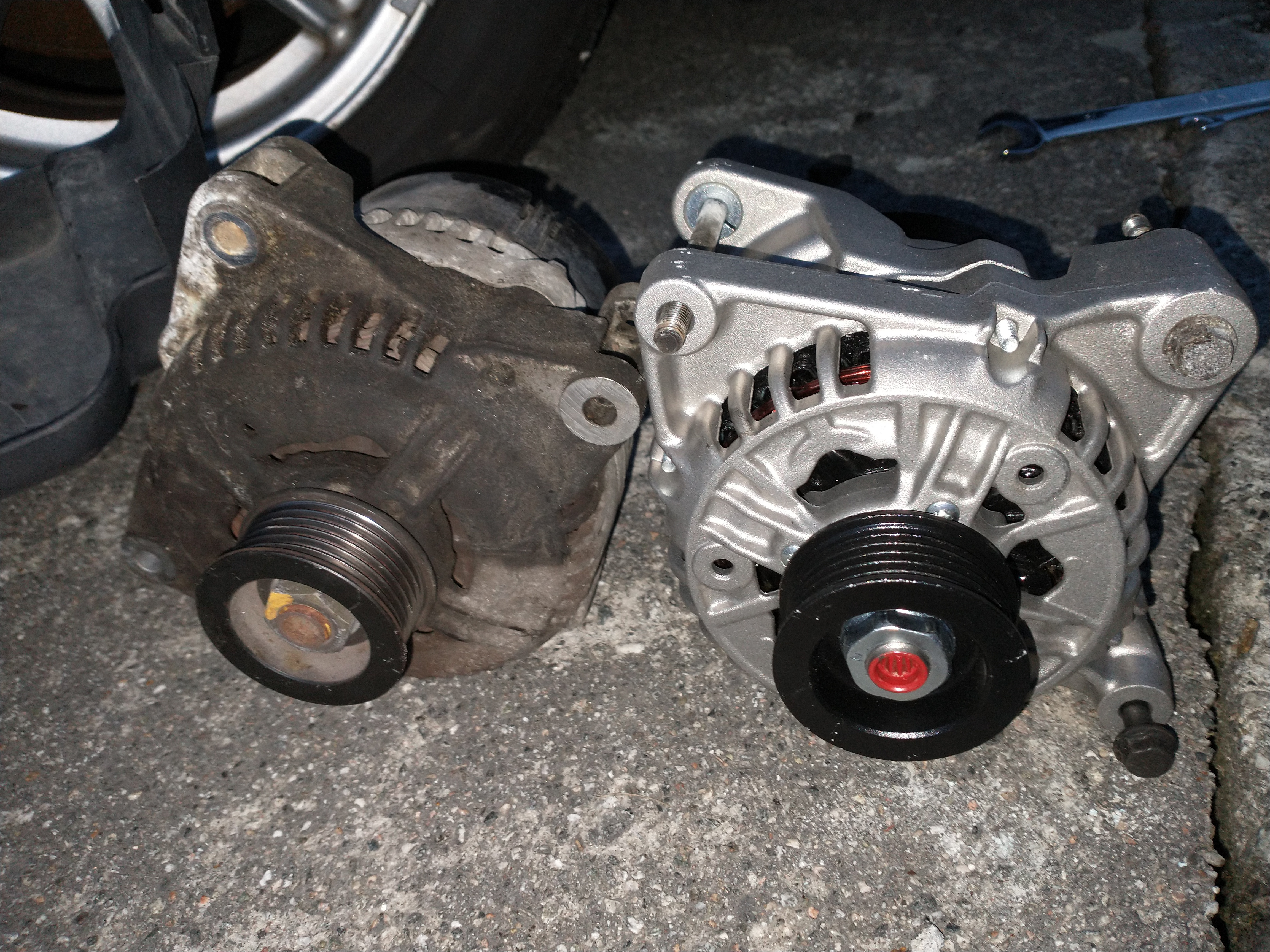

Replaced the alternator on my 850 last weekend. Man, what a job. Supposed to be super easy, "just undo these bolts" according to the Haynes book. Nope! Tight spaces, hard to reach, but it was done eventually. I was able to do it without touching the oil level dipstick, but managed to get one of the power steering lines in front of the dipstick tube. Oops. Was able to push the tube over to the correct side, near the intake manifolds.

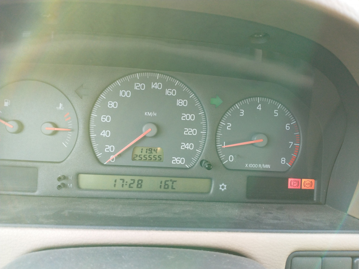

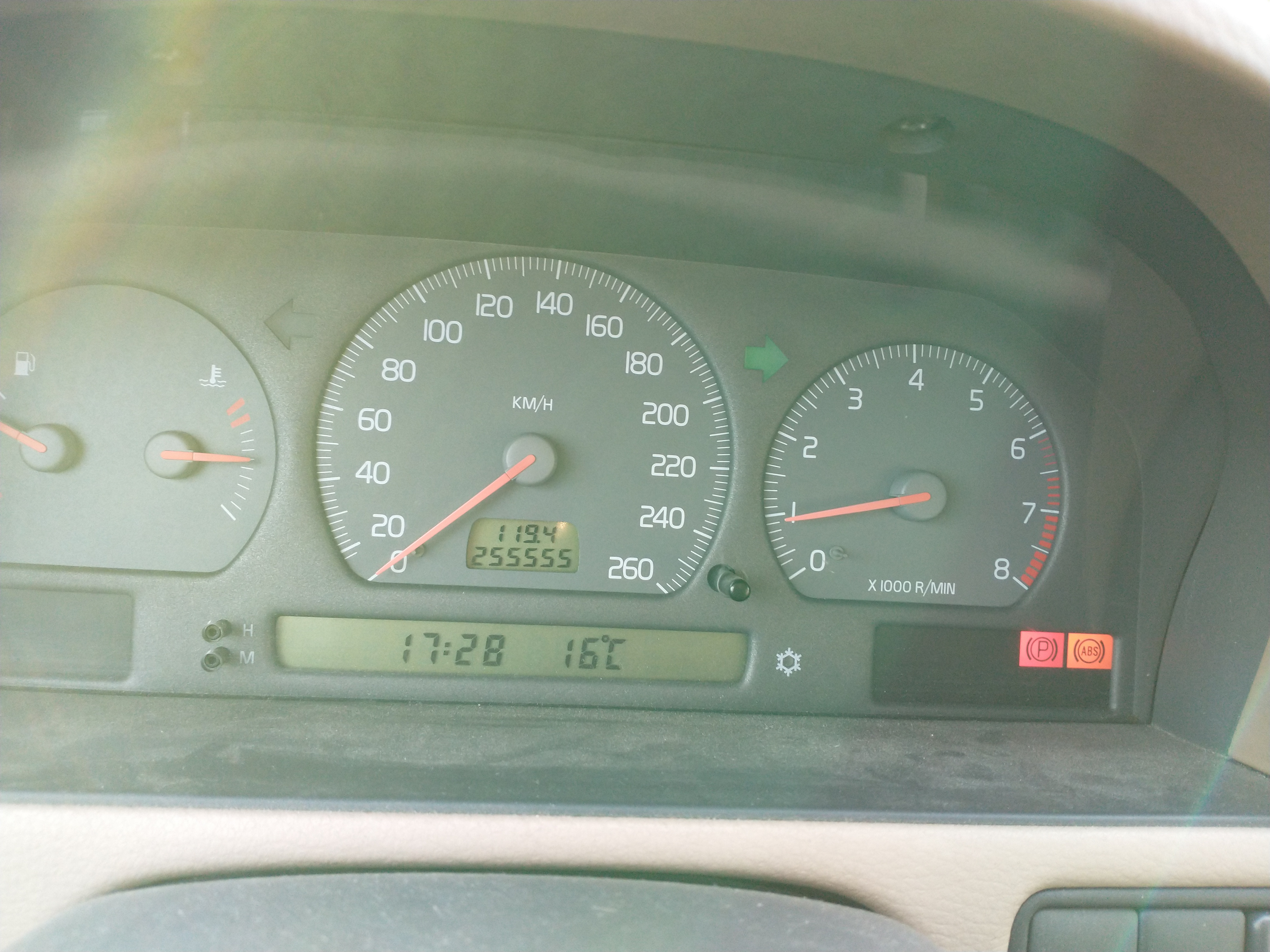

Later this week, I replaced the thermostat on my black S70. Used to have a Biltema thermostat since last years timing belt job, but it has only been a pain. Coolant temperature needle has always been below, wishy washy, and it might be because that Biltema thermostat has a small open hole.
The new Volvo OEM thermostat is bang on, locked at 3'o clock. Feels like she runs better now, sounds better. Also hit 255'555 kilometers. Still have that ABS light on my todo list. Going to have the dealer take a look at it, and see if it is the module, or simply a bad sensor.
