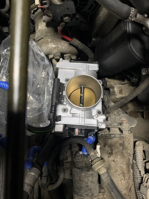

Throttle Body.JPG (134.53 KiB) Viewed 1249 times
I am about to put back the exhaust manifold with the throttle body on it. Just got this unit two years ago this month and it has made a huge difference in the car. Now, do I have to clean it? A can of throttle body cleaner is about six bucks, just for a few puffs. Break cleaner won't be a good alternative, would it?

Throttle body cleaner can be used for many parts cleaning chores. Also good starting fluid for small lawn engines. It will be empty before you know it.

volvolugnut wrote: 11 Oct 2021, 18:21 Throttle body cleaner can be used for many parts cleaning chores. Also good starting fluid for small lawn engines. It will be empty before you know it.
I'll grab me a can. Would be nice to clean the Throttle Body if I took it out and putting it back with a new seal.
Replacing the TB was like night and day driving the XC.
Thanks

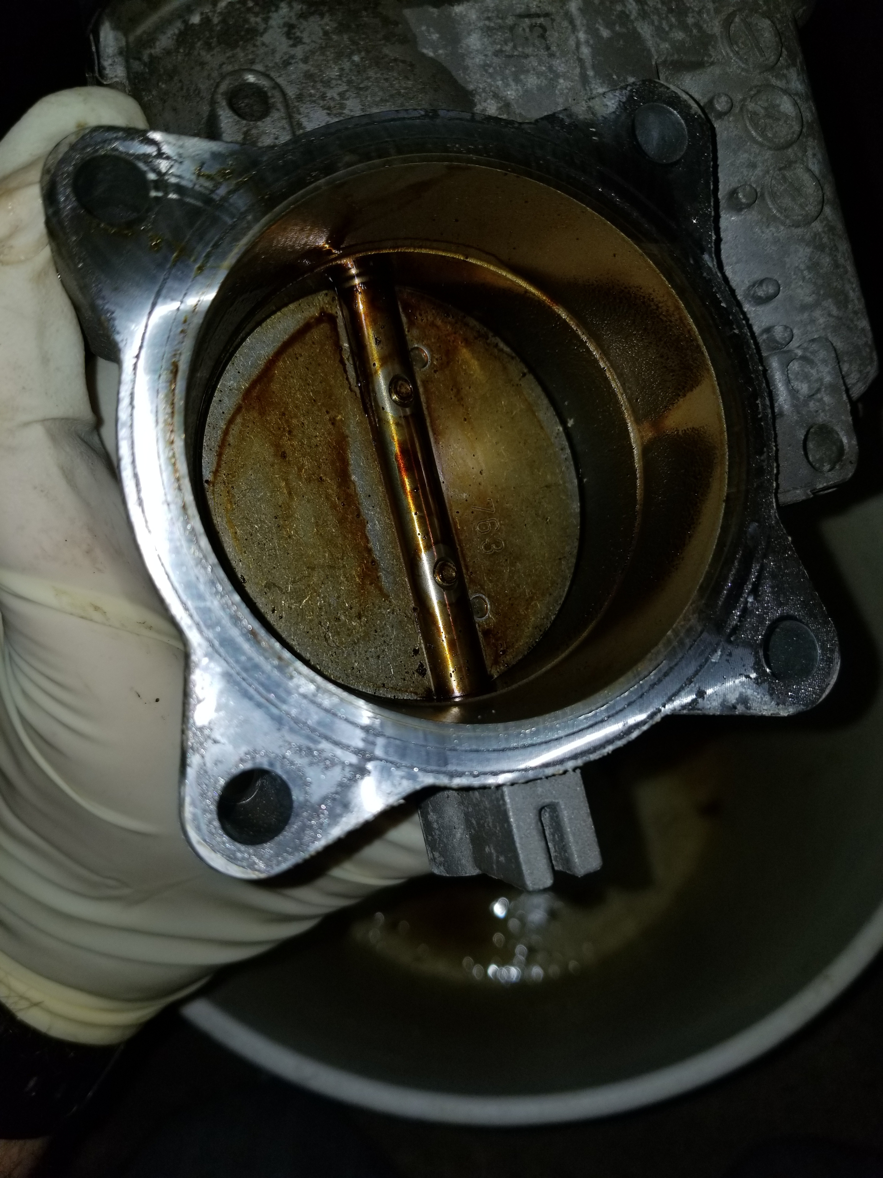

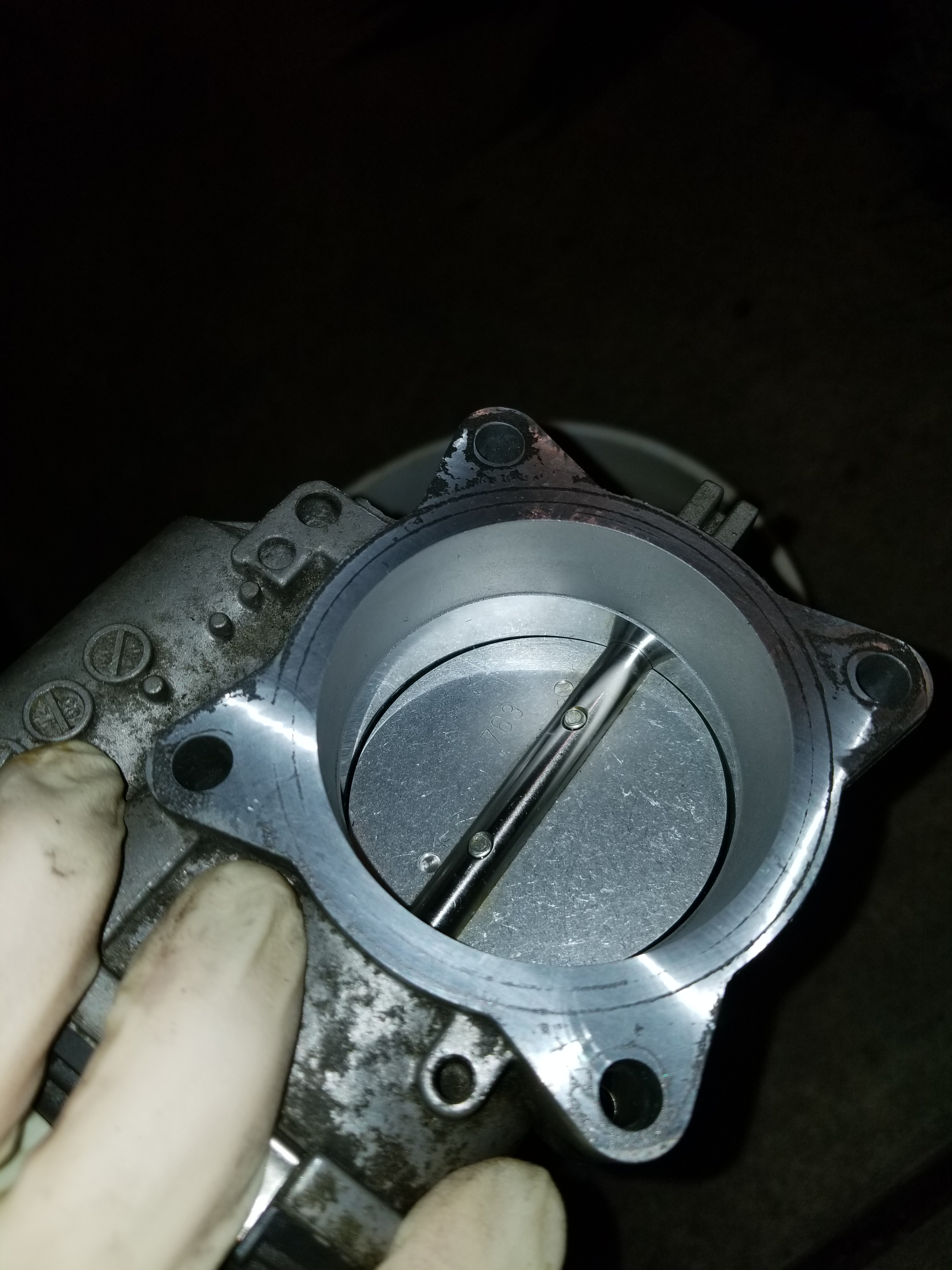

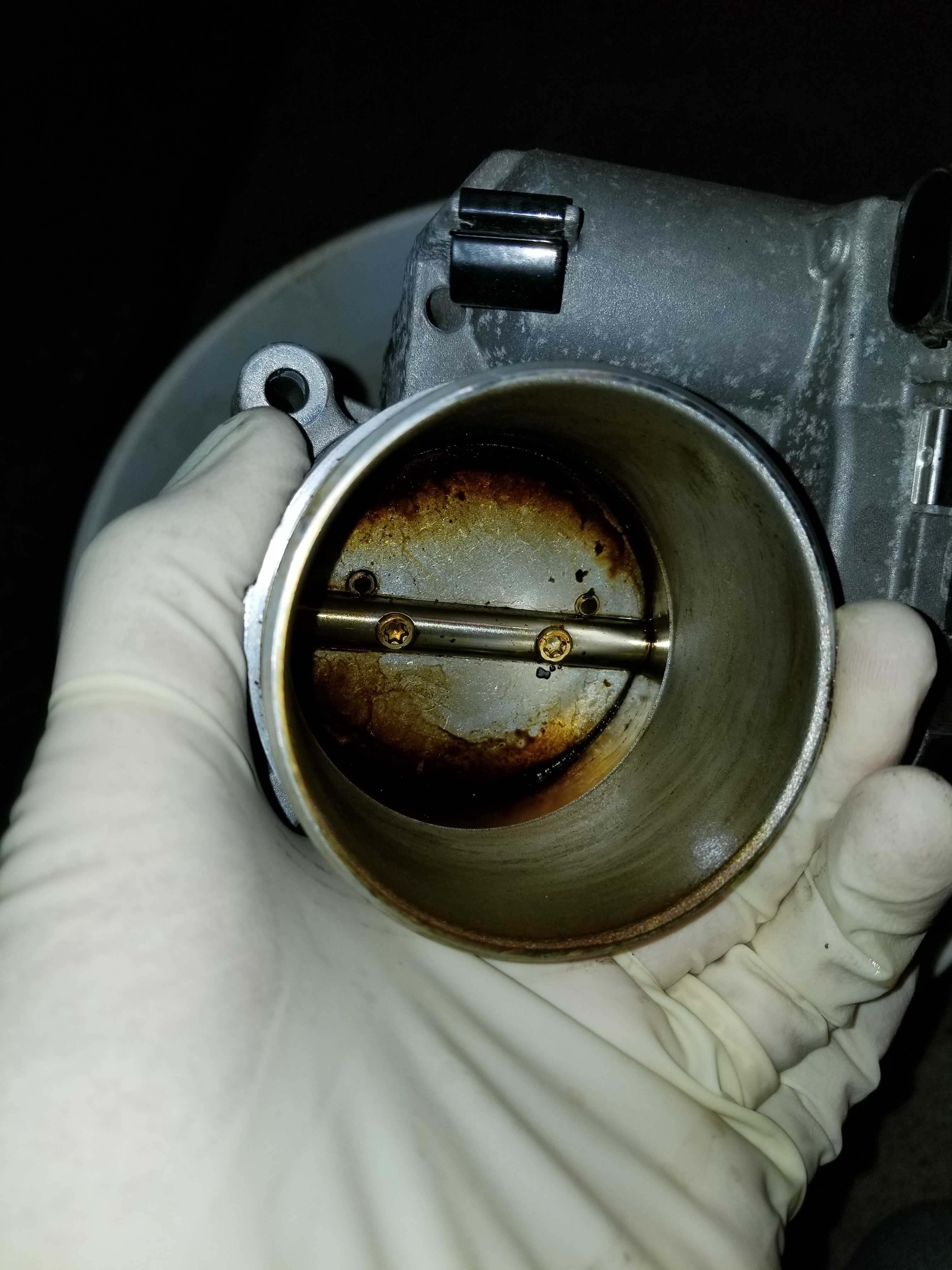

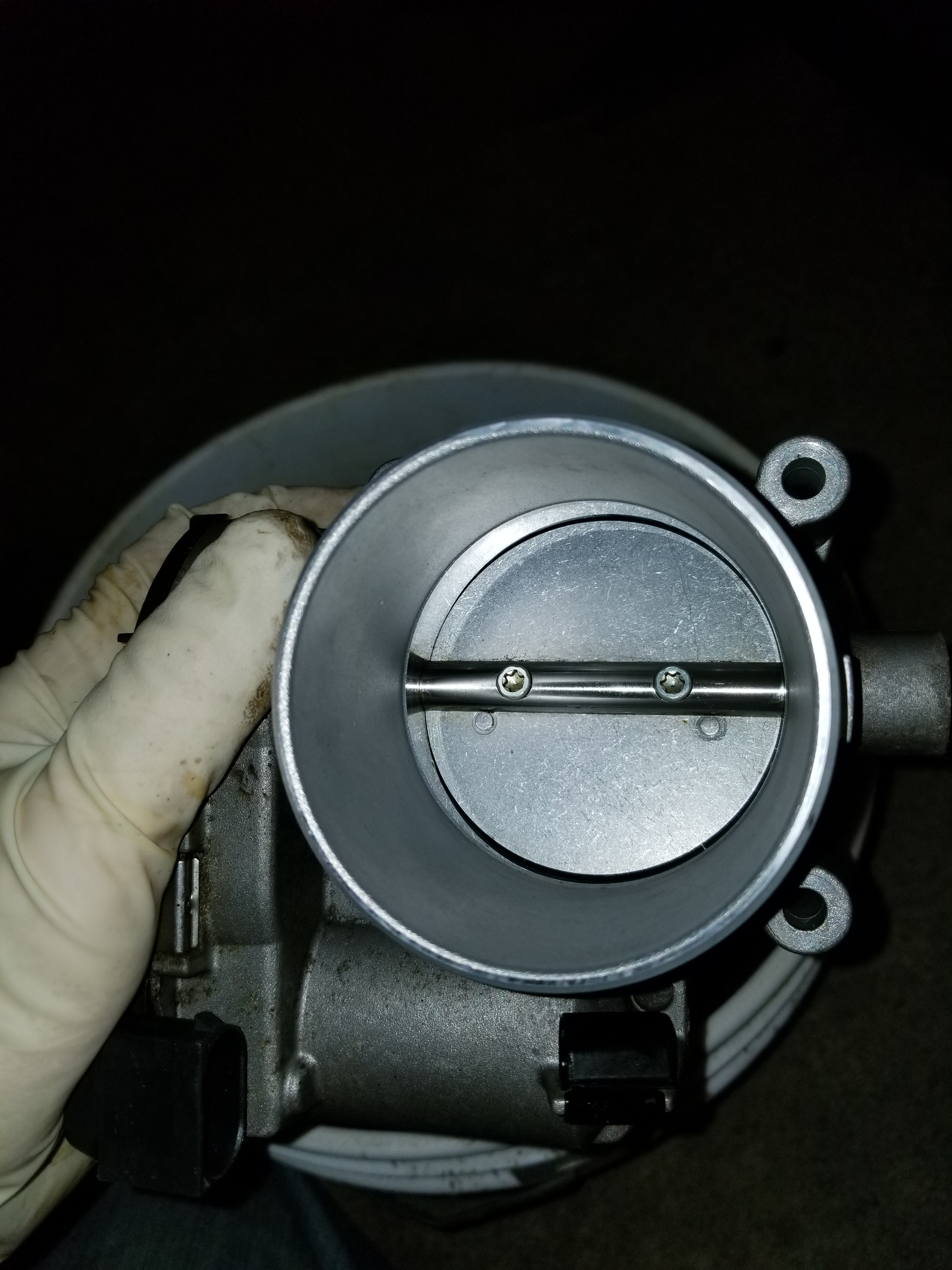

justanotherhumanoid
Posts: 72
Joined: 07 Sep 2018, 01:19
Year and Model: 2006 S60
Location: San Diego
Has thanked: 7 times
Been thanked: 17 times
Post by justanotherhumanoid »
The main reason to use a Throttle Body or plastic-and-sensor-safe cleaning product is that you don't want to inadvertently damage anything as you're spraying it around. I would say specifically don't use brake cleaner, instead use a cleaner specifically for throttle bodies, that notes it is safe for plastic/sensors, or a MAF sensor cleaner.
I don't recall the manufacturer, but I used the "throttle body cleaner" sold at autozone when I cleaned mine. Worked well, and no issues ~13k later:
2006 S60 2.5T AWD - Build Log
do88 intercooler, all aluminum radiator, XC90 aux transmission cooler, magnefine ATF filter, Snabb intake elbow & throttle body pipes, custom oval exhaust, rebuilt 16T swap, 17x8" team dynamics pro race 1.2 wheels, ipd sway bars, R brake swap, Hilton tune, sunroof shade that slides open when I step on the gas and closes when I stand on the brakes.
Posts: 36154
Joined: 17 Feb 2013, 17:54
Has thanked: 1610 times
Been thanked: 4071 times
Beautiful. It’s so tempting to just hose those down with the spray but the correct technique is to wet shop towel or hardy paper and wipe.
This stops the solvent from getting into the sides , important with electronic throttle bodies
