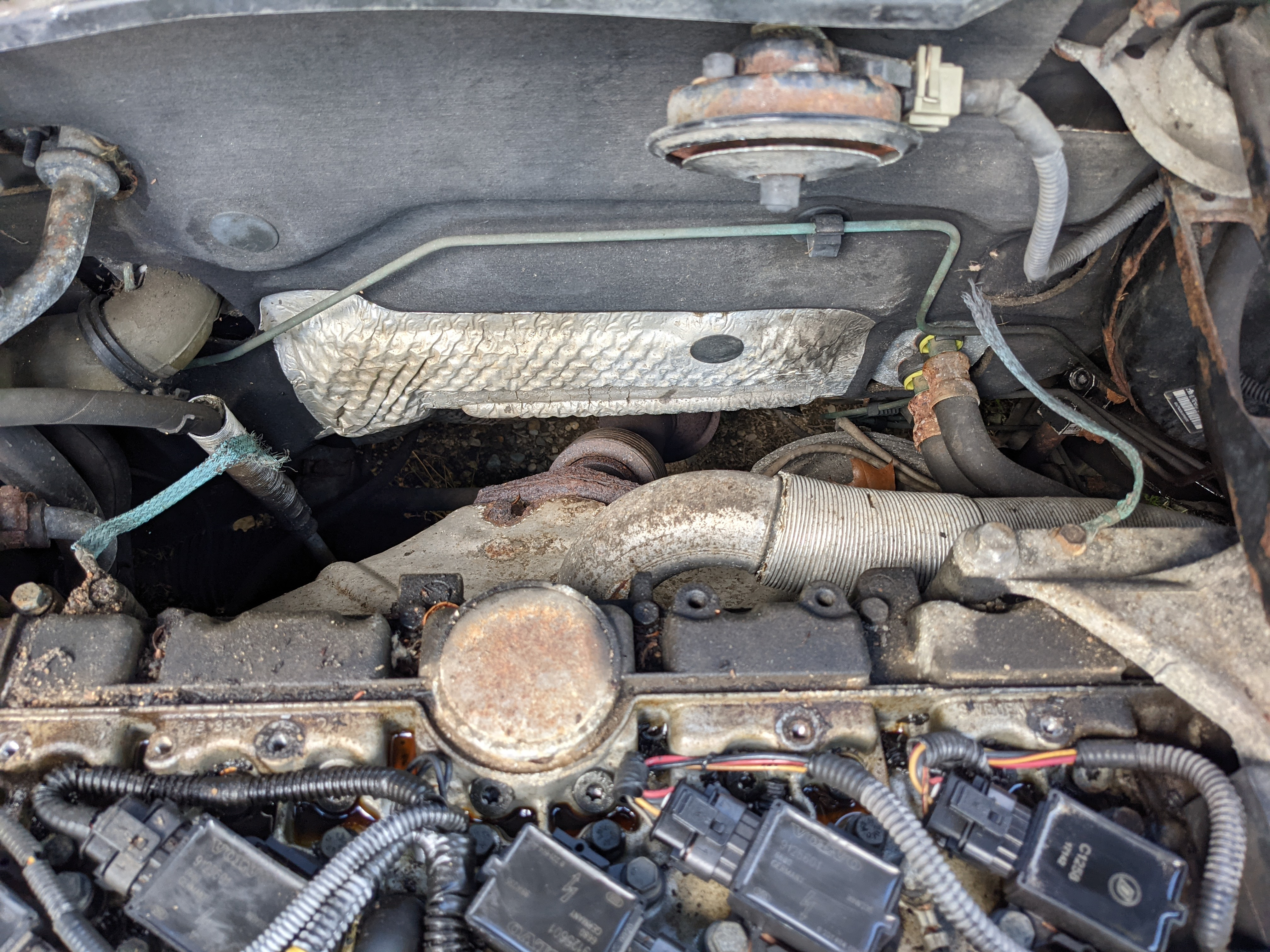

When you turn the key to crank, do you hear a click? As I recall, that's either the starter or a relay to trigger the starter. If you have no crank and no click, then you may have bad grounding straps between the engine and the car body. There are two at the rear of the engine, one at each corner. They may look green from copper corrosion. The driver's side one attaches pretty high on the firewall, the passenger's side one attaches low and out of sight.
The attached picture is what you don't want to see, both straps broken. The failure may be more subtle. On my 2000 V70, the car started early one day and failed to start later that day. The straps looked fine, but were actually very brittle from being corroded.

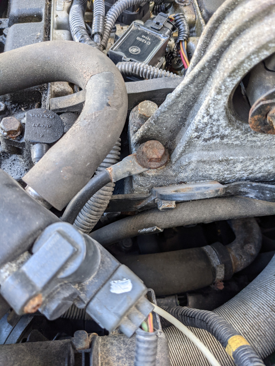

Since I haven't gotten around to manufacturing grounding straps and offering them here, you can easily make your own. The second attached picture shows a heavy gauge wire bolted to any old engine point, running directly to the battery. This engine starts fine with this solution.
