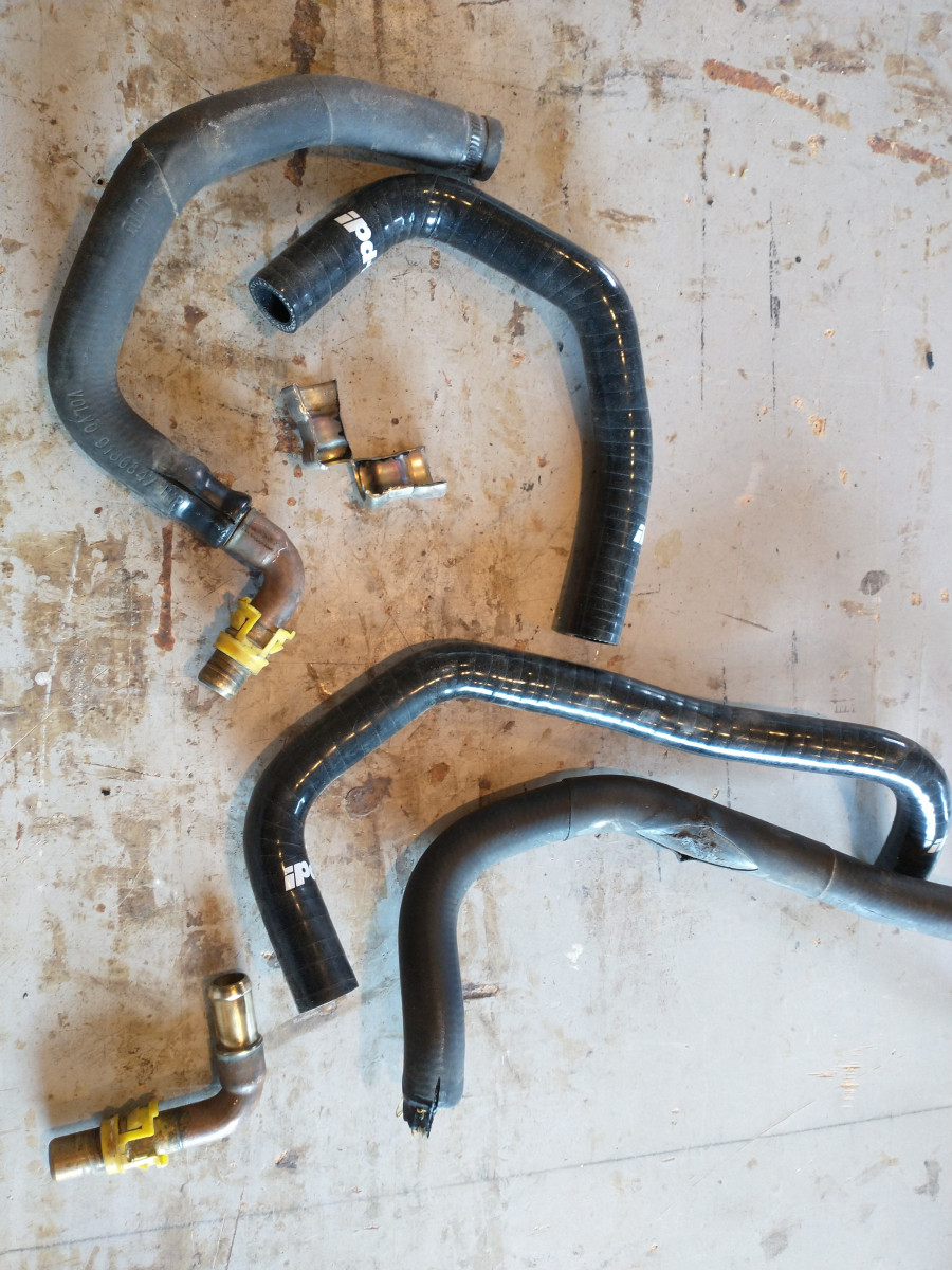

Replaced heater hoses with IPD silicone ones.

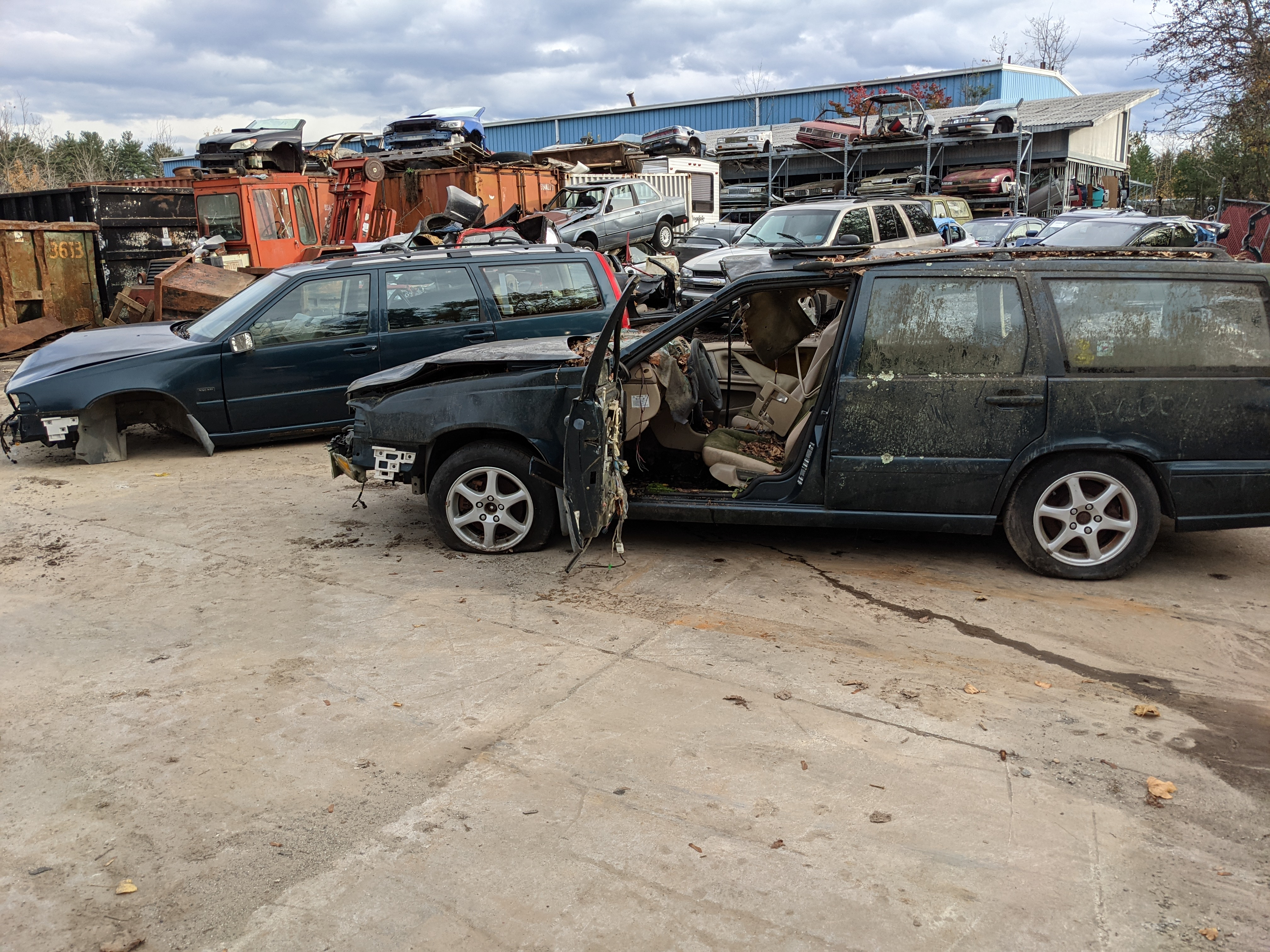

It was P80 day at the junkyard today. Along with these wagons was an S70 and the wagon I was picking parts from. The owner was scrapping the one I used, so maybe he decided to scrap these others too.

Don’t forget to grab those roofrails,

Are rails a thing we should take from junkyards?
The rails on the left blue V70 looked like they were from a P2 XC70 with that rough texture. Geronimo the 2000 V70 also has these seemingly P2 rails. The rails on the right wagon were smooth P80 rails but crushed.

Good ones sell easily for $100 and they take about 10 minutes to remove

How difficult was it to swap the fittings?

Really easy with a die grinder (aka big boys Dremel). Just carefully cut the collar on two sides and pried it off.
Getting the rest of the hose off was surprisingly hard. Razor knife and wire wheel helped. Less than an hour overall.
