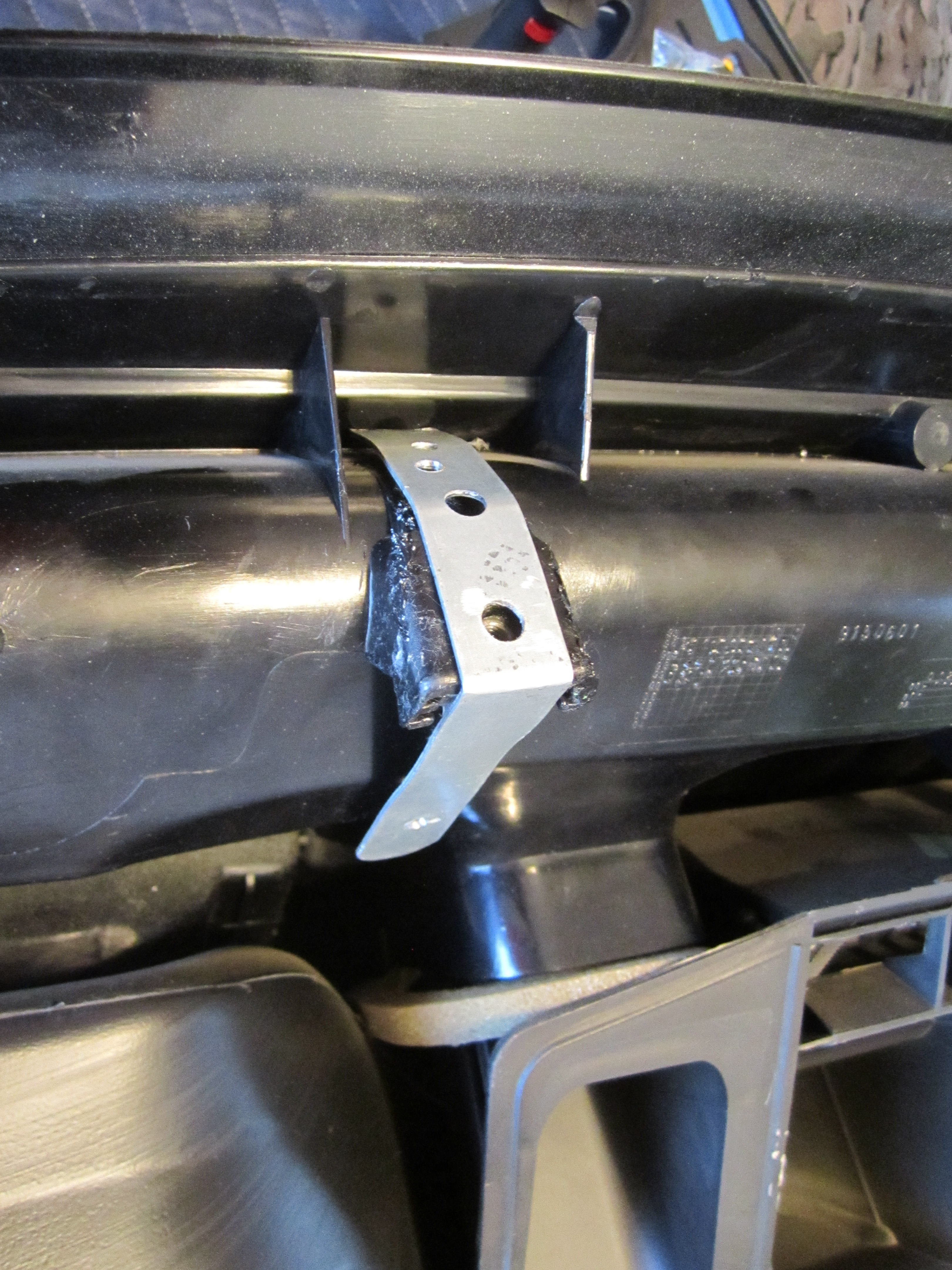

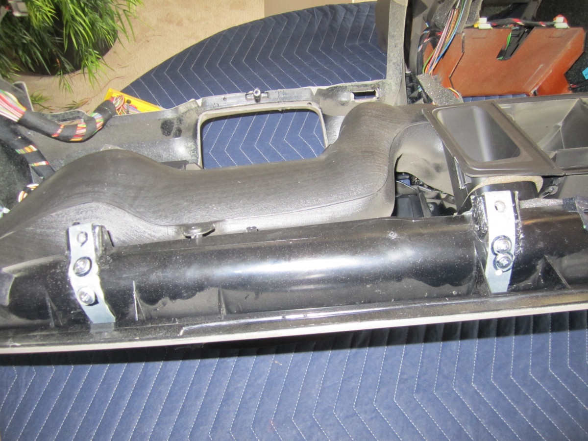

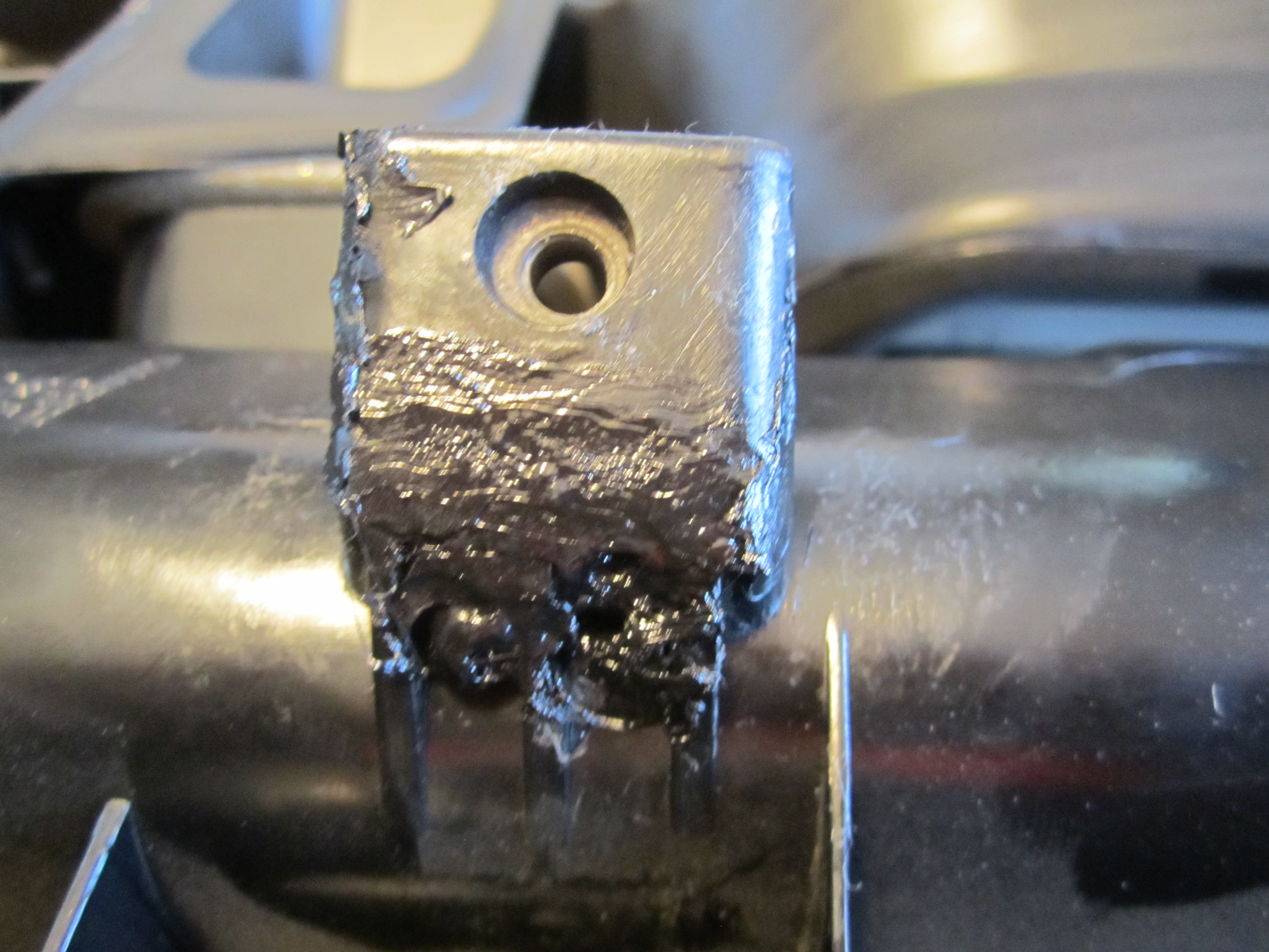

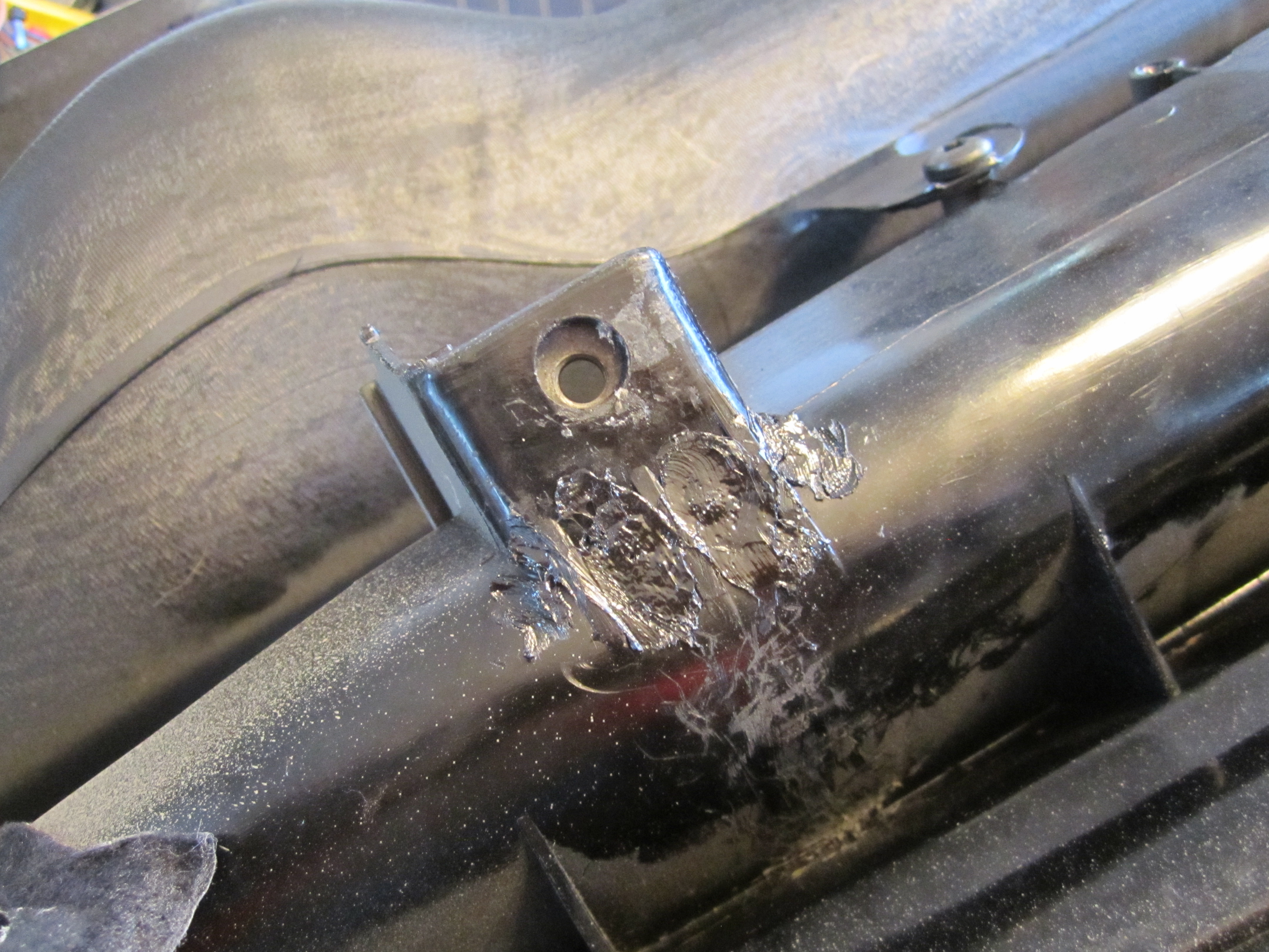

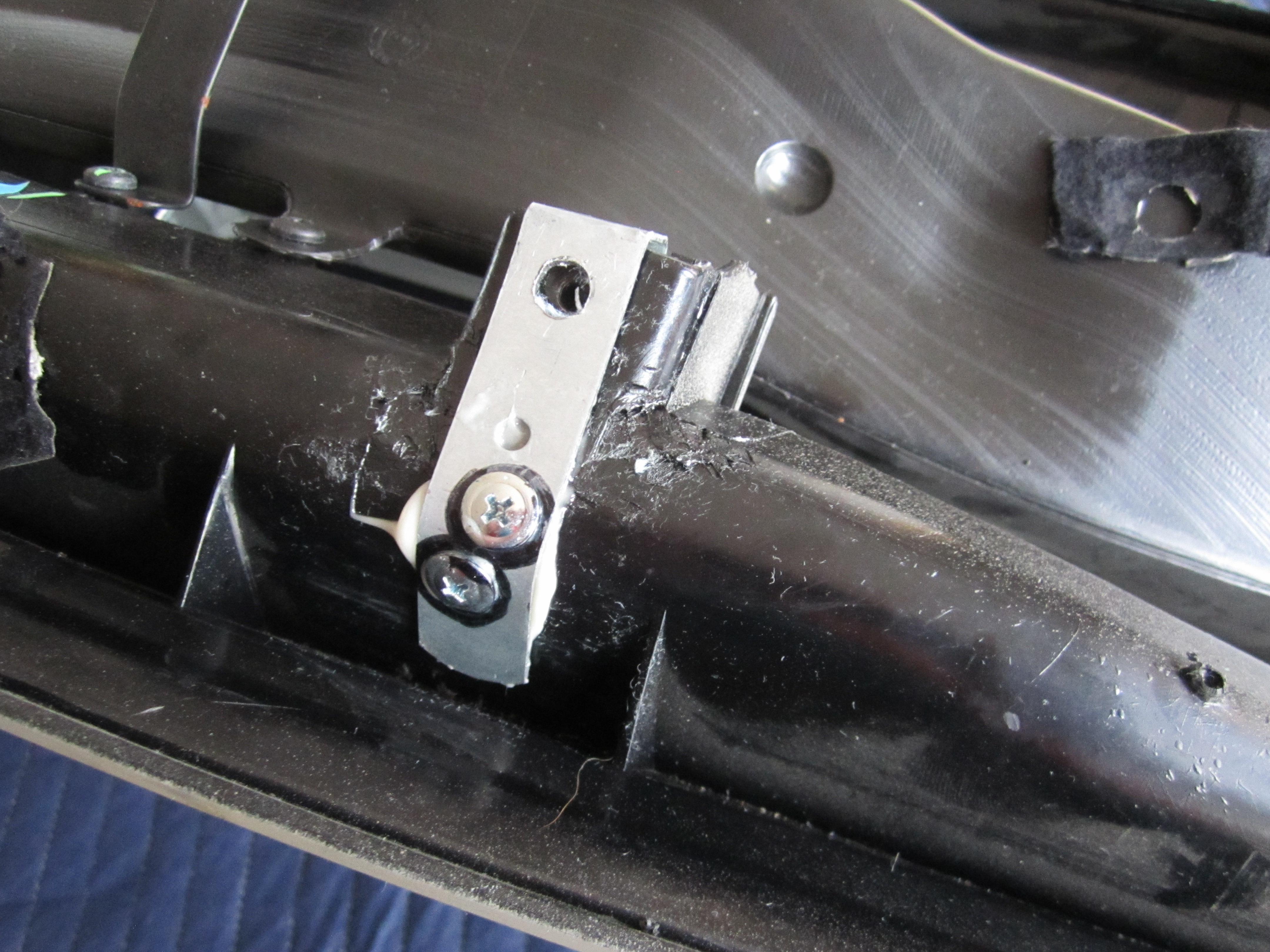

I now have one from a 99 with minor cracks on the dash mounts. I will repair it using JB Weld plastic 2 part epoxy, my little butane powered plastic welder from Princess Auto and some thing metal strips I bend to shape to strengthen the mounts. They will get screwed and bonded to the mounts. Below are repairs to the last car I did this on. My buddy has had this car for over 3 years and 30,000+ km and it is still quiet and way stronger than new!
