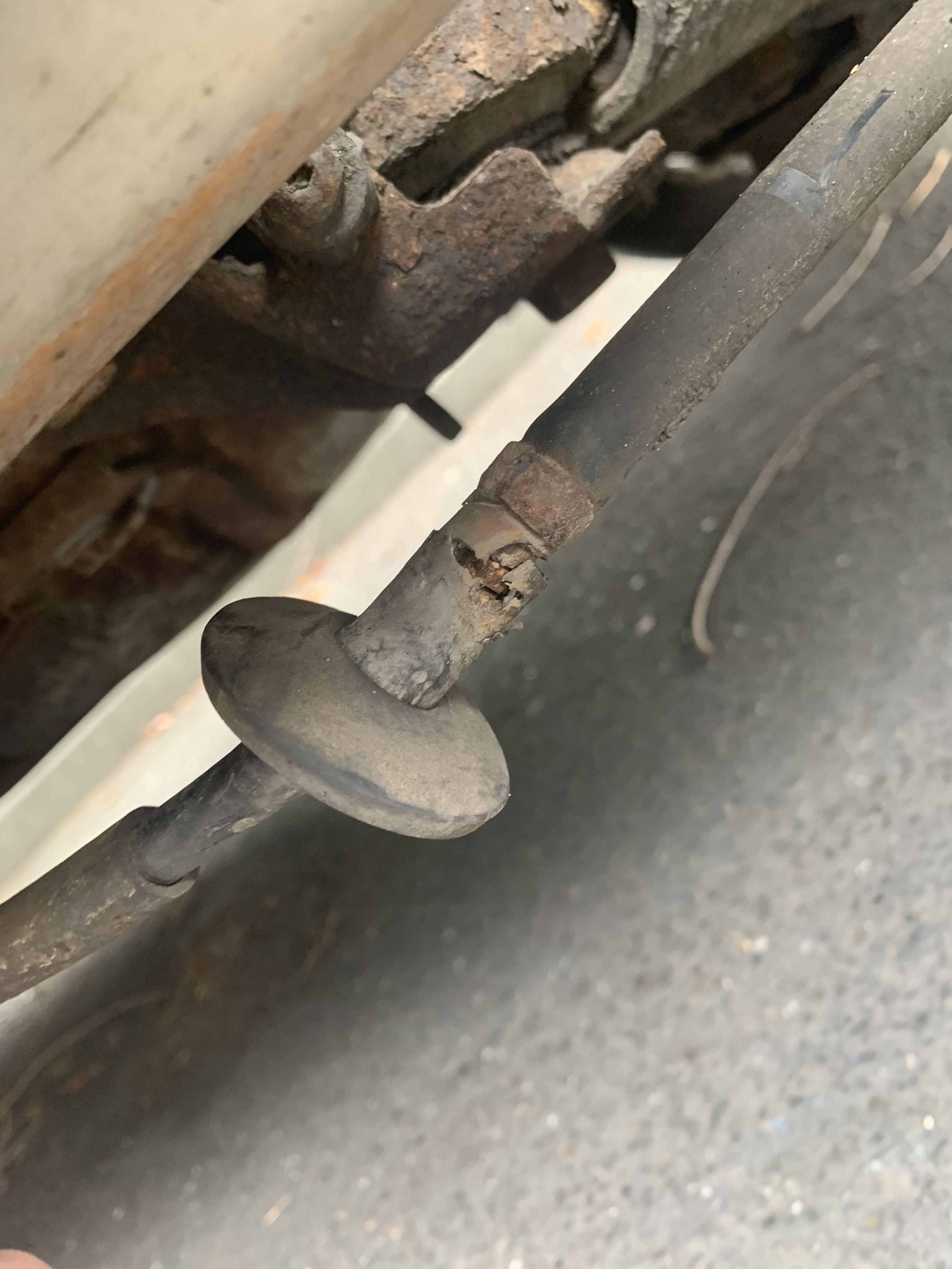

I wonder, is this tube important? Just ahead of the driver side rear wheel well; found it dangling- not touching the ground, but rusted a bit (shown) and rubbed through pretty bad against the rear wheel (out of frame)
I’m pretty sure Volvo doesn’t just throw these tubes on for fun, and Everything's “important”- but just for in terms of is it a SMOG thing I can ignore, or a brake line..

Parking brake cable. It should be mounted to the car, possibly the bracket just above it. Being as rusted as that it is almost certain the inner cable is rusted solid.
It is a bit of a job to replace them but not especially difficult. It requires the center console to be removed and the rear carpets raised from the rear doors to the center to allow the new cables to be fitted. The rear rotors and brakes will need to be removed from the hub to allow the new cable to be fitted.

Looks like a parking brake cable. Spray some penetrating oil in the crack dnd wrap it with tape to keep the water out. If it freezes up you need to replace the brake cable, an ugly job

Thank you two for confirmation, Parking brake is already shot; has been since purchase.. 10 years ago? (lord I’m getting old)
So no new harm, just underlining an existing item on The Eternal To Do List

When rear brakes are up, get new hats , parking brake shoes, and get those cables done.
