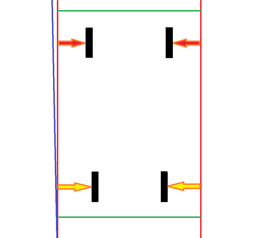

The video left out one parameter which MUST be met in order to get a correct alignment. I have attached a diagram to explain. Most cars do not have the same Track Width front and back. Assuming you don't have any suspension damage. You must establish that the Red strings are parallel so the Green lines are equal. Then you have to make sure the distance of the Red/Orange arrows in the front left and right are equal. Next the rear Yellow/Orange arrow distances must also be equal while keeping the red lines parallel, meaning green lines front and rear are still equal. You do the math.
Some cars the front track is wider whereas others it's the rear. The diagram shows the front track Blue line being wider like the 03 XC70 which should be the same as my 02 V70 XC. If you use the method in the video making the front Red/Orange and rear Yellow/Orange distance the same then measuring the front and back edge of each rim the car will be Toe Out at each wheel.
I have done enough of these over the years and can visualize the diagram so don't have to use the strings. If the rear Toe is close I just set the front Toe while centering the steering to get the alignment close so it doesn't drift or have uneven tire wear.
