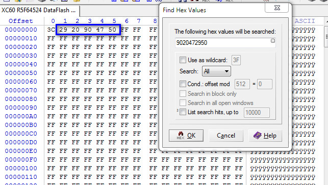

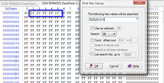

Never checked it, but not I have done it ant -very strange -, but it looks very easy - P3 models with R32C processors R5F64525/R5F64524 have PIN located jus at the start of DataFlash, they are just swapped: P3 CEM with M30882FJ processor has different system - it needs more deep analyzing. Attached are few flash files with PINs in their names.RickHaleParker wrote: ↑07 Dec 2021, 12:43If you can, figure out the location of the PIN in .bin. Then parse the .bin files to extract the PINS. Publish the list of PINs. Perhaps we can spot a pattern.![]()
Have a nice day,
ZRimaZ

Transposition cipher. Same thing in P1s & P2s. In the Teensy code VTL calls it Shuffle order.
What is the Hex editor you are using? ... I like how the search will find permutations.

RickHaleParker wrote: ↑08 Dec 2021, 06:57
