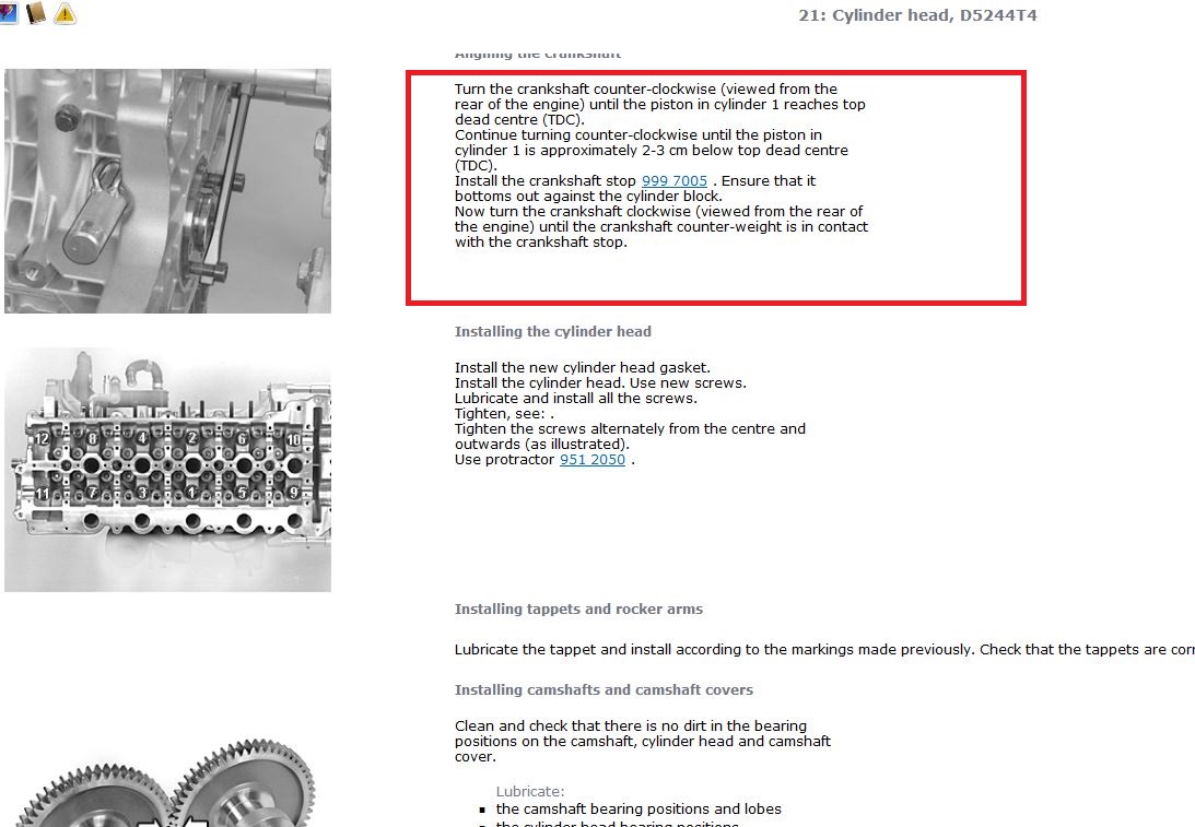

A quick one....from VIDA, looking from exhaust side, Cylinder 1 is the 1st one from left hand side (= 5th one looking from intake side)?
And should I turn the crank pulley or the flywheel counter clockwise?
Thanks

Crankshaft counter-clockwise ( Viewed from rear ) = Crankshaft clockwise ( Viewed from front ). Because your your left and right flips in relation to the engine when you turn around.
Looking at the back of the engine the intake is on your left,
Looking at the front of the engine the intake is on your right.
Because you turned around.
Same thing with clockwise and counter-clockwise.
Another way to look at it. From either end you move the top of the crankshaft toward the intake.

Cylinder number one is on the right hand side of the car, driver side for you.
Cylinder five is left hand side of car, passenger side for you.

No matter how a engine is mounted. Cylinder #1 is always on the end where the crankshaft pulley is.

I'm sorry I will have to seek more help from you. Car still wouldn't start. So I thought I'd start over again...Took camshafts out and ready to install them back and do the timing. Before doing that I want to double check the process....If I remember correctly, I did set camshaft sprocket to timing marking and then removed it but lets say I removed timing belt and camshaft without setting to timing mark and this messed up the timing.
So would the timing set to be OK if I install everything back to following order?
(with timing belt and camshafts being out of the head block)
1. Setting crankshaft timing - turning crank pulley anti-clockwise until stopped my the alignment tool behind the starter motor
2. Installing camshafts and do the locking behind vacuum pump
3. Fitting back the camshaft timing belt sprocket to the marking on the cover
Thank you

Looks good.zakmuh wrote: ↑18 Dec 2021, 10:01
