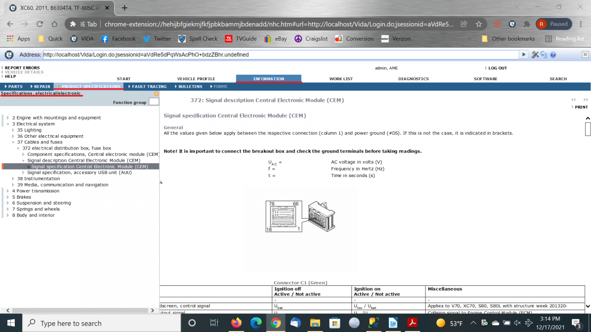

P3 on the bench .. Follow this link and get a EWD ( Electrical Wiring Diagram ). See if you can figure it out.
vtl
Posts: 4723

Post by vtl »
RickHaleParker wrote: 17 Dec 2021, 02:06
eltoro wrote: 16 Dec 2021, 13:58 Does anyone have some instructions about the P3 bench setup? It would be a great way to start playing with the code and setup?
It's in VIDA, in information section, under cables and fuses.

vtl wrote: 17 Dec 2021, 13:15 It's in VIDA, in information section, under cables and fuses.
This is so much easier then decoding a EWD. 👍

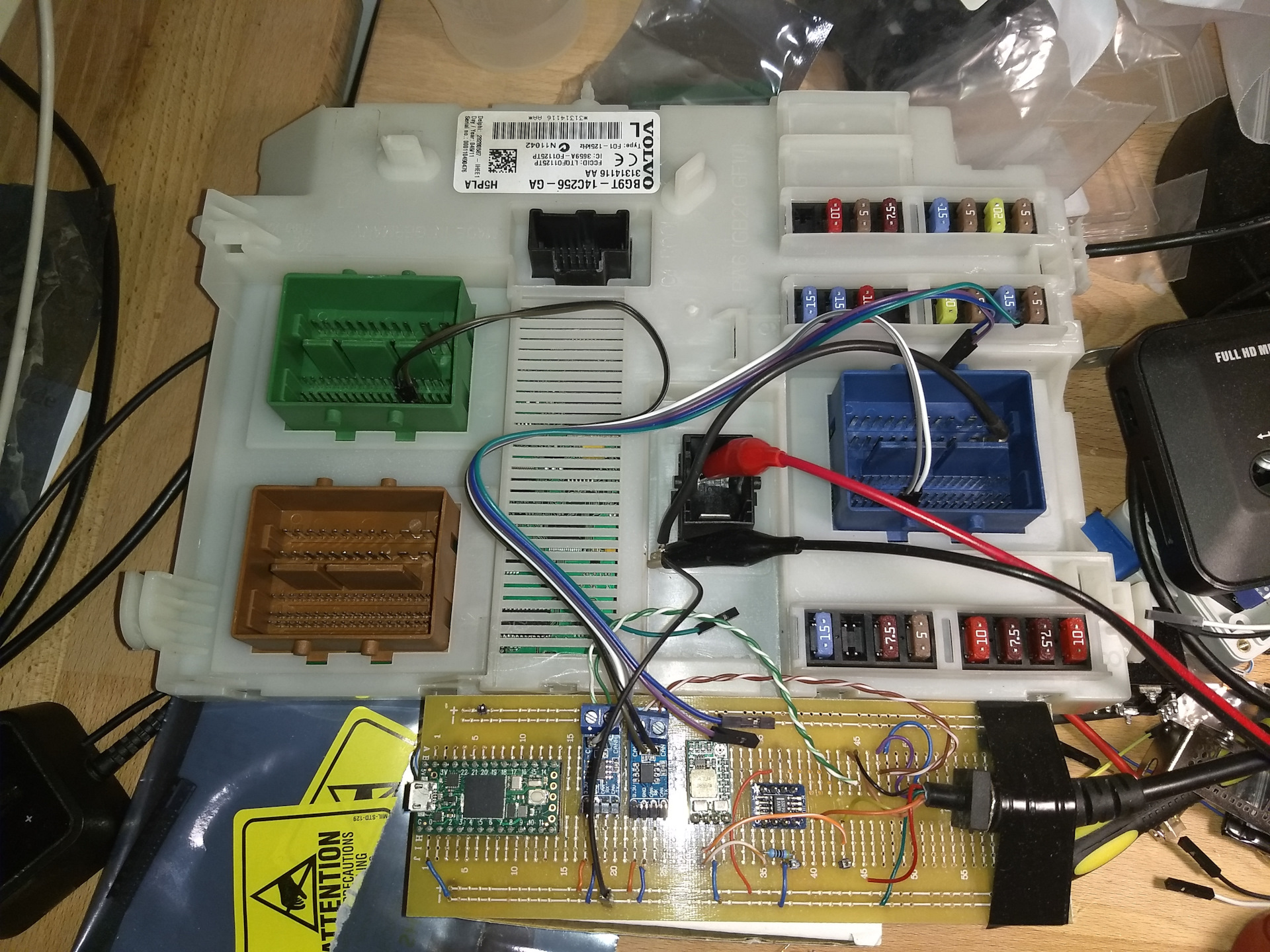

This is what I came up with for P3 Bench setup.
Teensy loaded with VTL's P3 branch. Do not use the Main branch.
Connector C5 (Black connector next to the Blue connector )
  • PIN : Function , ( Comment )
    C5:1 : Battery Power (+) , ( 12V which is marked 30+ on a EWD )
    C5:2 : Battery Power (+) , ( 12V which is marked 30+ on a EWD )
Connector C1 ( Green Connector )
    C1:30 : MS-CAN (+) , LS-CAN H ( White wire )
    C1:31 : MS-CAN (-) , LS-CAN L ( Green wire )
    C1:54 : Battery Power Ground (-) , ( VTL is grounding some place on C3 but C1:54 is the official power ground. )
    C1:63 :15+ , ( Key on. VTL is not using this but Vdash requires the key to be on. Apply +12V for Key on conditions. )
Connector C3 ( Blue Connector )
    C3:6 HS-CAN (+) , HS-CAN H ( White wire )
    C3:7 HS-CAN (-) , HS-CAN L ( Green wire )
