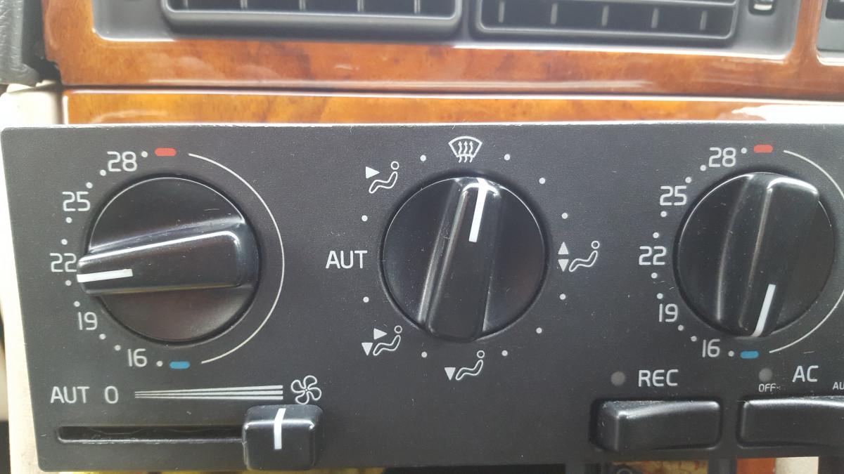

Neil, I photographed the front of my ecc as I cannot see the C or F markings. I may have missed something as I am somewhat overloaded/lost with sorting this out.

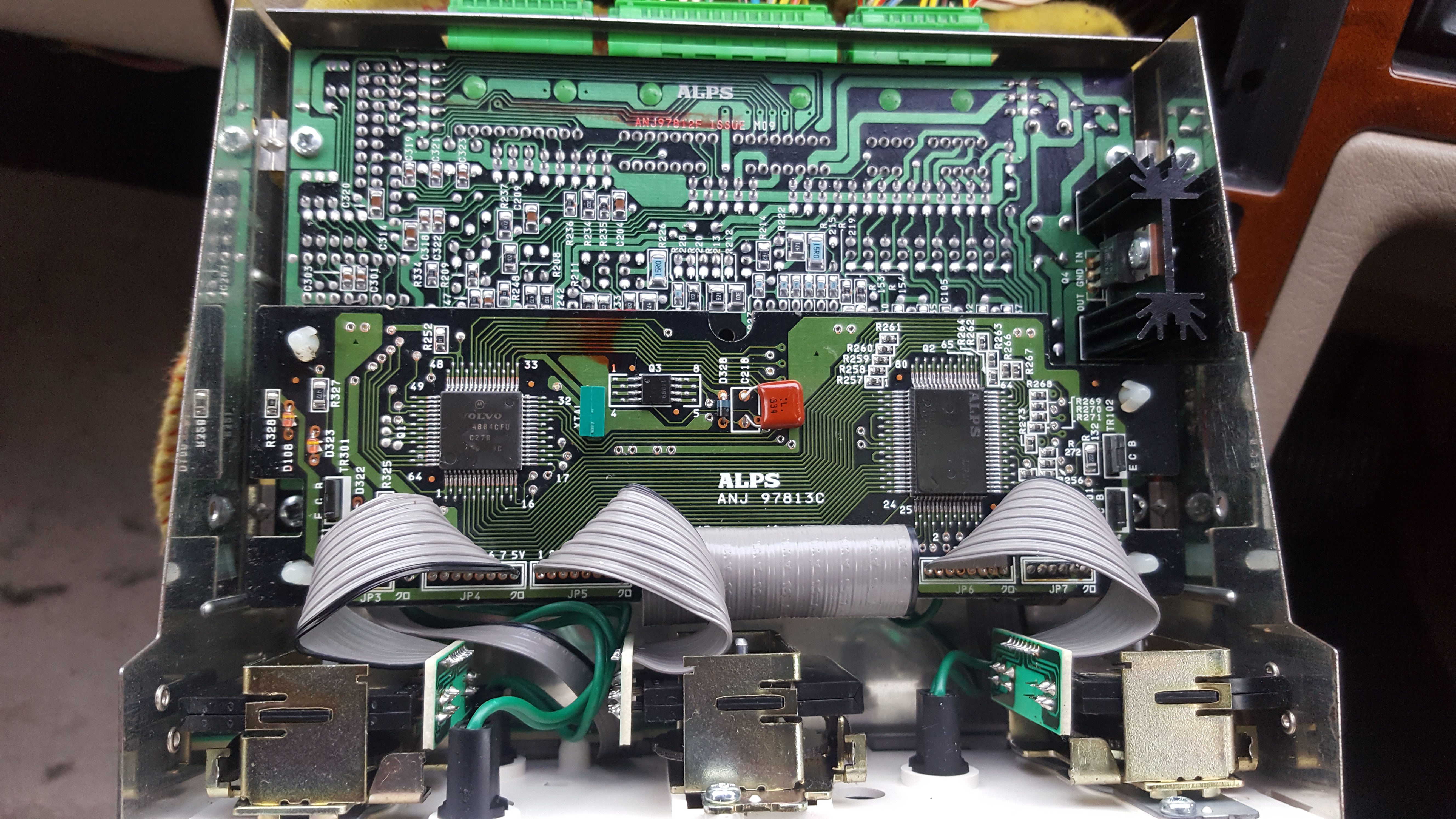

Rick, I opened up the ecc as you suggested but again with a somewhat foggy head I could not see any diagnostic switch/button so again I snapped a picture incase I've missed something.

Can you pull the ECC diagnostics codes from the jumper type diagnostics port under the bonnet?
On some of the older pre-1999 ECC you can pull the codes from the front panel of the ECC. I don't recall now it is done.

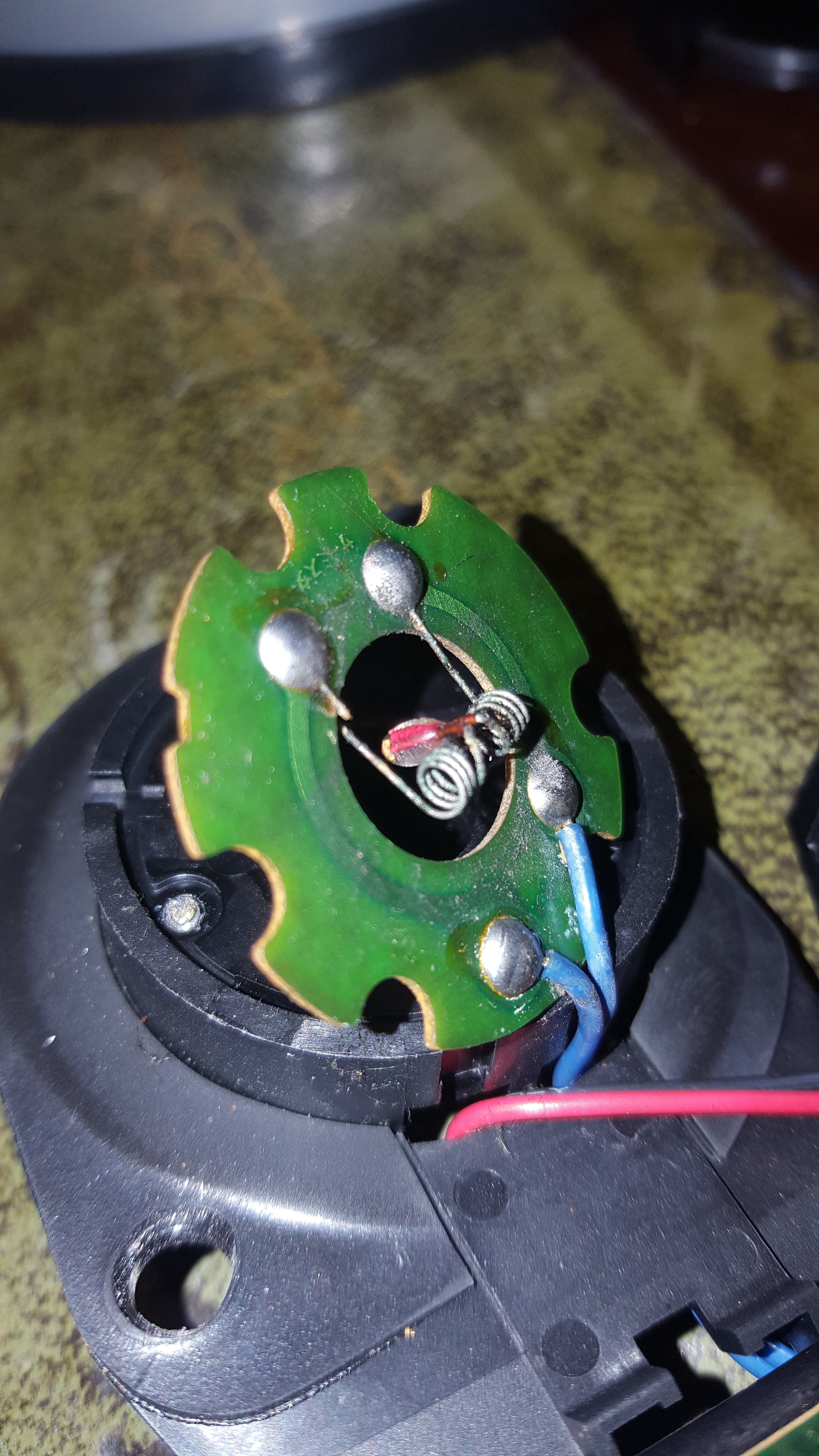

Ok, I decided to take your advice and start on the driver side temp inlet sensor. I can see it spinning for a few seconds then the little fan stops. Blew the dust out with compressed air but even after wiping the dtc the same code 124.
So I decided to remove the sensor. Maybe I am missing the obvious but that was one of the most awful difficult cumbersome part I have ever removed from a vehicle in 40 years. Seriously, what were the designers thinking placing that second screw up high? Surely a slide in snap type removable clip thing drop down pull twist squeeze wiggle would suffice. Anyway, It's out and I think I may have the problem in my sights........hopefully a straight forward repair...Ahem! (see previous 35 posts).
I have attached a photo for repair tips...if any. Happy holidays to everyone and I hope it's a wind of change for 2022.

As Rick says, your unit is in degrees C not F.

Looks like a RTD with Capacitive noise filter. If some body can figure out the resistance curve. A new RTD could be wounded and the sensors could be rebuilt.

I may not have been clear in my last post but I decided to deal with dtc 124. This is the inlet air temp sensor above the driver head behind the grab handle. Clearing with compressed air is the go to solution but in my case this did not stop 124 dtc. I removed the sensor and disassembled it.
If you look carefully you can see a break in the thermistor wire (lower part of picture) probably due to corrosion which the wire is covered in. Anyway, a clean up and solder repair of the broken section provided me with a continous running fan and no more dtc 124.
I went for a 30 minute drive since the roads are absolutely empty in London and rechecked the dtc and no more code 124.

Well done on that one! Finding a small break like that is hard to find, and fixing it is very well done!

Neil, Bloody hell, half the work was finding a suitable head lining adhesive spray. I was so careful to be gentle but the sensor is very deep and the upper screw is tricky. On reflection, I could have easily made a suitable instrument to remove the upper screw but by this time the dtc 419 was starting to P*** me off and I felt the need to accomplish the 124 outright. The hardest part removal of the surrounding plastic (can easily break after 27 years) gently, even so, I may have two minor cracks. I would not even bother to attempt the passenger side.
Anyway, DTC 124 gone and the repair is working fine. Sadly, at the smallest chance....out comes the phone torch and a quick scan to ensure the motor is spinning......this is, and may become OCD....no offence intended!
