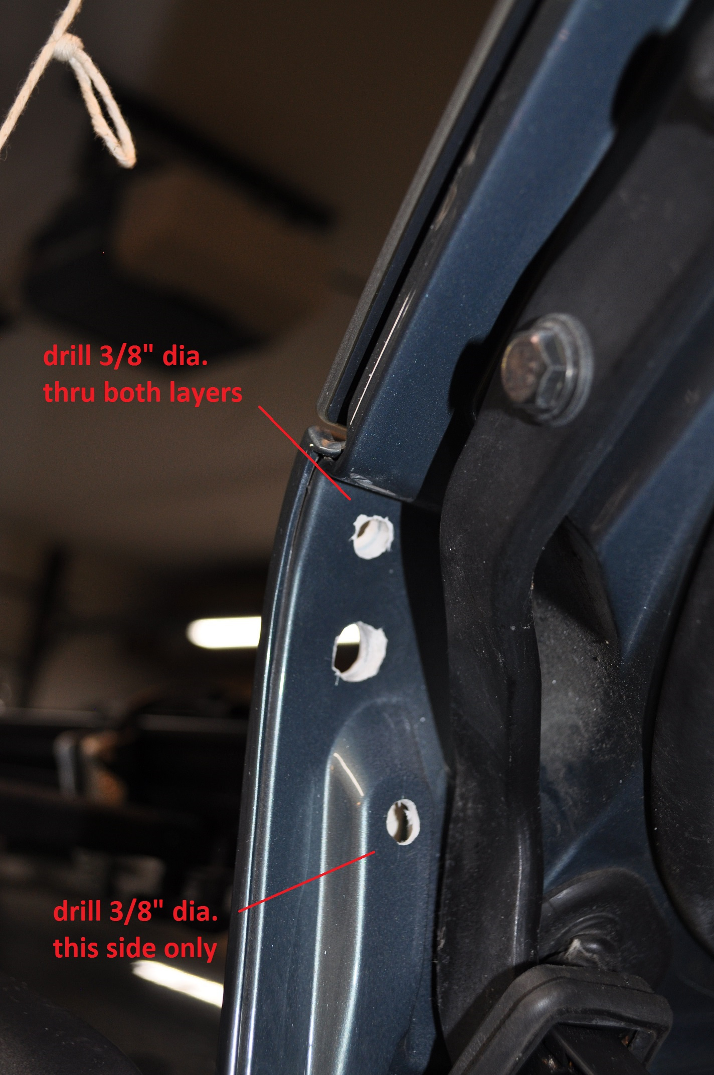

Bottom holes. Note that these are marked already from the factory. I would advise against drilling the center hole. This is the hole location for the harness pass through, but it is in the wrong place. The instructions give dimensions for this to be drilled from the top, but they are also incorrect. Found out the hard way.
Next step is drilling the 3/8" holes from the bottom.
Now it's time to open up the hole close to the edge of the tailgate with the 5/8" hole saw. This is what the end result should look like:
