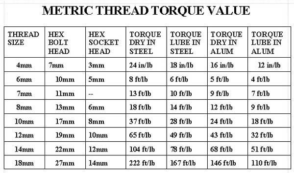

Matt,
Here is a table of typical torque value for a Bolt into steel dry or with anti seize and also for Aluminum.
I believe that this is for a Grade 8 bolt.
Thanks
Paul
Thanks
Paul

Note that the broken cam tool bolts in a another thread are 7mm at 13ft-lbs. That's why they break off and ruin your camshaft.
