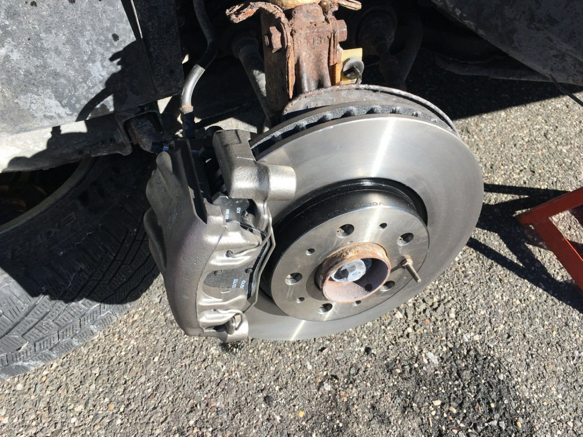

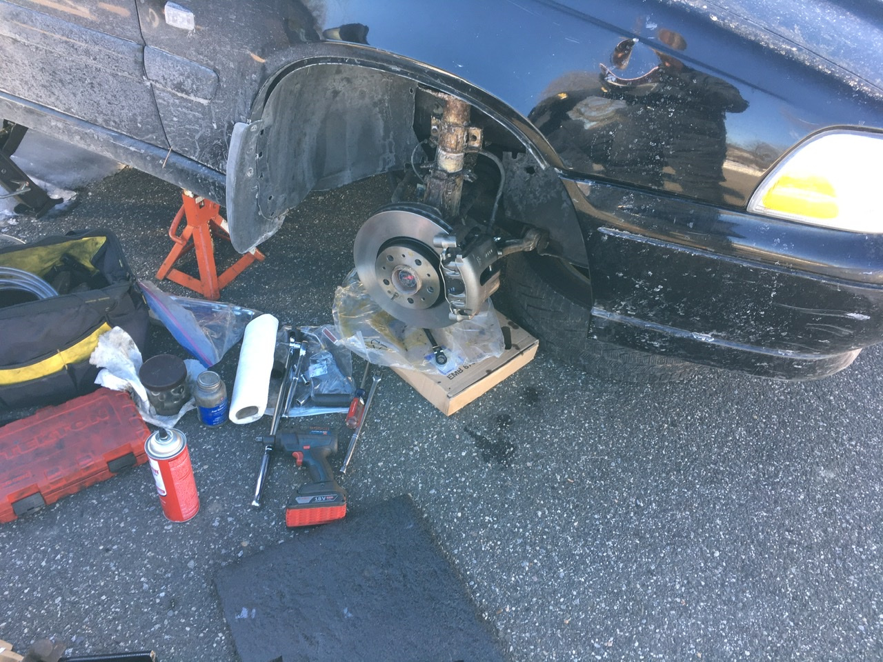

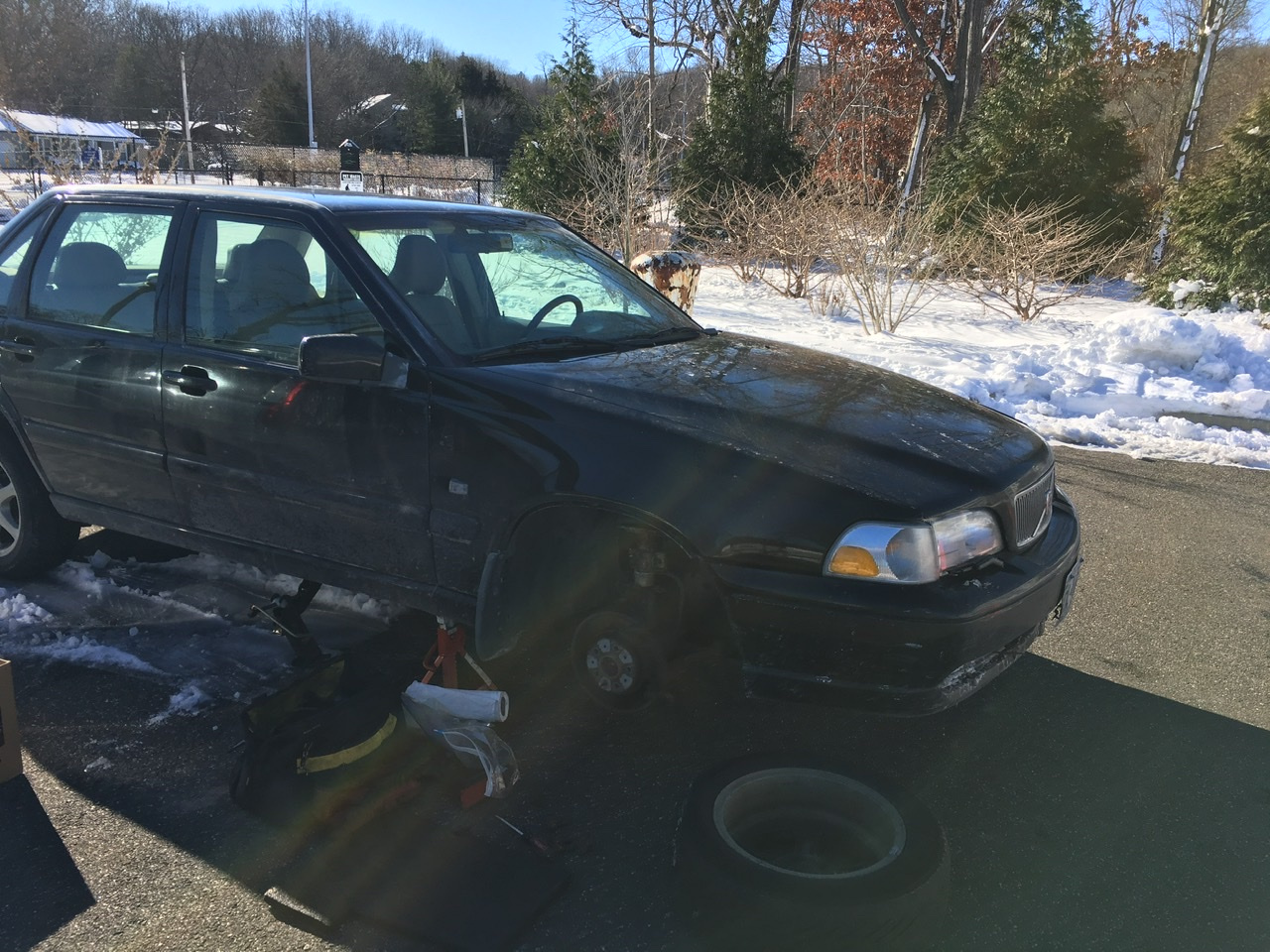

Knocked off rotors, calipers pads on Evita at 168500
Pushed 500ml brake fluid
All hardware cooperated which was nice as it was 24-27F out, at least I was out of the wind.
Best part. Ordering the wrong rotors from FCP, rears instead of fronts, then figuring out I had thrown a set of Volvo rotors from my stock in the trunk in case FCP didn’t have them in stock ( FCP is right on the way to the ferry, so I pick stuff up on the way )

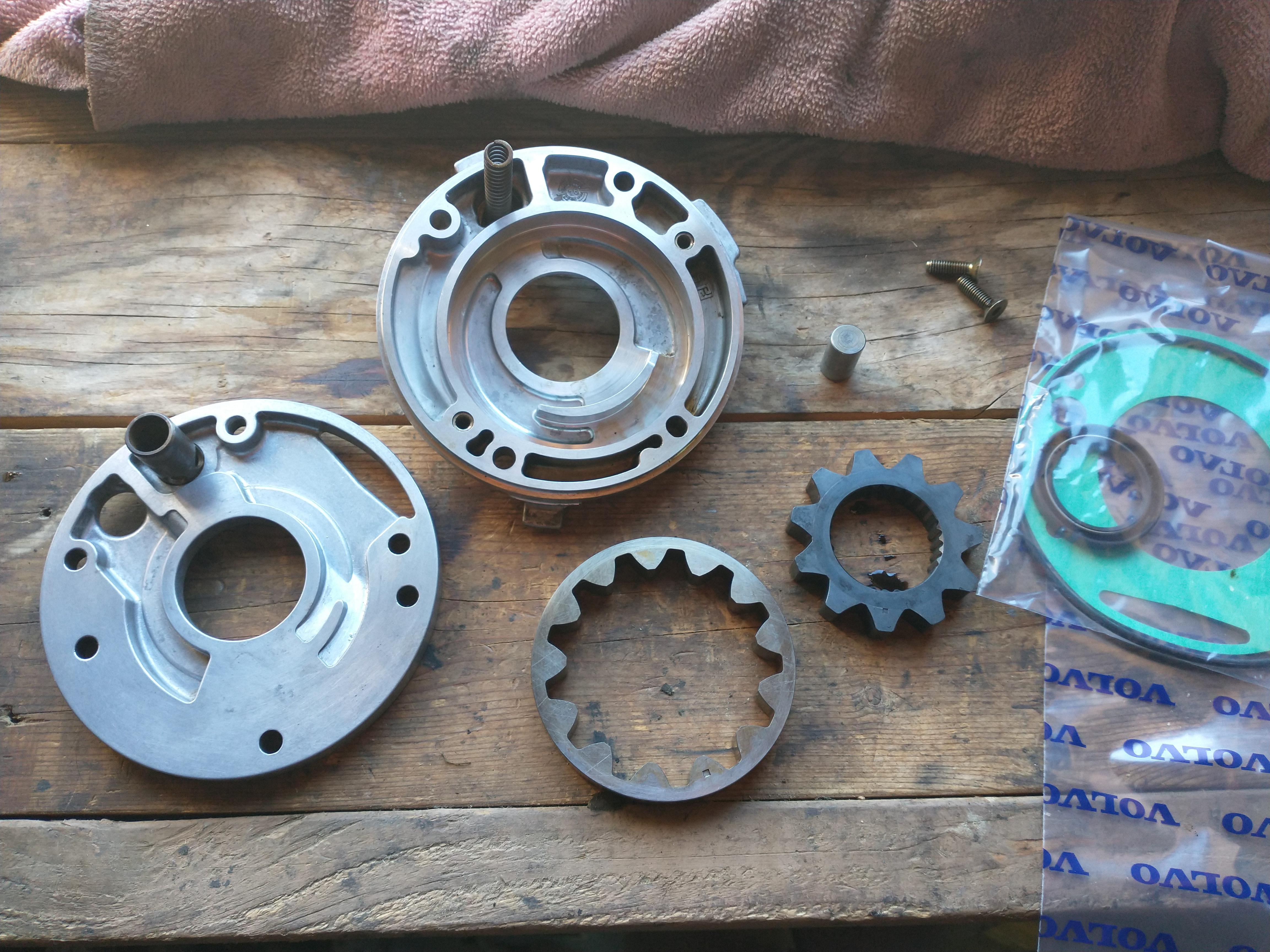

Started putting things back together on the engine.
Renewed oil pump
Renewed oil pump

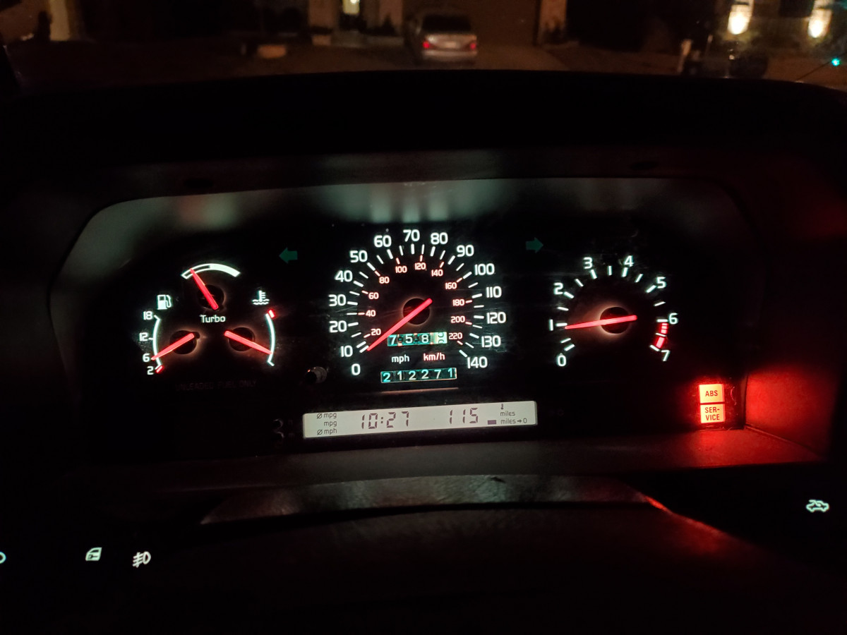

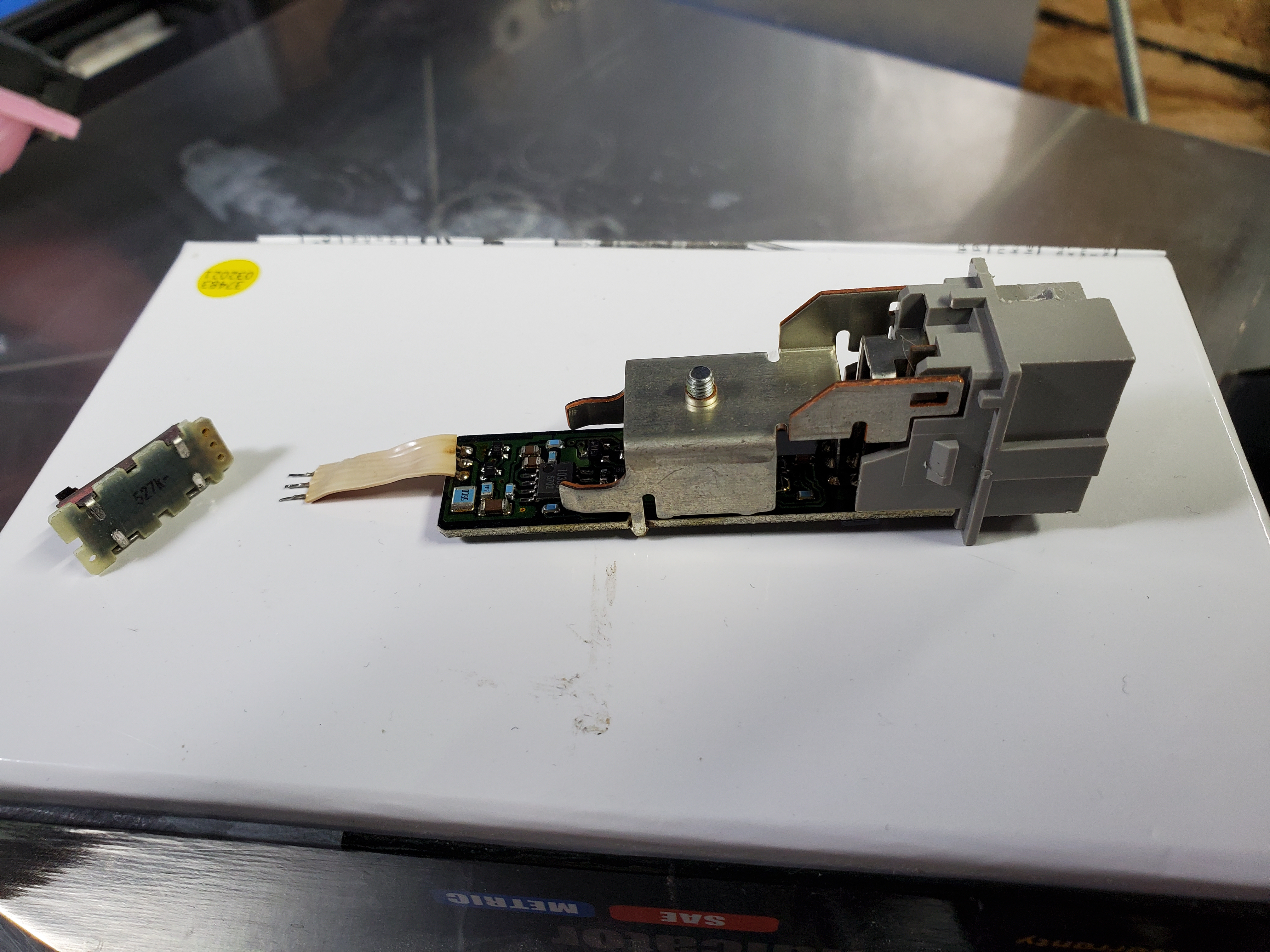

A few months ago I saw dash lights stop working in my 850 and then they would magically turn on half through a drive. I originally thought it was the light switch. I posted here a disassembly with cleaning and a little dielectric grease. I thought I fixed it but the problem returned a short time later. Today I noticed if I mess with the dimmer or "rheostat" the light would flicker and eventually turn on. Pulled the switch out and gave it a few taps. Lights work great now. Just have to tap the switch every now and then.
Holy crap that is an expensive switch to buy new. About $215 new on FCP. At that price I may try to destroy it fixing it first.
- ZionXIX
- Posts: 1310
- Joined: 11 August 2014
- Location: Texas
- Has thanked: 64 times
- Been thanked: 194 times

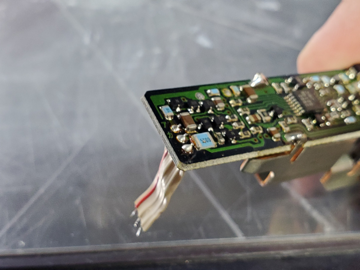

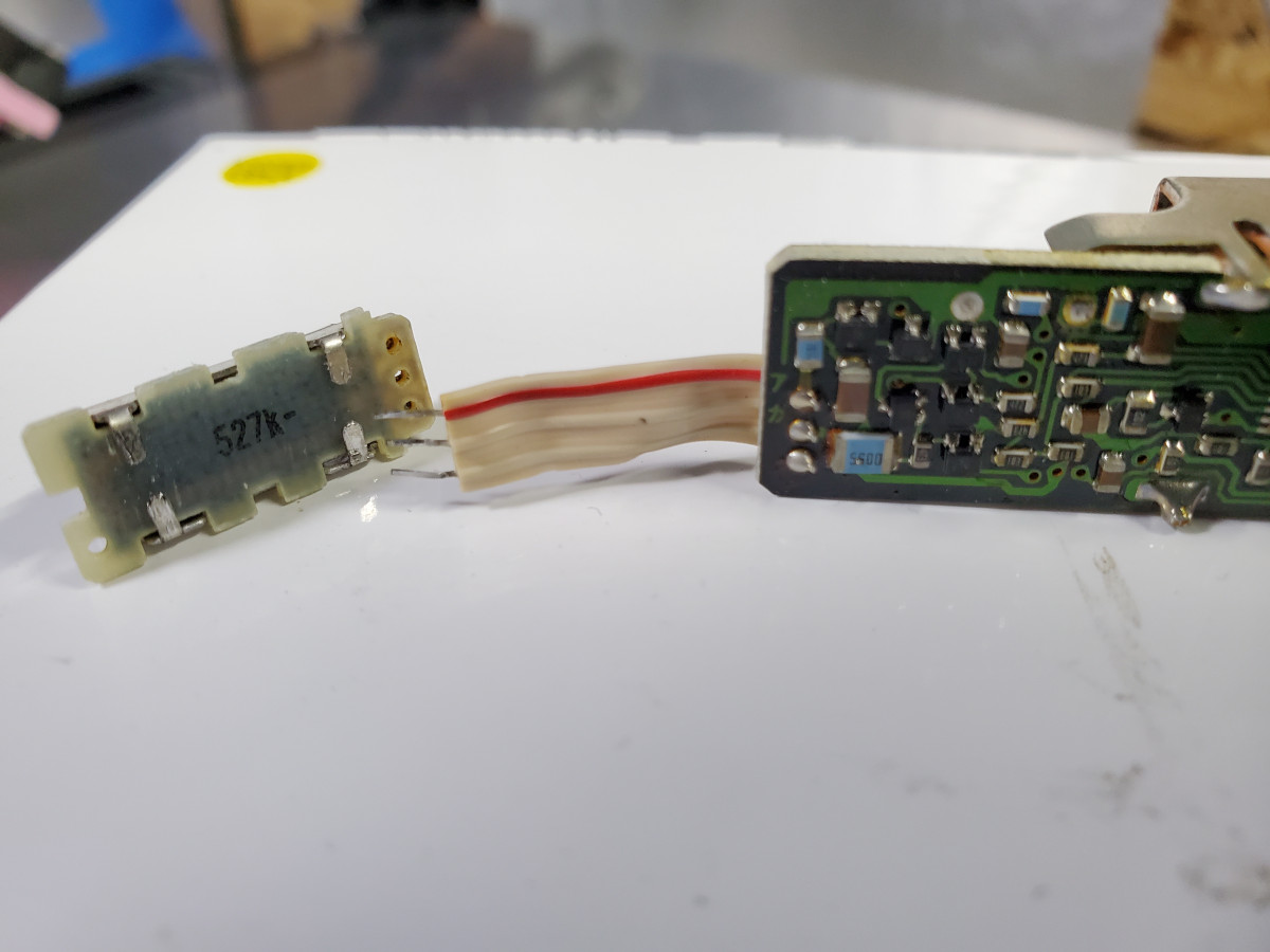

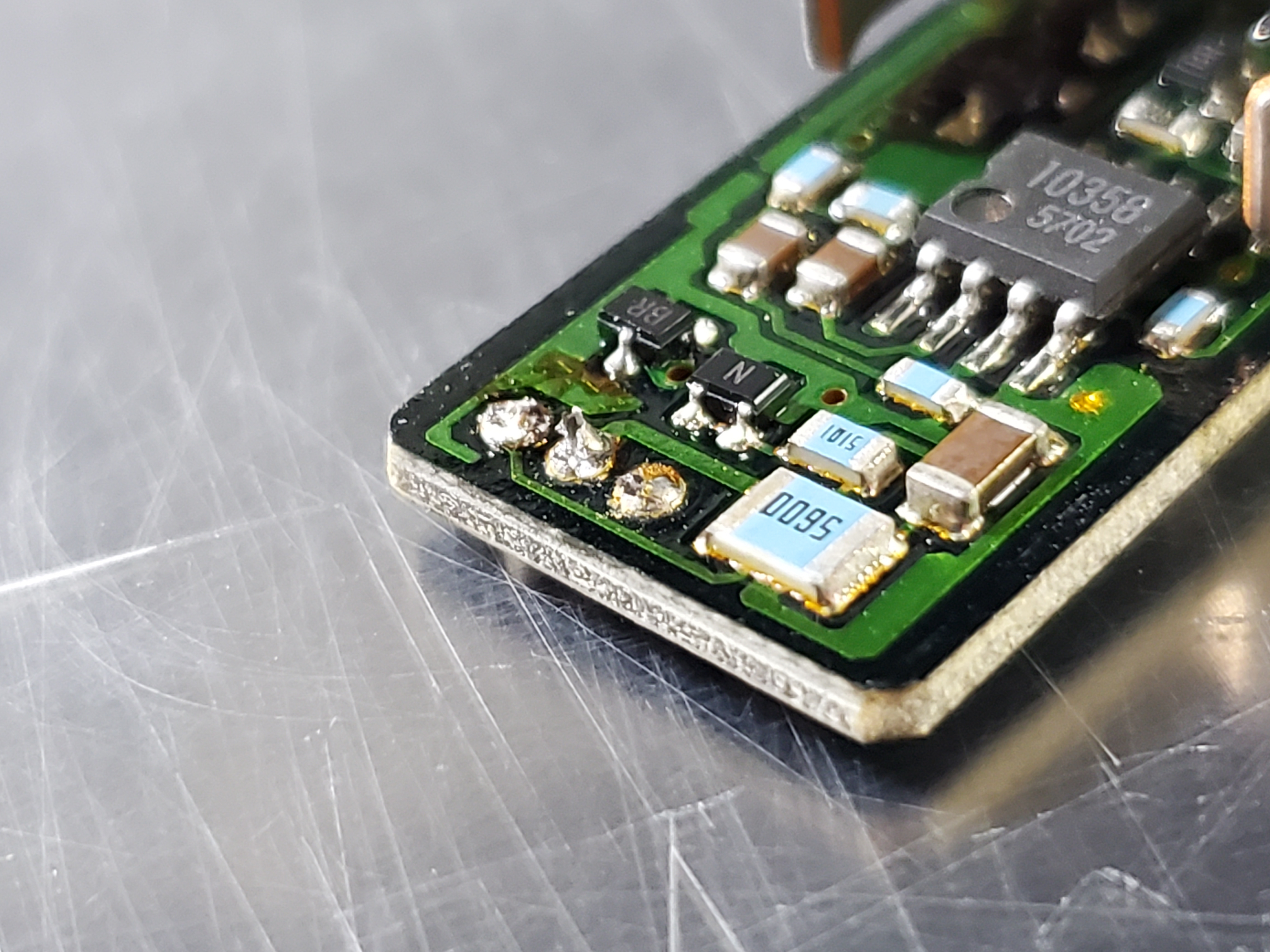

Part 2 of fun with rheostats.
I disassembled my rheostat which is overly complicated by the way. You cannot fully open this switch without removing the slider switch. I de soldered mine and then plugged it in to see which wires had to be shorted to make the lights come on. The slider has 3 wires. Plugged in and no wires attached the lights default to "on". If you short the red marked wire and the middle wire the lights turn off. Im pleased that the lights will stay on with no slider at all. I went ahead and desoldered the 3 wires from the board as well and now the dash lights stay on as long as headlights are on. This is great because it's a free fix. I have never needed to reduce the dash illumination. I find the 850s to have a comfortable brightness at max power. Newer vehicle dash lights distract me greatly when driving. So I'm gonna say volvo got it right and just continue existing with 100% dash lights like I always have. Hypothetically I could solder a new slider in place but goodluck finding that exact one.
