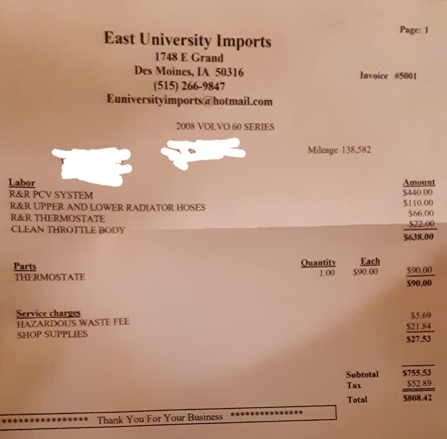

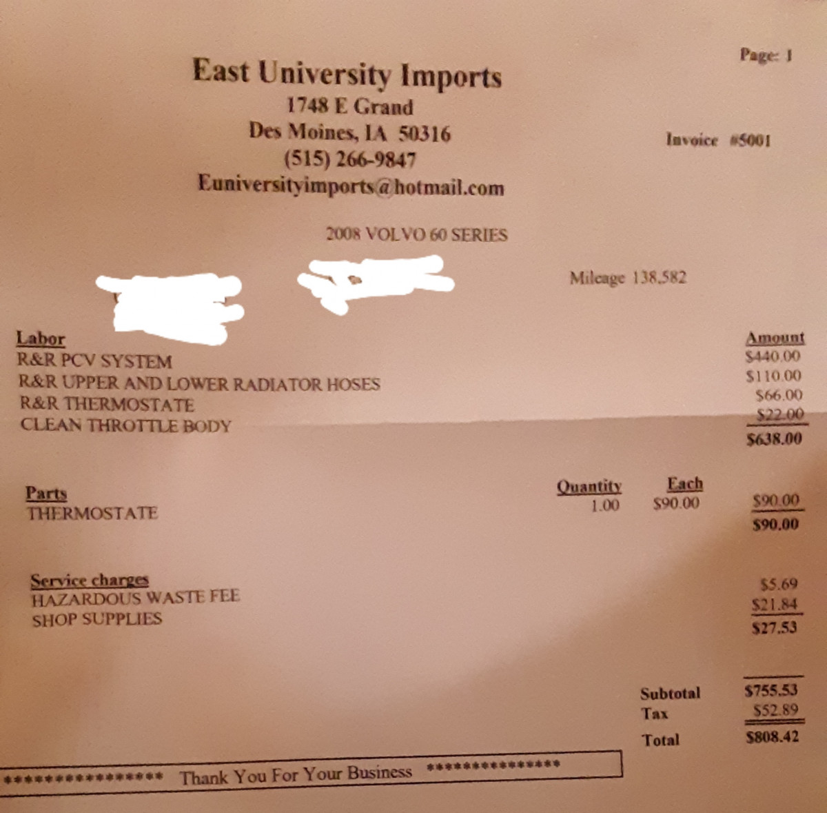

Just did mine, you are getting ripped off at $1500 (even in Canadian $).
I paid $275 US for the kit and rear coolant line from FCPEuro and got busy with other stuff so took to my local independent shop and paid $440 US. Also had them change thermostat, radiator hoses and clean the throttle body while they had the intake off.
Doing the glove test how much air is the engine pushing?

Yea I got lucky bringing the parts in. I ordered them planning to do myself but as my schedule filled up and I watched numerous videos the $450 seemed a bargain to let someone with expertise do it. I was surprised they said they'd use my parts, said they had used stiff from FCPEuro in past. Only issue they mentioned was the rear coolant line took some convincing to lay where it needed to.
I'd redo the glove test...everything I've read that will indicate how urgent the PCV service is. Can pull the dipstick a bit short term so any pressure has a path to escape.
