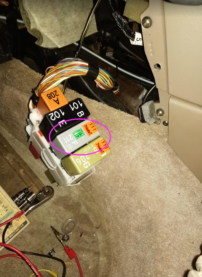

Thanks! Pictures below of what I'm looking at ha

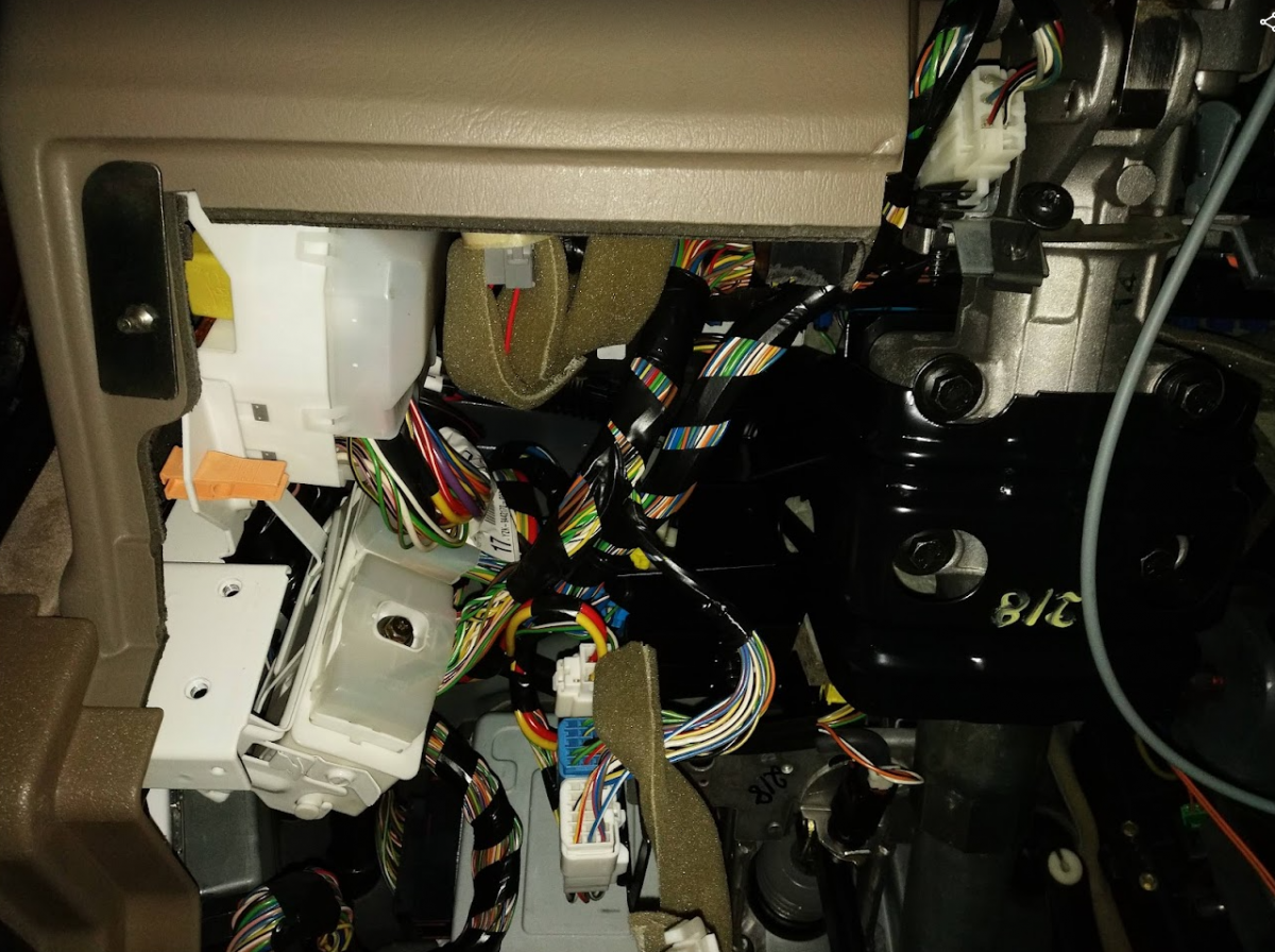

Anyone know what the jack is for in the following image?
