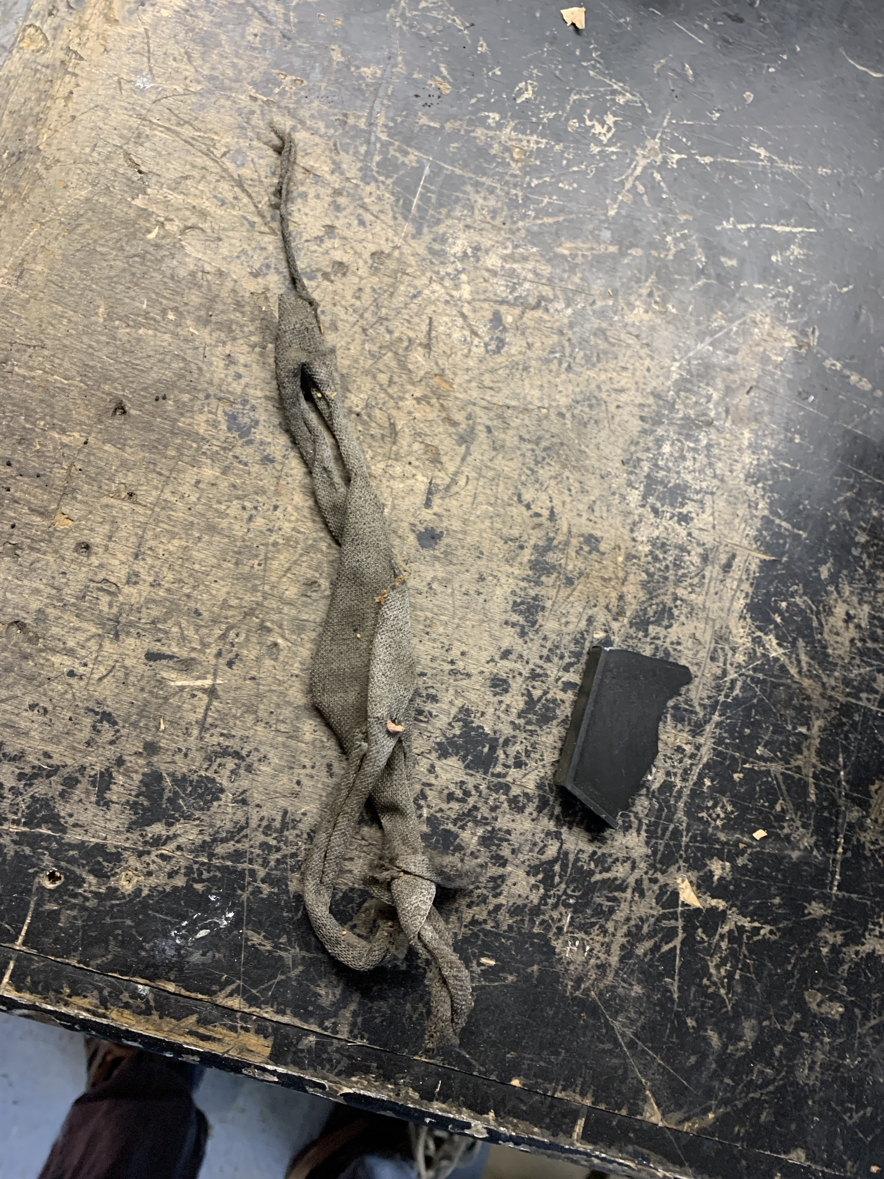

Replaced the blower motor in the XC90 today finally... MAN that was a pain. There is no room to work against all that sound deadening. Took way longer than it should have, but the blower works perfectly now. No more noise or violent vibration with it on high speed. Now we'll see if the lukewarm heat was due to lack of air movement or a heater core issue.
Also replaced the serpentine belt on the V70R last night. Old one didn't look too bad, but it's original as far as I know, so why not. Also topped off the oil... needed a quart after just 500 miles, and it doesn't leak a drop. It also doesn't smoke, which is confusing the hell out of me as to where it's going.
Edit.... this is what I found wrapped up in the fan. No idea how that got there, looks like an unwrapped shoelace or a piece of fabric.

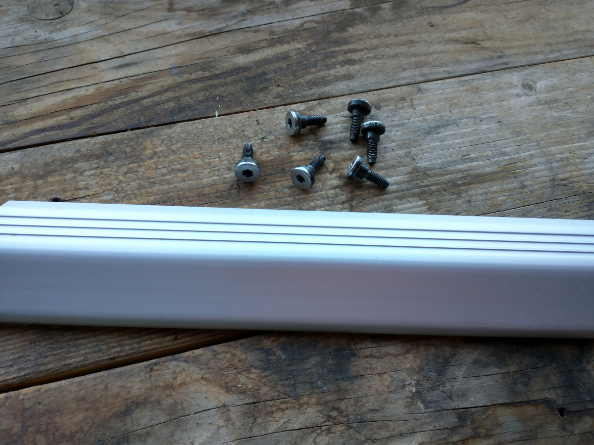

Holding pattern till I receive the flexplate to torque converter bolts, so some silly work was done. Stripped off the remainder of some old yellowed clear coat on the fuel rail cover, and took the buffering wheel to the spark plug cover bolts. I think they will look better
" chrome " than the stock black. And besides, she needs some " pretties " after all of this work ( or so she says ).

That first looked like a snake skin. But then I hate finding snakes.bmdubya1198 wrote: ↑26 Jan 2022, 18:49
