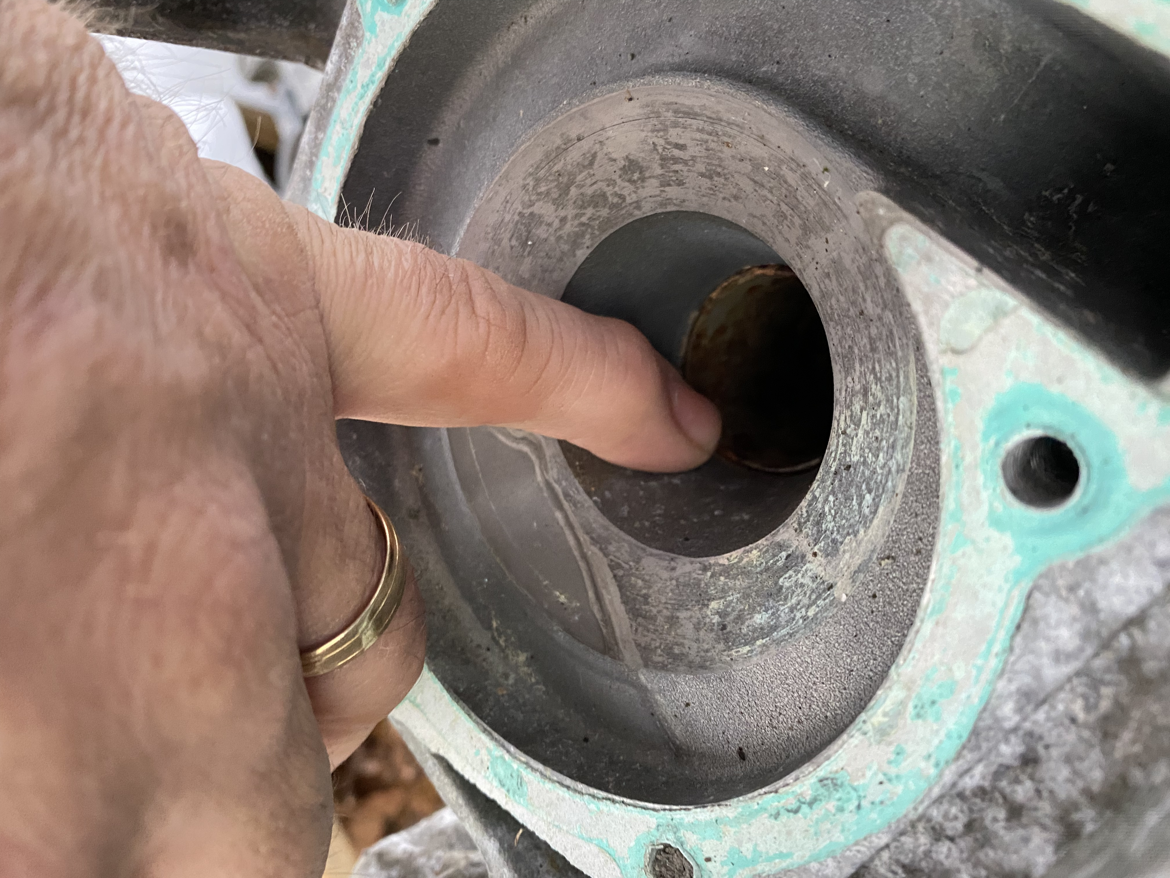

Pictures from water pump side , with pump removed.

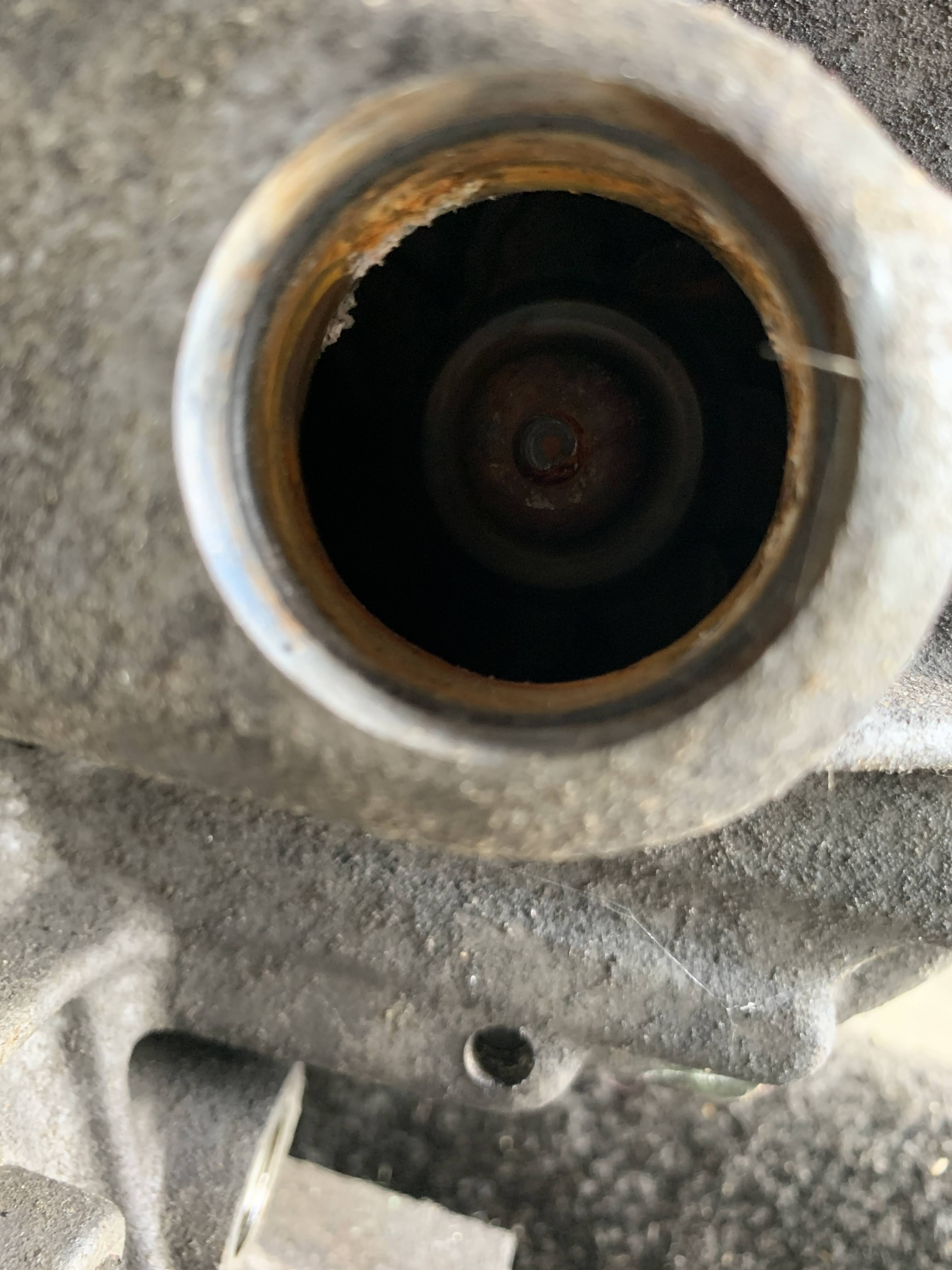

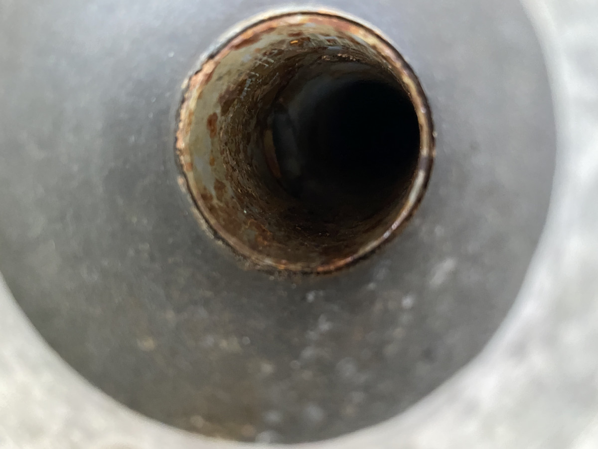

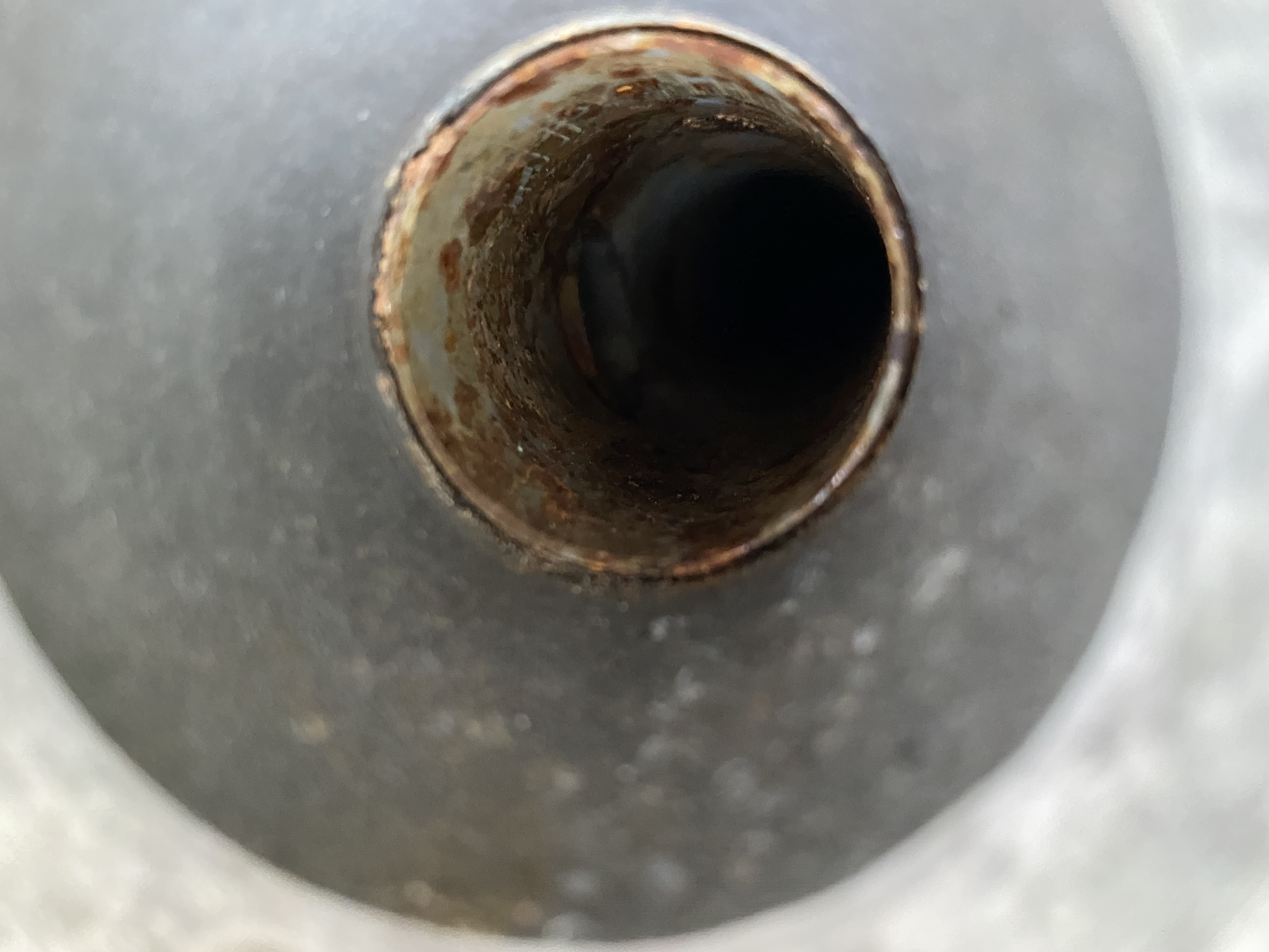

abscate wrote: 02 Feb 2022, 16:46 Pictures from water pump side , with pump removed.
Nice pictures. Where is the o-ring? Sveedy, do you have a picture of the back of the coolant pump with the coolant pipe removed? From your description, I can't picture how it works.

I thought I had a pic of it but I guess I don't. The o-ring sits back in that opening in a recess. Really bad design. Looking at abscates pic, I'm thinking that maybe one could keep the o-ring in its recess from the pump side while pushing the pipe through from the back.
But I think it would take a doctor of a specialized nature, ie one who has a great deal of sensitivity and dexterity with their index finger, to be successful at it.
That sharp cut edge that you see is the problem with getting the pipe to go in past the o-ring. That's why I'm contemplating trying to tapper it a little. But the main problem is that the o-ring just seems too small to begin with. It should " spring " into that recess and stay snug, but if the ring is seated in the lower part of its recess, then it doesn't go in at all in the upper part, and will be pushed right out.

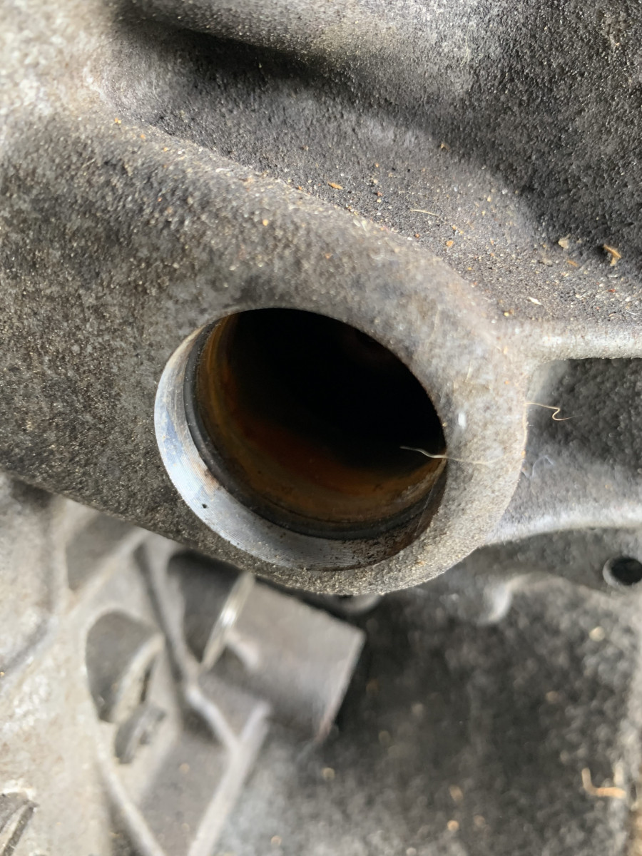

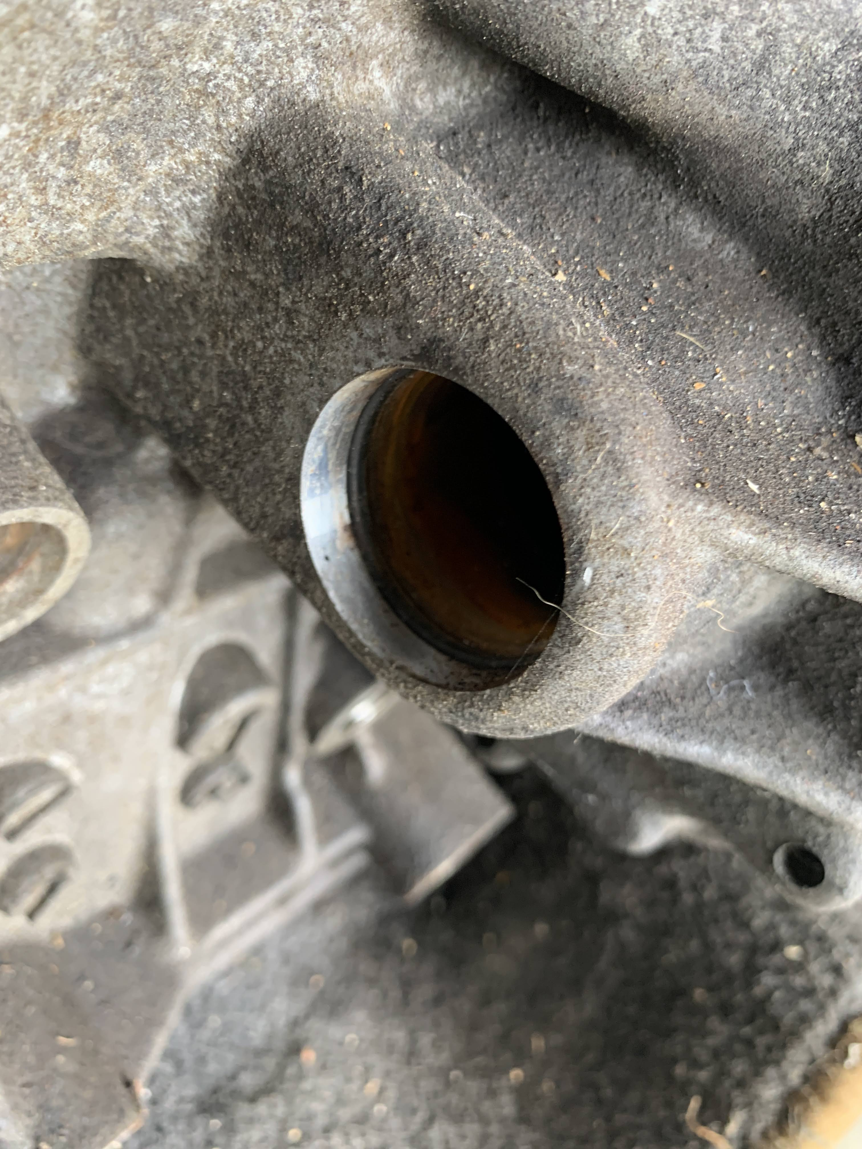

bmdubya1198 wrote: 03 Feb 2022, 09:25
FireFox31 wrote: 03 Feb 2022, 02:01 Nice pictures. Where is the o-ring? Sveedy, do you have a picture of the back of the coolant pump with the coolant pipe removed? From your description, I can't picture how it works.
I have a spare block I take take a pic of. It's just a smooth surface IIRC, press fit with the coolant pipe.
Correct. Smooth bore with a recess cut to accept the o-ring.

Yup, there is a groove.

Yep. Just how it SHOULD look. But the new one just slopped around in there. I could see how it would work, once on the pipe end, but getting there is the obvious problem.
Looking at that pic, I'm wondering if I get a better sized o-ring, and use some sealant, that maybe I could avoid pulling the water pump ? Yes, ...I'm trying to avoid doing that after just getting everything back together.
