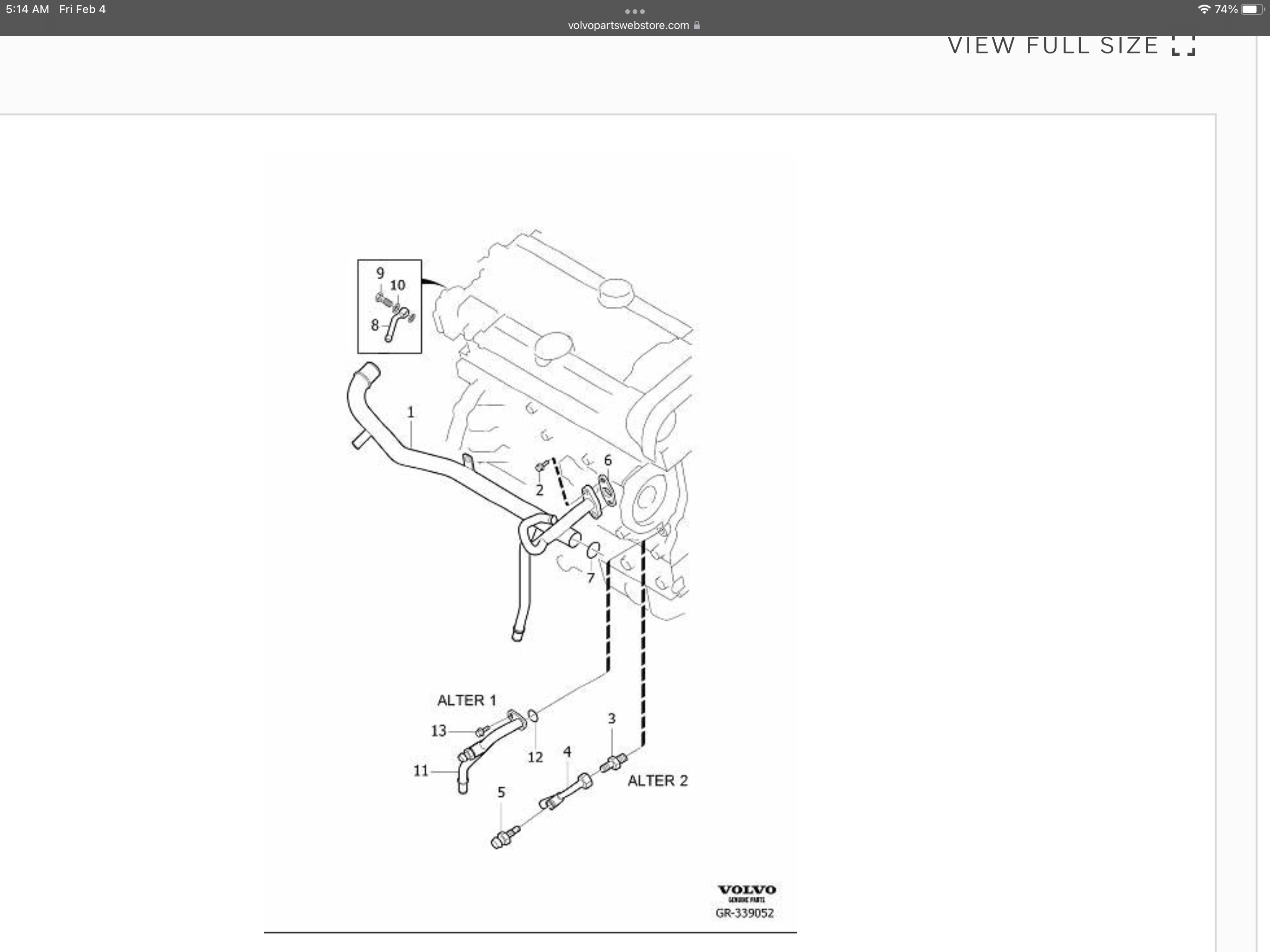

You'll know it's lined up because of the additional pipe going to the cylinder head, with the oval gasket.That needs to line up, so that's an easy way to tell that it's all the way seated.FireFox31 wrote: ↑03 Feb 2022, 15:08 Thanks for the pics, bmdubya1198! How do we know how far to push in the pipe? Is there a ridge on the block after the o-ring to stop it, or a ridge on the pipe to catch on the block?

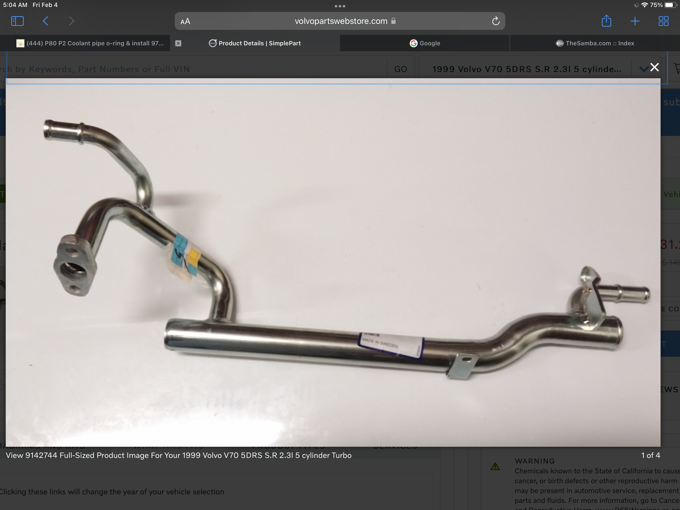

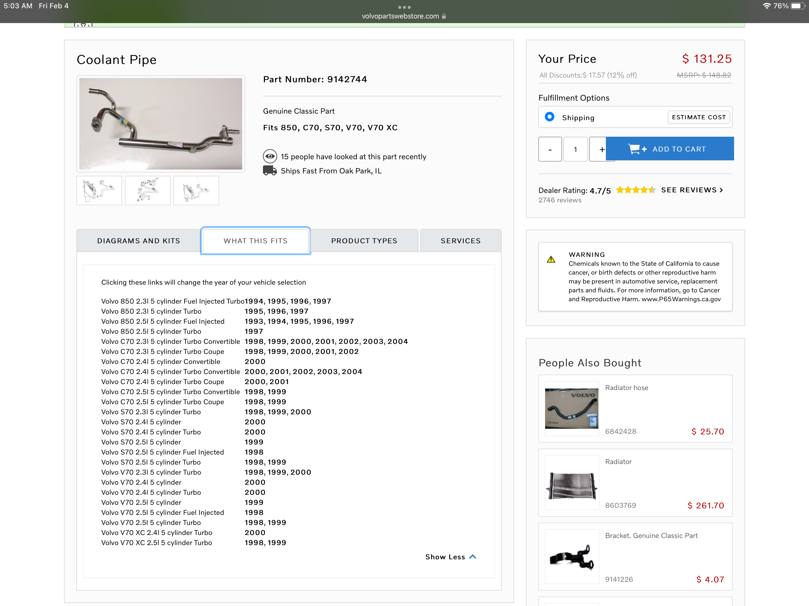

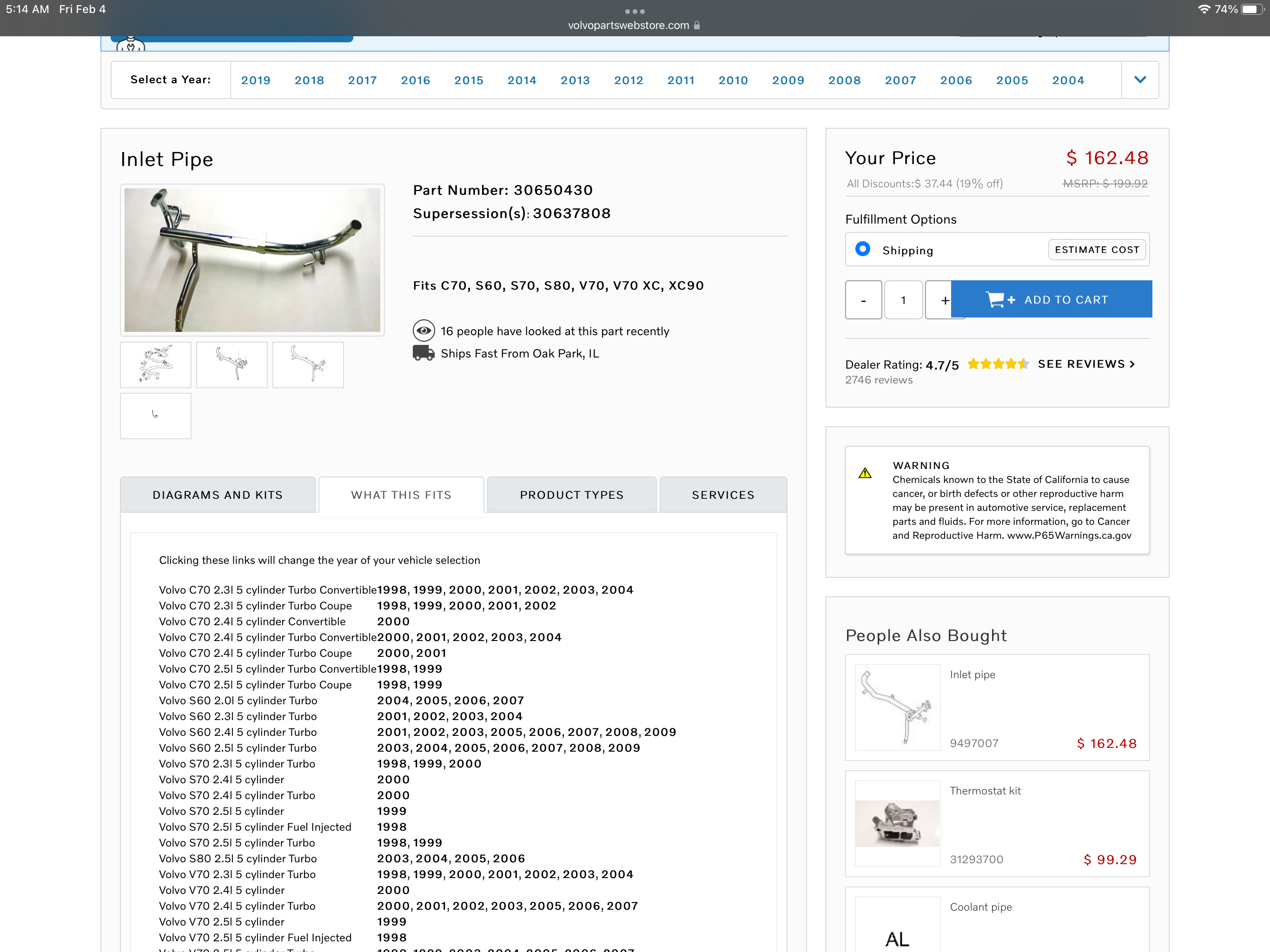

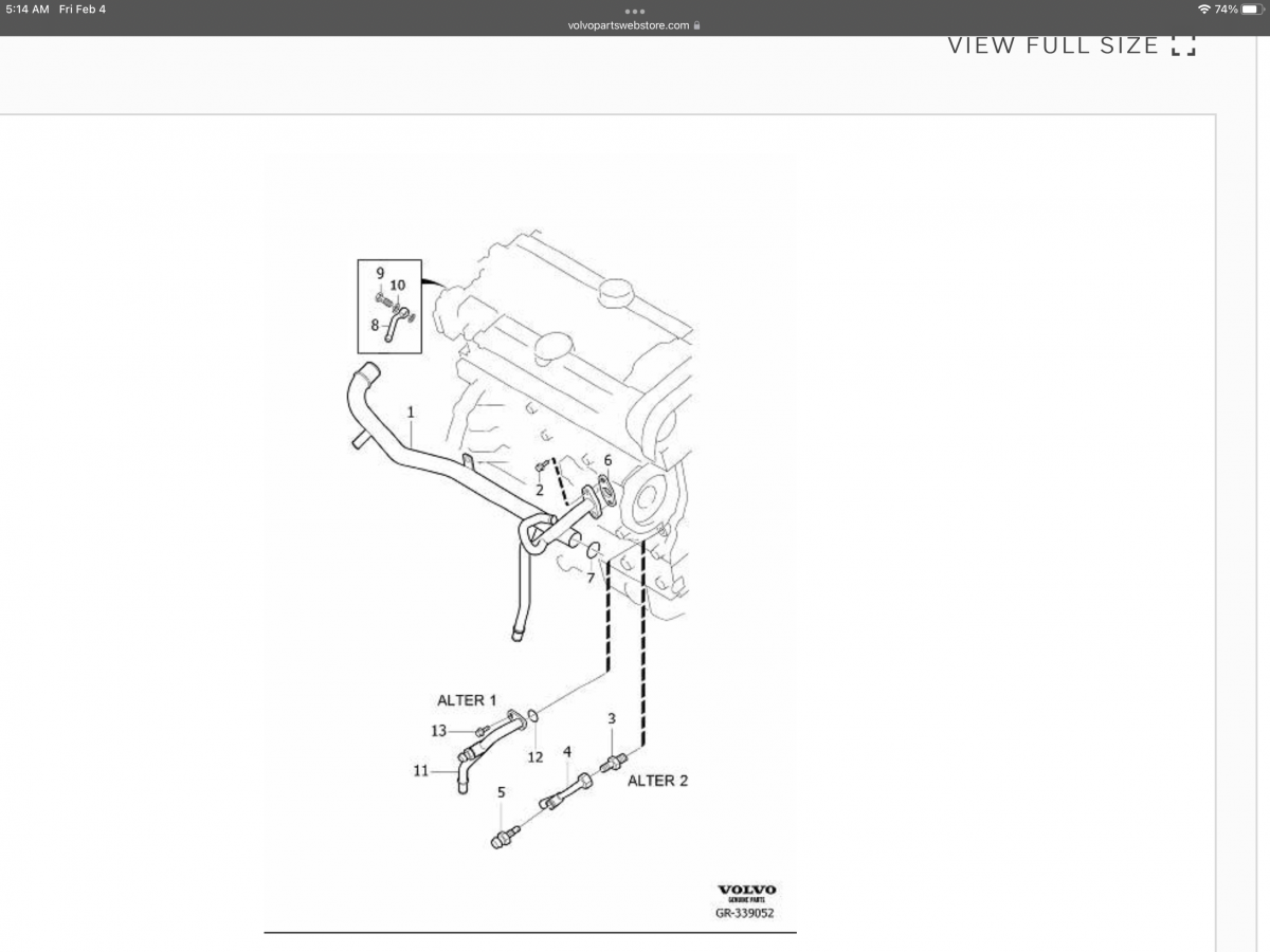

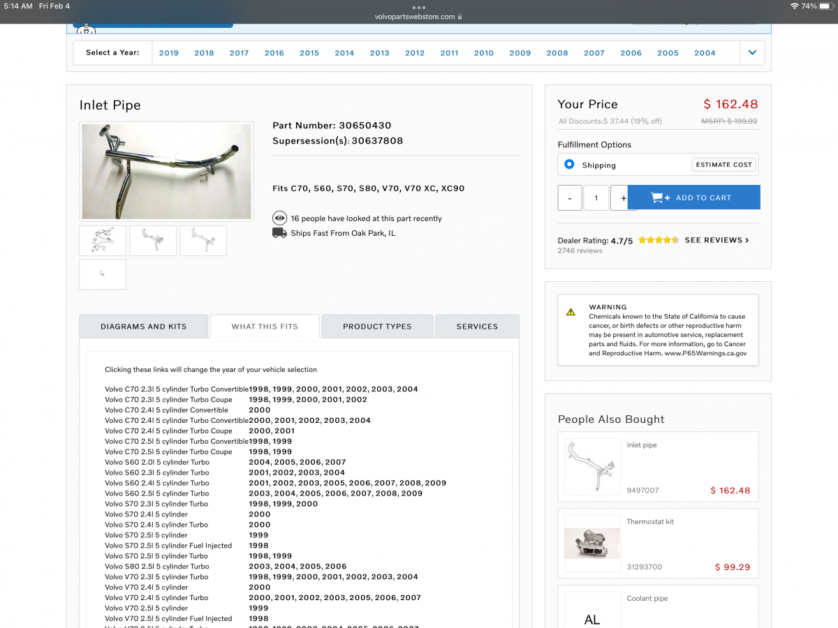

Coolant pipe info 9172744
WARNING!
The fitment chart is incorrect. Starting in 1999 the pipe extends longer and is angled towards the front of the car, so the lower rad hose is shorter. There are two pipes between NA and turbo models starting in 1999
There are three part numbers of pipe, so choose carefully
Volvo falls it a coolant pipe through 1998, then changes the name to water pipe in 1999-
Ooof
WARNING!
Ooof

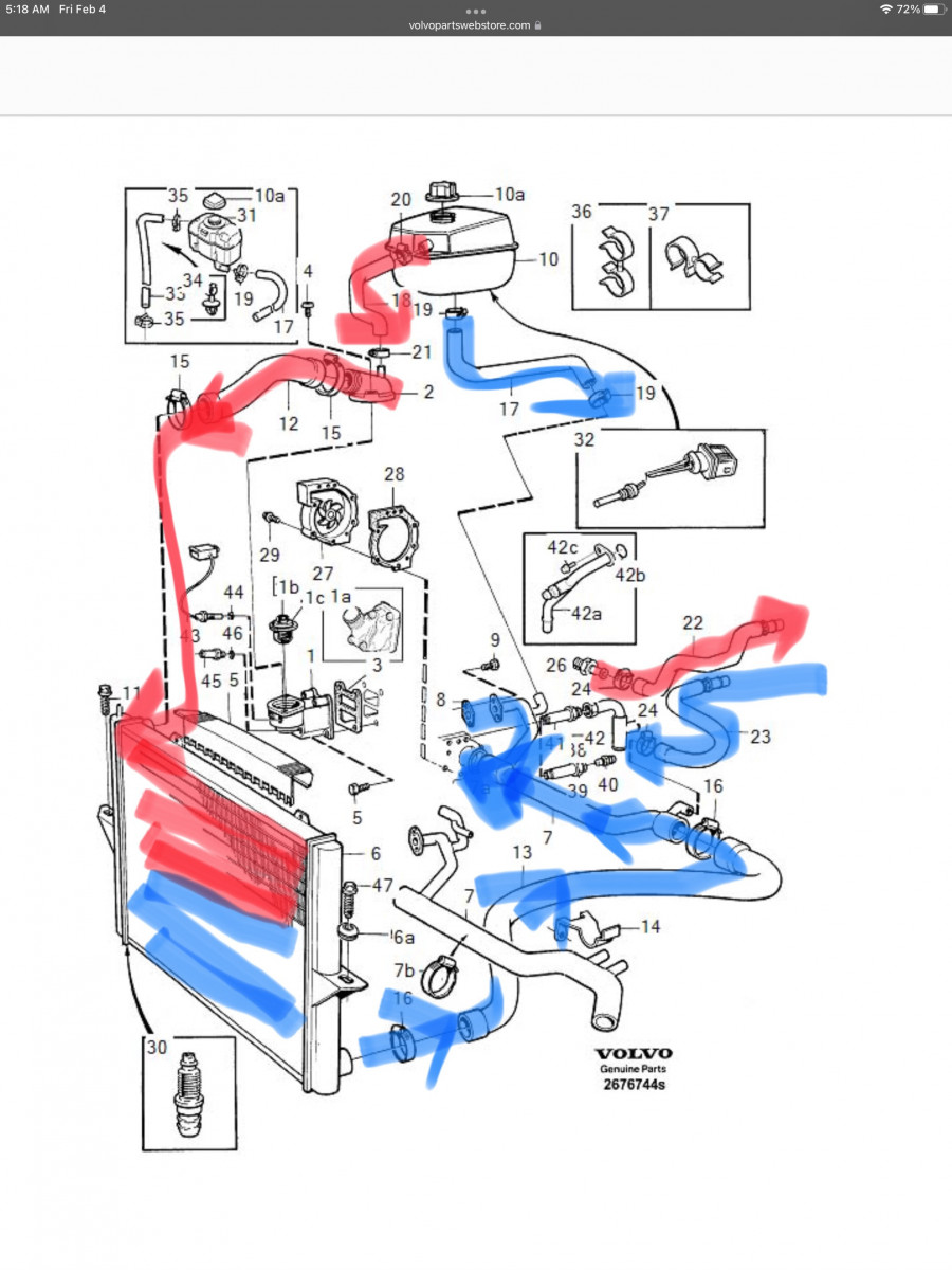

Sketched up cooling flow diagram
