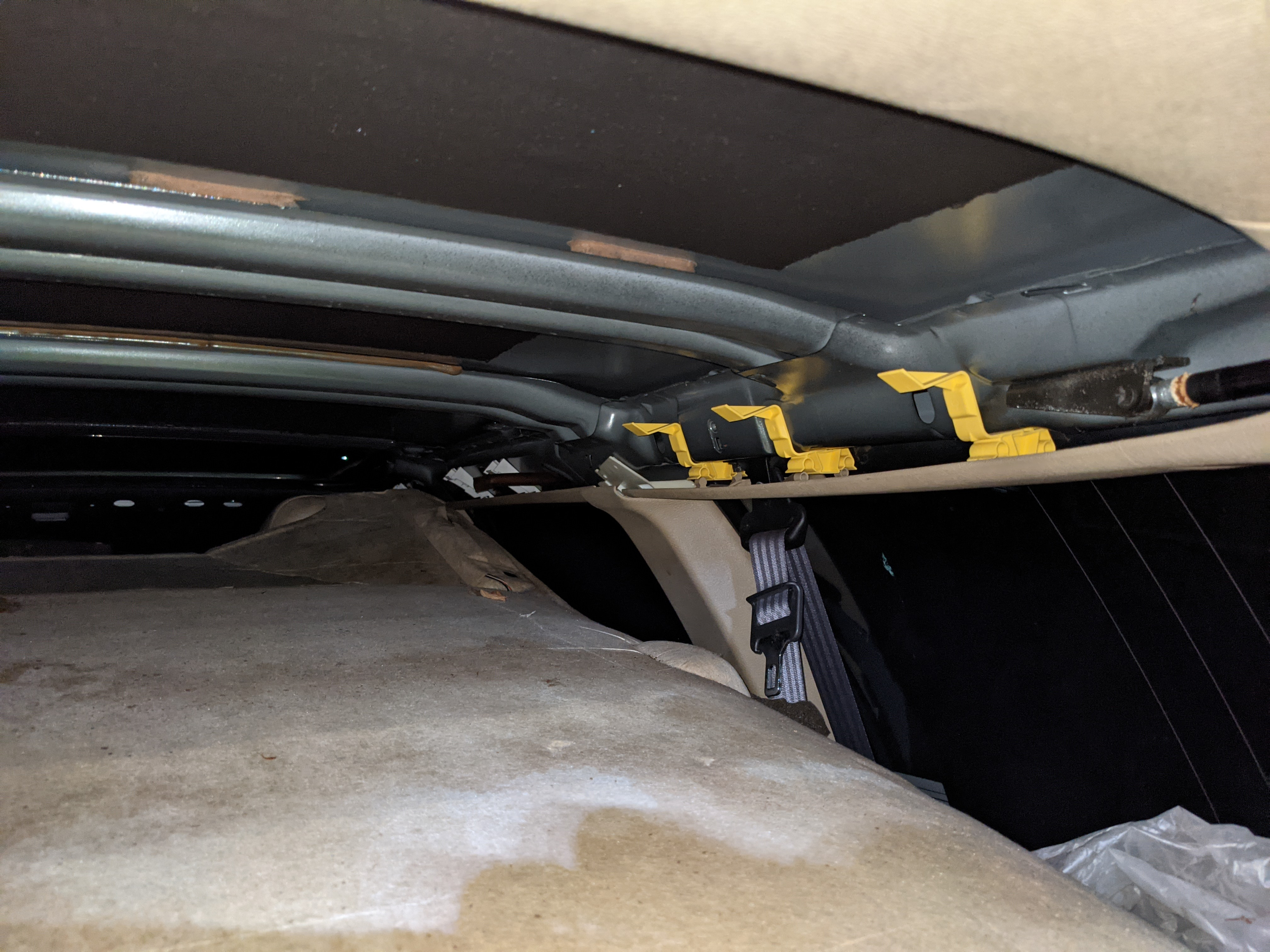

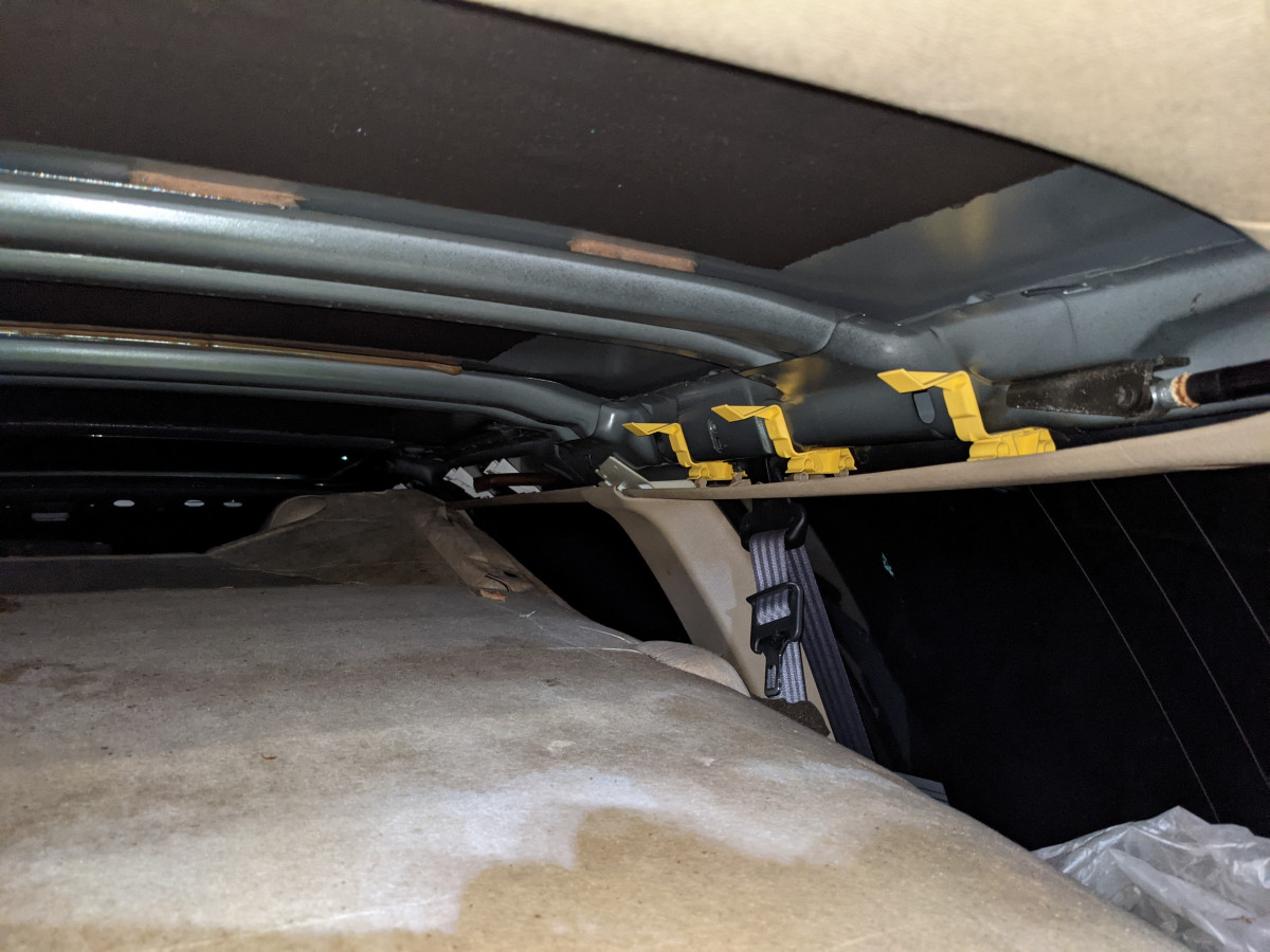

In 1999 and 2000 V70, there are four drain tubes for the sunroof, one at each corner. The front ones run down the A pillar. The rear ones seem to run down the C pillar. At least on the right side, the rear drain exits at the base of the C pillar and runs horizontally below the trunk window (remember, I'm talking about a wagon).

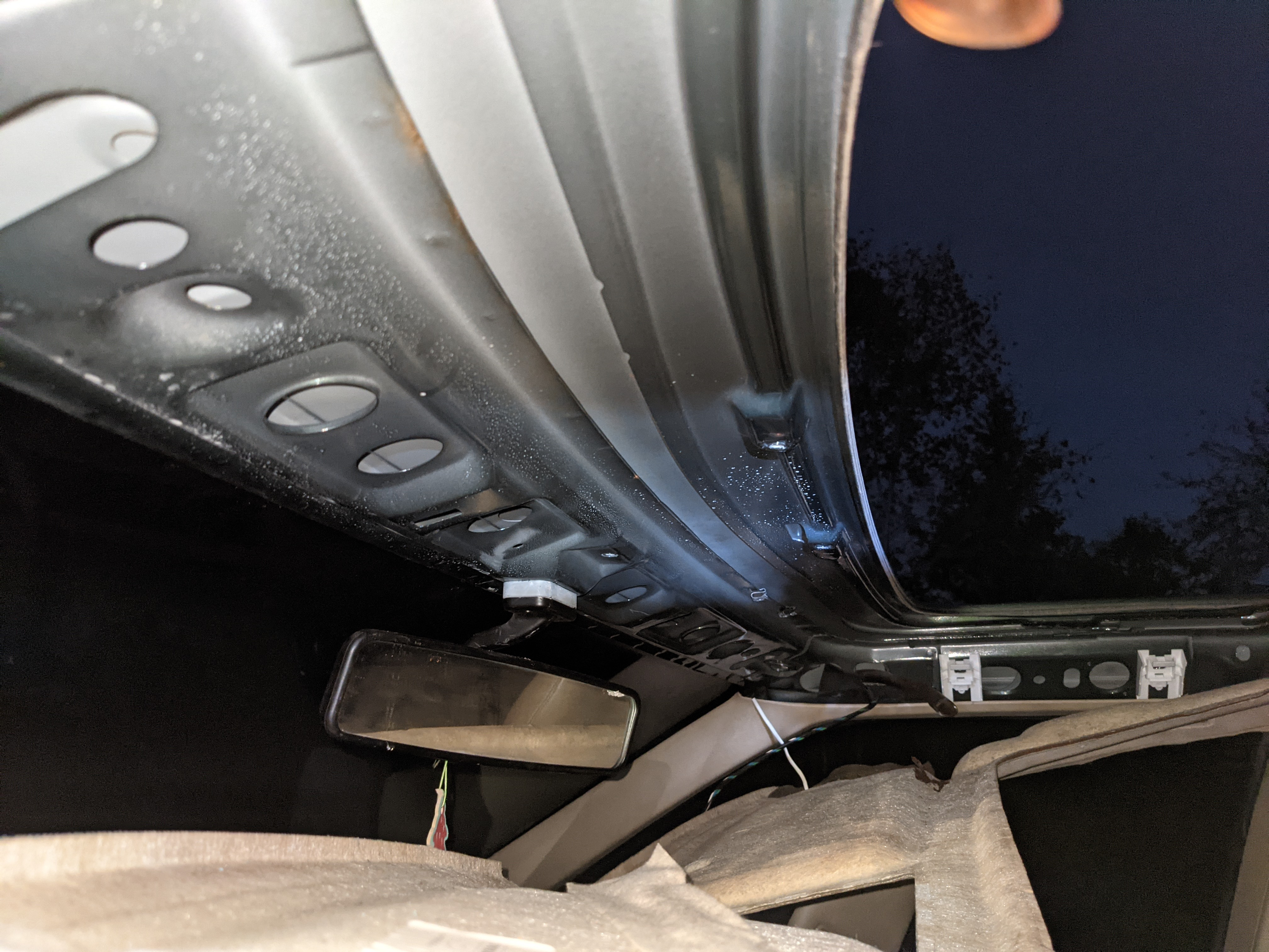

There are threads on here about repairing the headliner so they might have disassembly info. I tore one out at a junkyard to remove the sunroof assembly so here's what I learned from that:

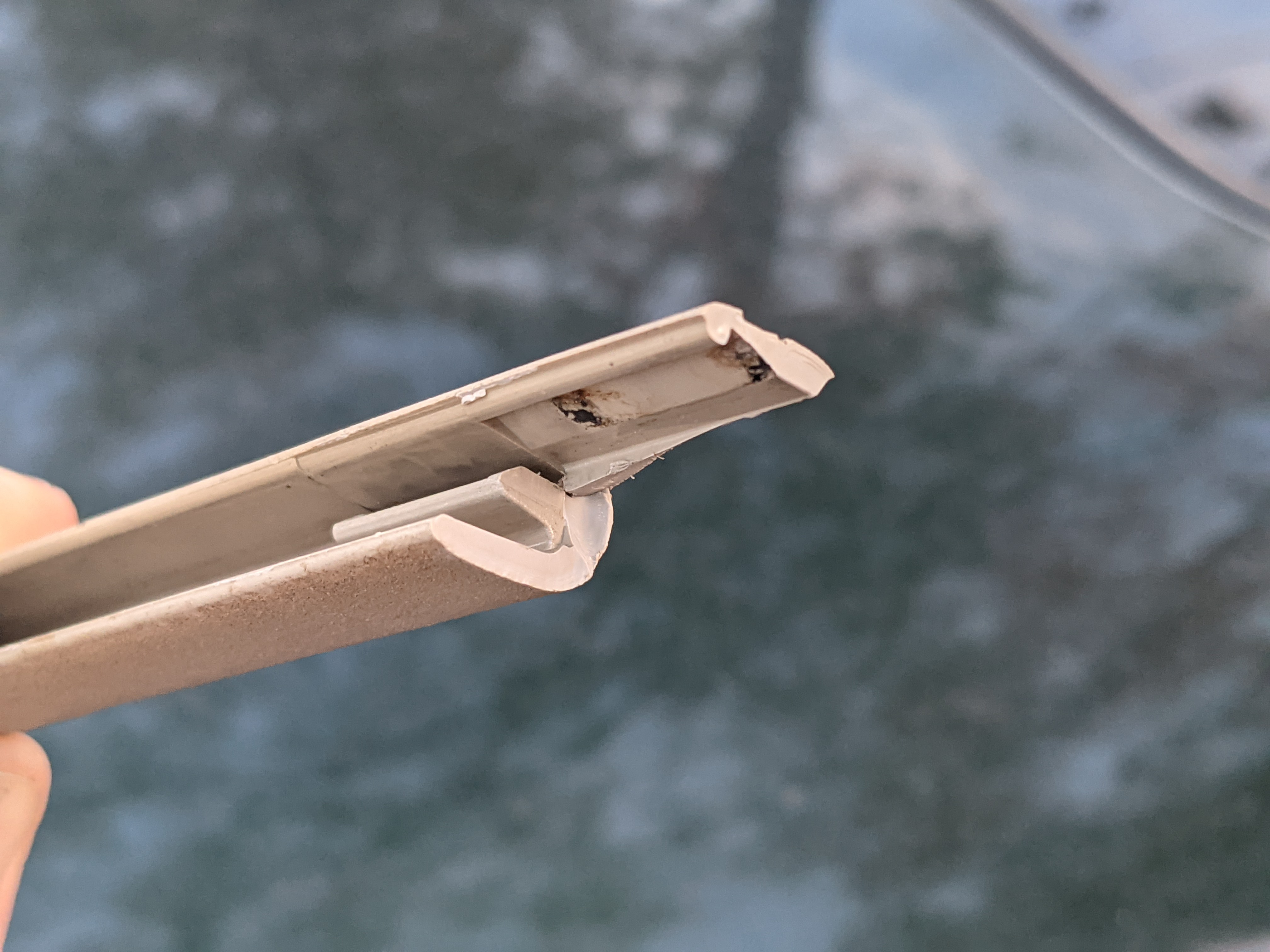

The hardest part is removing the sunroof trim. The trim grabs on to the metal using built in clips on its non-visible, upper face. The best solution is to wedge thin sheet metal (like a spackle knife) to raise that upper face away from the car metal. Open the sunroof fully and maybe you'll see what I mean. The attached picture shows the clips.

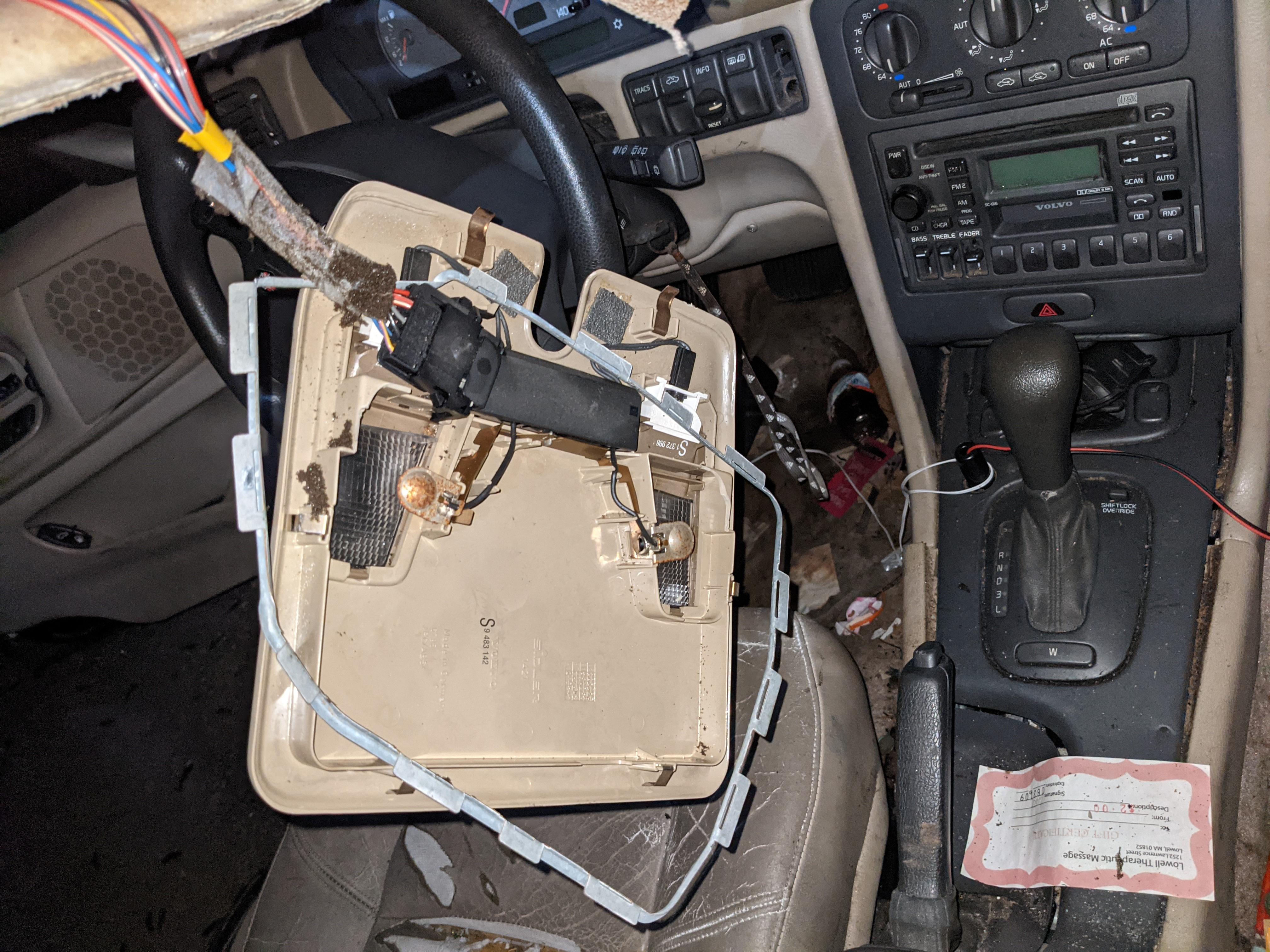

The second hardest part is removing the rearview mirror assembly. On the junkyard car, I had to just rip it down. Check my picture for hints on where the clips are. Unscrew the mirror because it can't fit through the headliner hole.
Third hardest part is the sun visor wires. They run down the A pillars. It will be easiest to remove the A pillars to disconnect the wires way down at the dash.

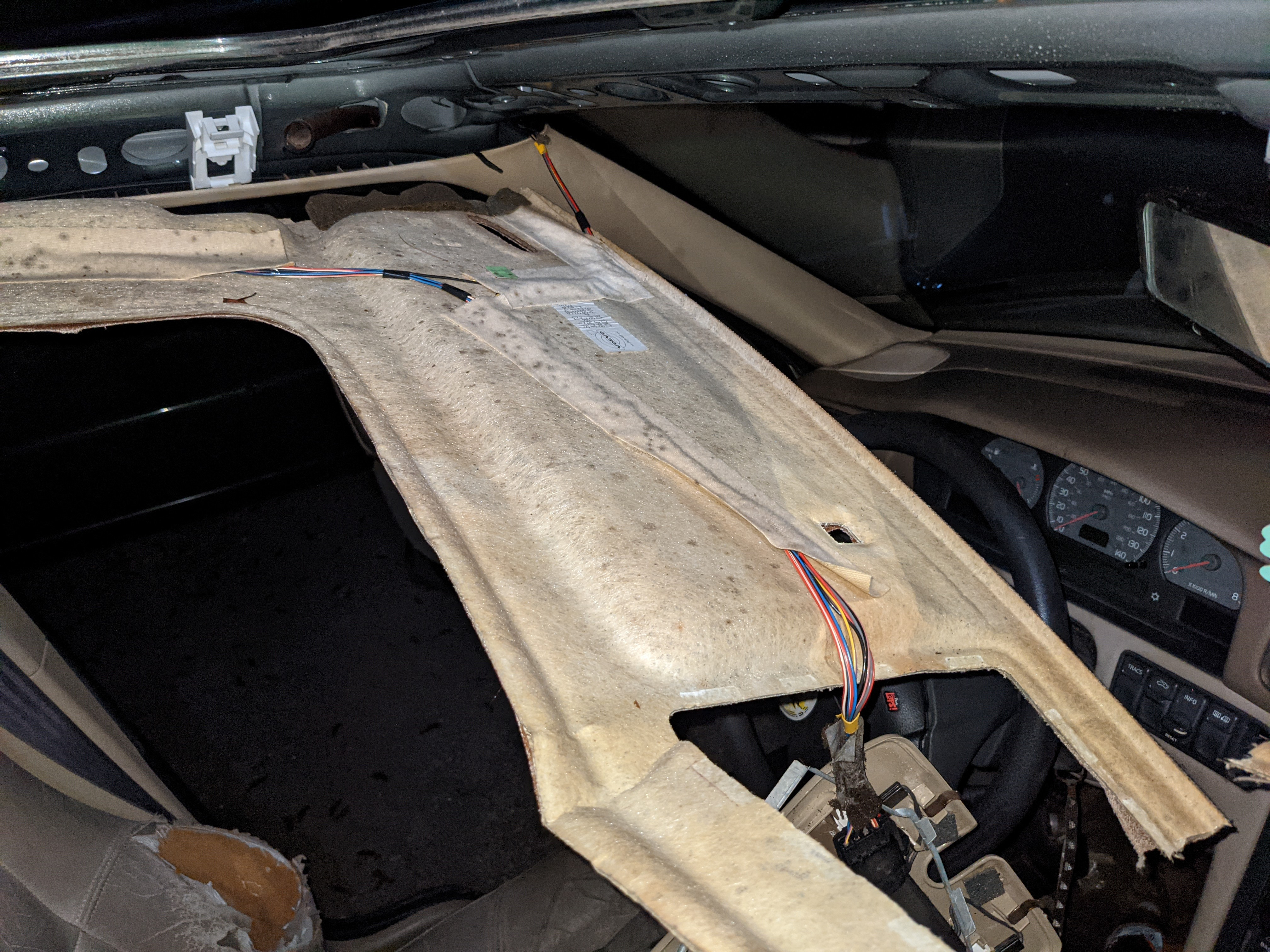

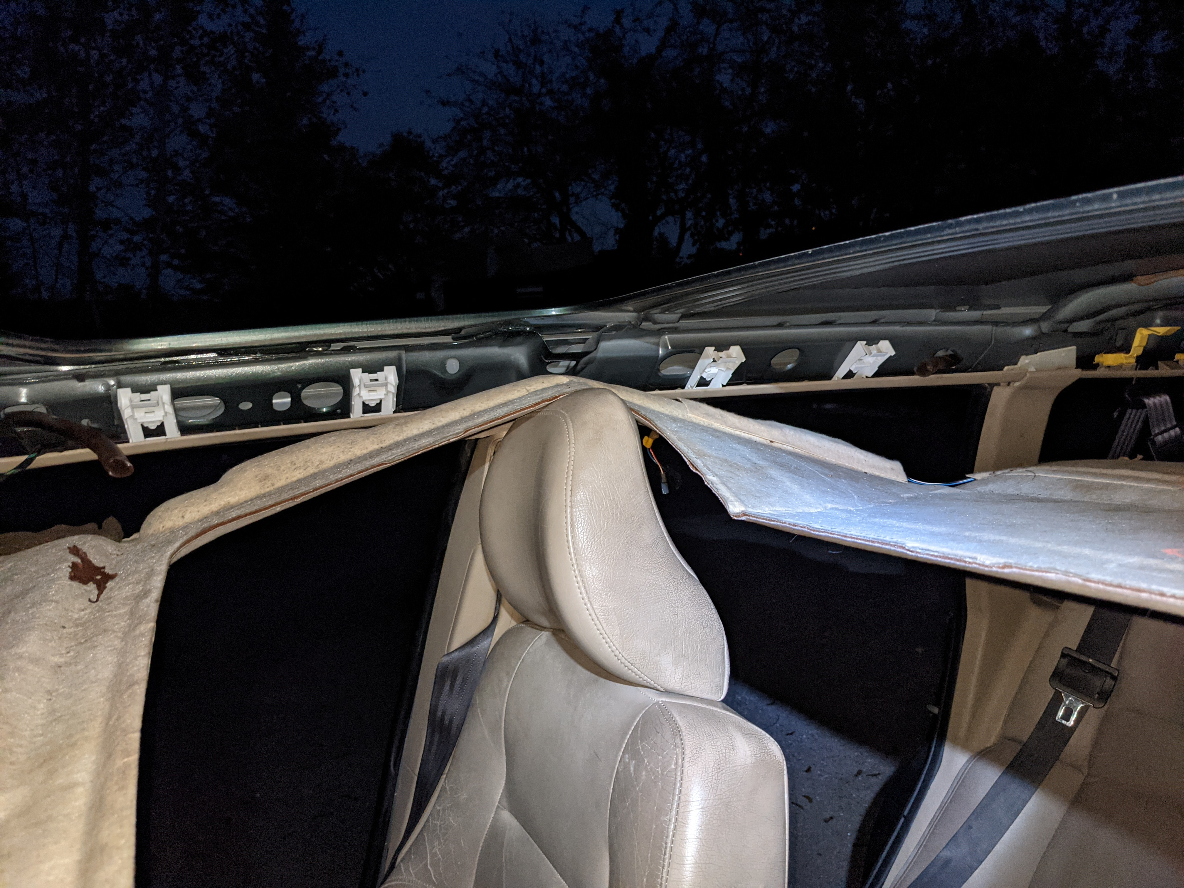

The headliner is mostly held on by the trim pieces but also has a few wires running through it. You can remove the pillar pieces, then the roof line pieces. The headliner board can be carefully bent just enough to sneak it out around the trim pieces. Be careful not to crease it. Remove the A pillar trim (for the sun visor wires) and B pillar trim (because the seats are in the way making it hard to work). Then gently bend the rear of the headliner in around the trim (since the trunk is more open, in a wagon).
I've attached some pictures of a 1999 V70 to show what's up there. I should have been more gentle with that headliner board because it was perfect. The rear removed easily with all the trim in place and no damage to the board.
