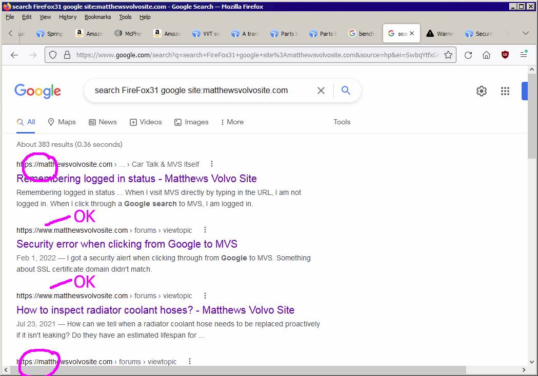

In case anyone else is wondering, I've attached screen shots of the offending search results (without the www) and the SSL error shown by my Firefox browser.

- MVS www error.jpg (116.09 KiB) Viewed 362 times
- MVS www search.jpg (123.52 KiB) Viewed 362 times
