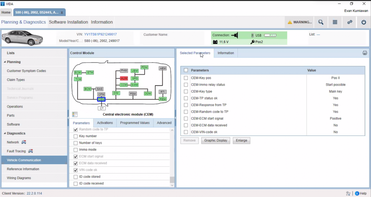

When the car stalls, spark is lost, and the injector stops pulsing, as if the ECM is preventing the car from running. A live data report from the CEM (attached in screenshot) shows CEM-VIN-code ok to be “No”.
Does this mean the ECM reload fails to program the “virginized” ECU with the correct immobilizer code? Anyone can shed light on what I could try next?
