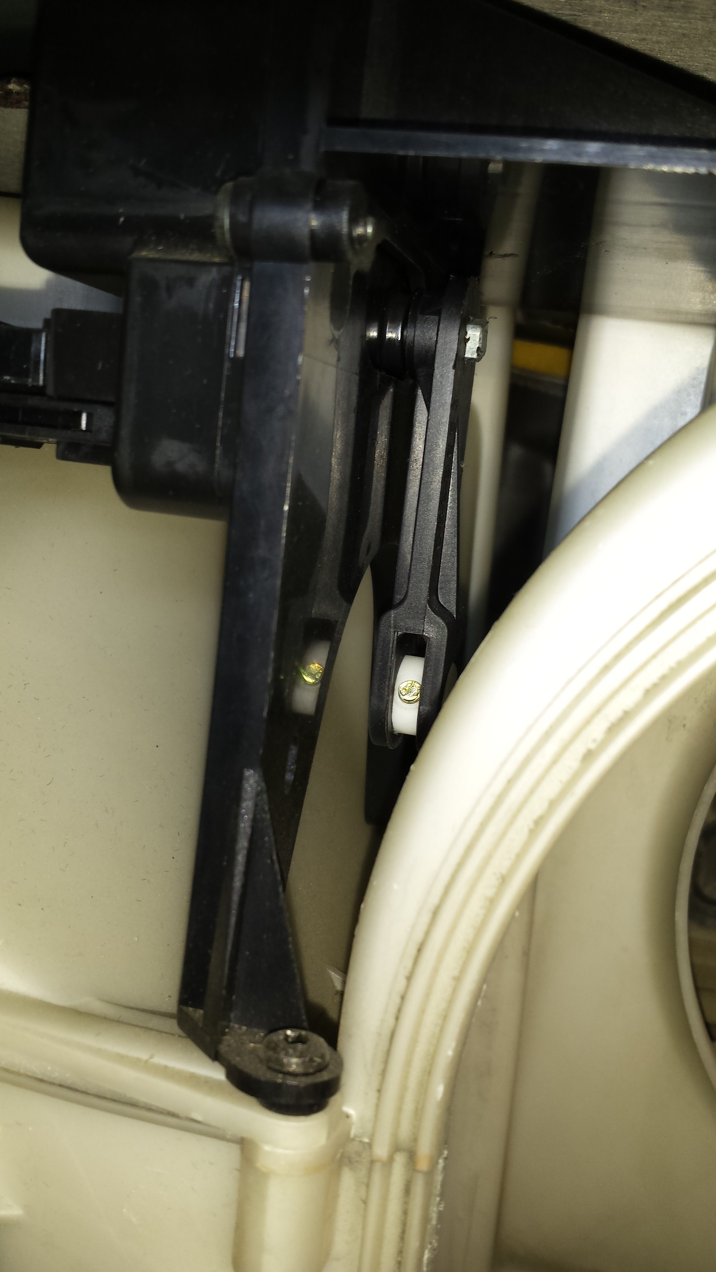

There is a little plastic arm about 3" long that fits over the arm of the flap and the other end over the servo motor arm. Tomorrow I will see if I can find one to show you.
The servo motor is easy to remove. There is a small Torx screw (T15?) if I recall at the top edge of the motor. Remove this and the motor should slide out toward you.
When fitting a replacement arm, use the cotrols on the ECC unit to close and open the flap so that you can make sure you fit the arm in the right place.

Just searched through my pictures over the years and found this one:
The arm is the black up and down arm in the upper center of the picture. You can see at the top of it the square silver drive from the servo motor. At the bottom the white part with the brass piece in the center is the arm to the cold are flap. It is fiddly and the arm has to be fitted in a particular way.
The screw for the servo motor is just above the arm and we are viewing it side on with the hear of the screw to the left.

The arm on mine is white and I believe snapped at the square hole, so it just flops around now. It's 14 in the PDF you linked, but 18 in the stuff online from the Volvo parts site, they must have changed the numbers in later revisions. I get 6808653, which seems to be available from Ipd, and FCP, but hard to find with their own systems. Google found them first.
So I guess it just slides over and floats on the square actuator shaft, but how does it attach on the other side? ...to the push rod or "link arm" as Volvo calls it? There's also a "bushing" in there, but it seems to be a retainer of some sort.... FCP has it: 9137233. It's not clear to me how that fits together.
I'll see if I can get in there with my phone/camera and get an up close picture of what's there on my car, as far as that broken arm.
