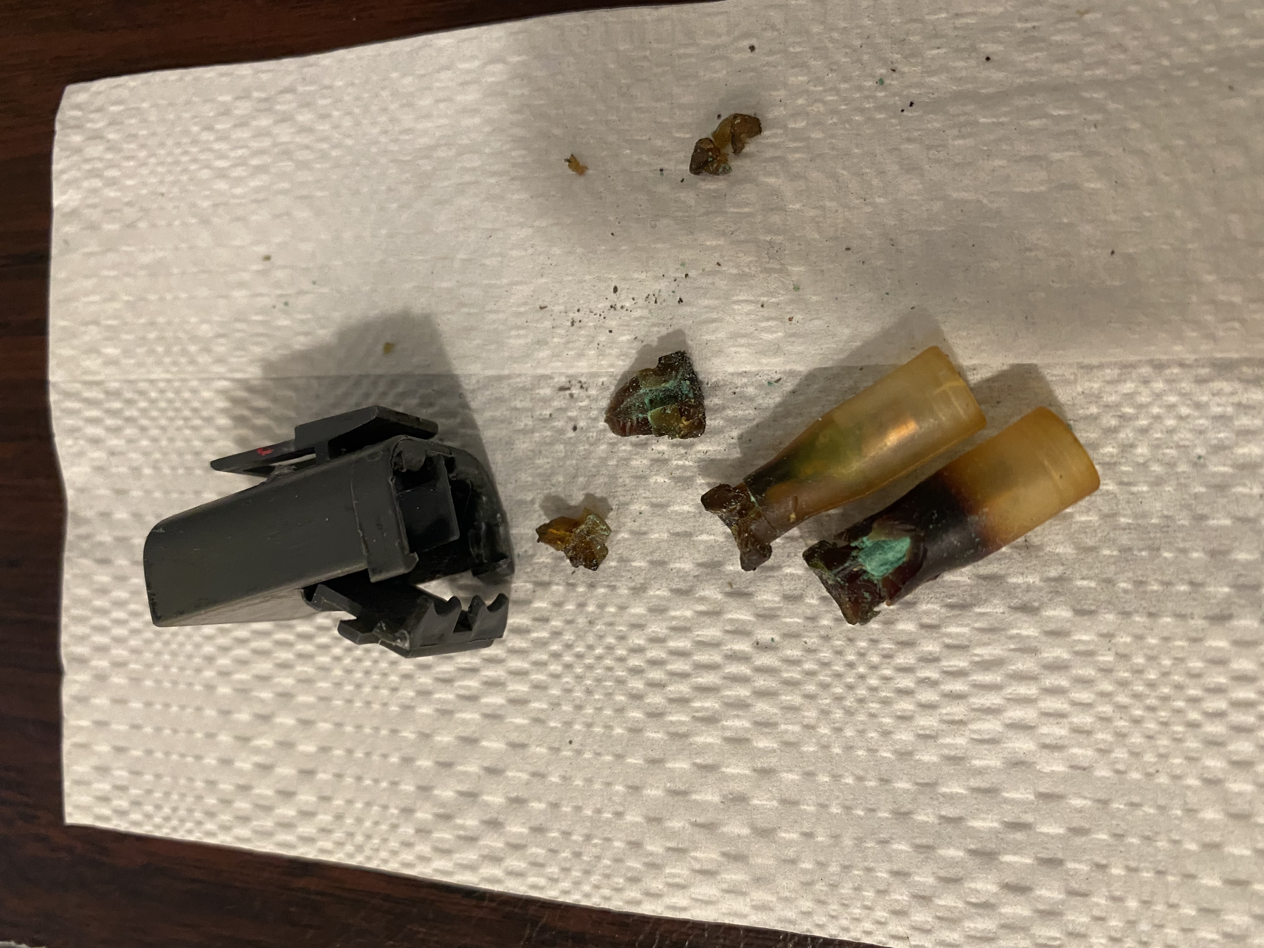

I managed to open up the old one. Failure obvious, corrosion, resistance , heat, strain relief failure , wire failure
They pop open with a scout knife and the connectors can be remade
Connector needed. Cooling Fan relay

I think the harvested item was a little cleaner, had some spooge on it that I figured was dielectric grease.
