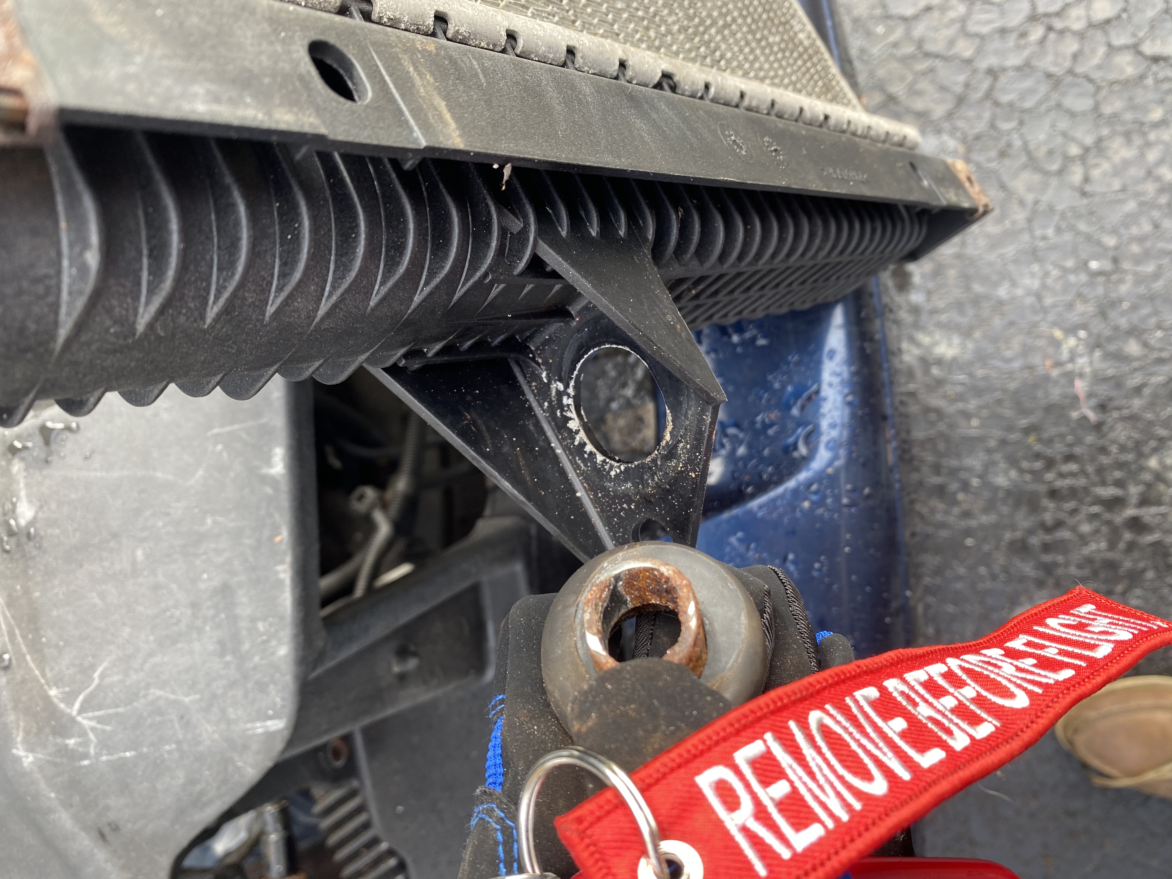

Just pulled two off Jane Bond… you only live twice
- D9BCB3DA-C636-4DFC-B277-AC45F8FA31A1.jpeg (2.83 MiB) Viewed 869 times

I too, learned this in March 2022. I’ve been running it since 2013 without these. I’ve also ruined a radiator , probably from vibration. Use stainless nuts and bolts to hold these in. It’s a real rust spot
