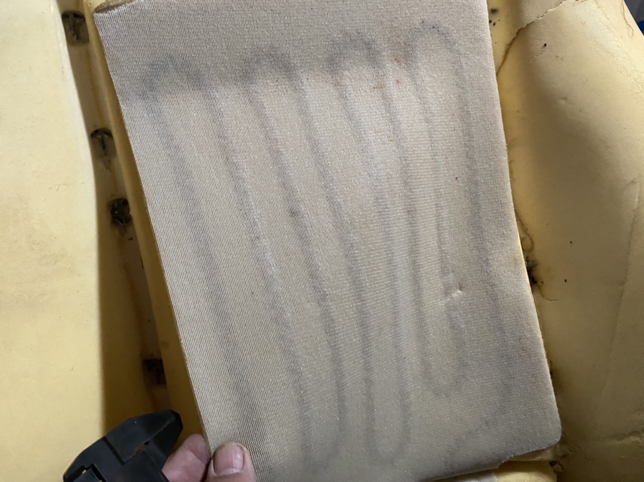

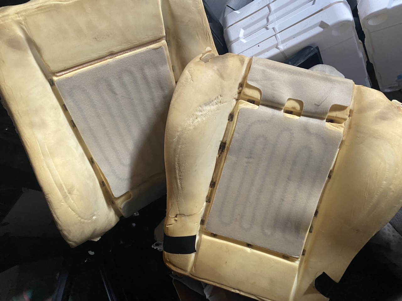

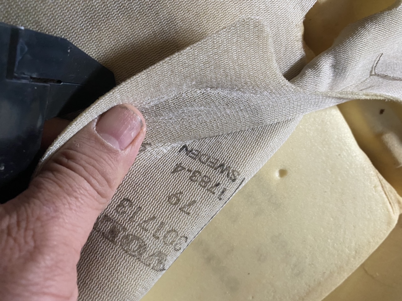

I managed to find some in between trips for Easter. The heater elements are really easy to remove from the foam.
They probably only rate at about 50 watts max, so 4 amps draw at 12xvolts. They should test out on Zohms scale at about 3 ohms +_ 1 or so
