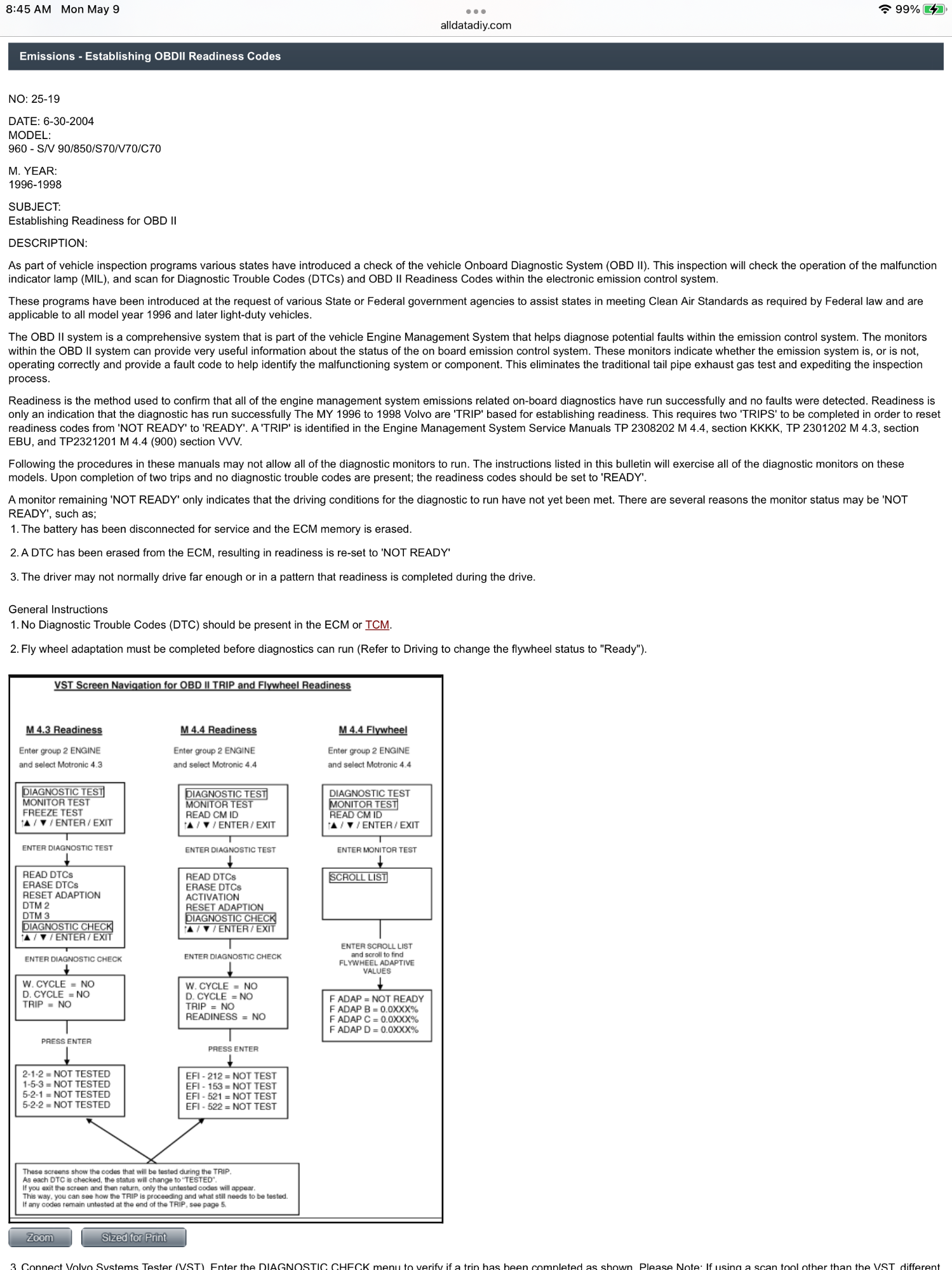

Here you go. Volvo requires this to be done twice.

Yikes, do you have to stand on your head and clap three times too while doing the runs? ha ha.
Who is the nut job that designed this procedure. It takes an hour just to read though it all.
Is this really for a 1998 v70 or for any Volvo?
