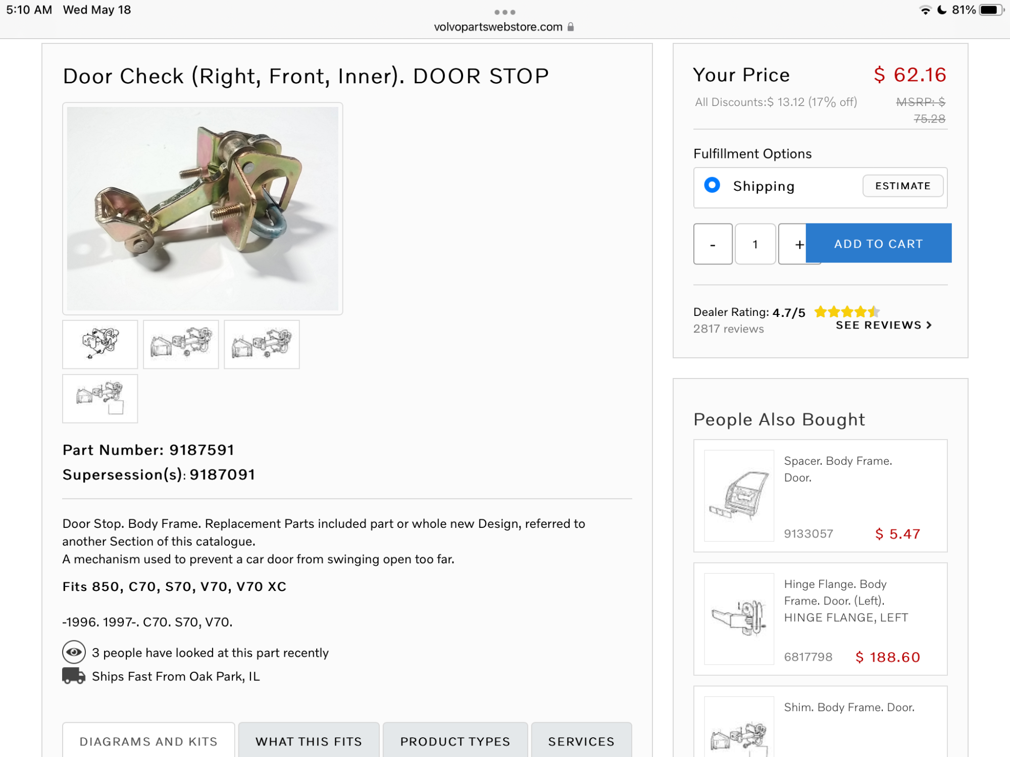

- Posts: 36140
- Been thanked: 4064 times
Different part numbers in webstore …..
