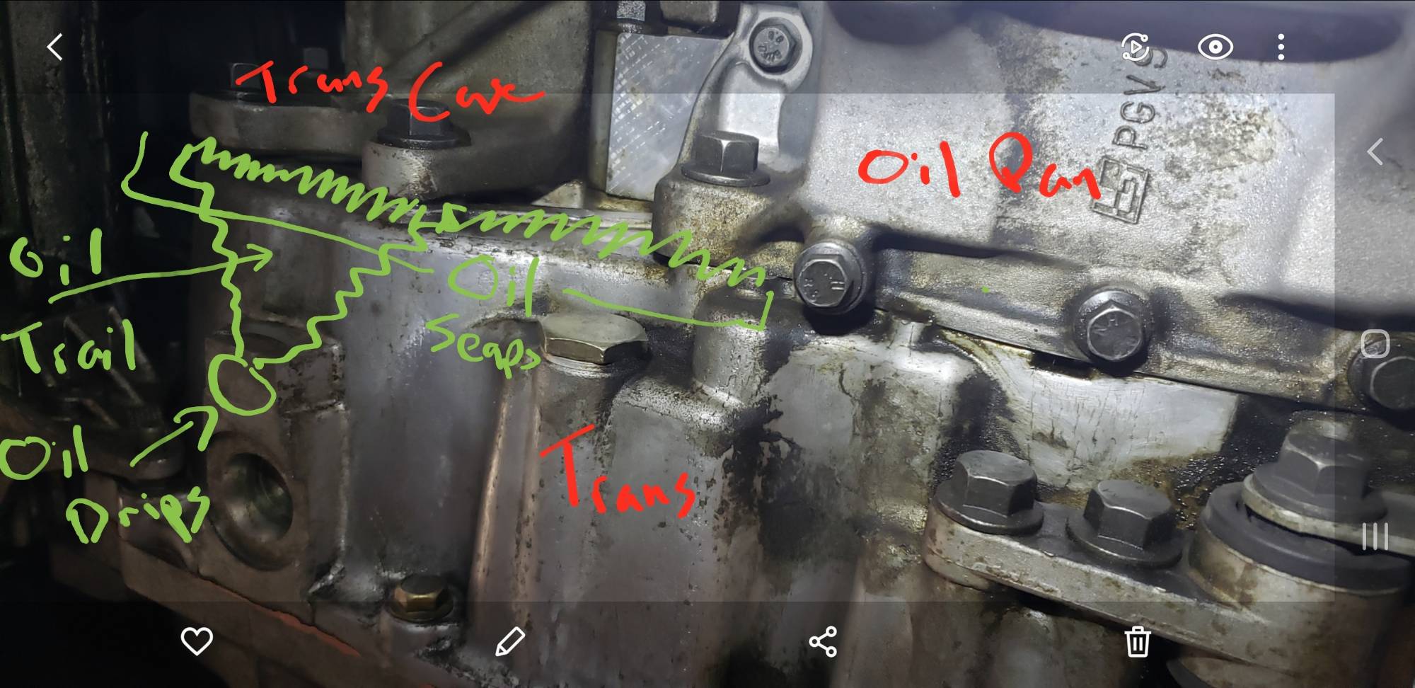

I have a mystery motor oil leak that I need help figuring out where its coming from. On the attached photo I have marked where I have seen where the oil comes out of as a seap, the trail, and where it was dripping from.
My thoughts are the seal between the transfer case and transmission.
Or the rear main seal.
The turbo oil lines are fairly clean, just the usual wear and dirt.
No oil coming off the rear cam seals.
The PVC box is not clogged either.
Any other ideas or locations?

Dope the Oil with Tracer dye then use a Ultraviolet (UV) lamp to trace the leak back to the source.
