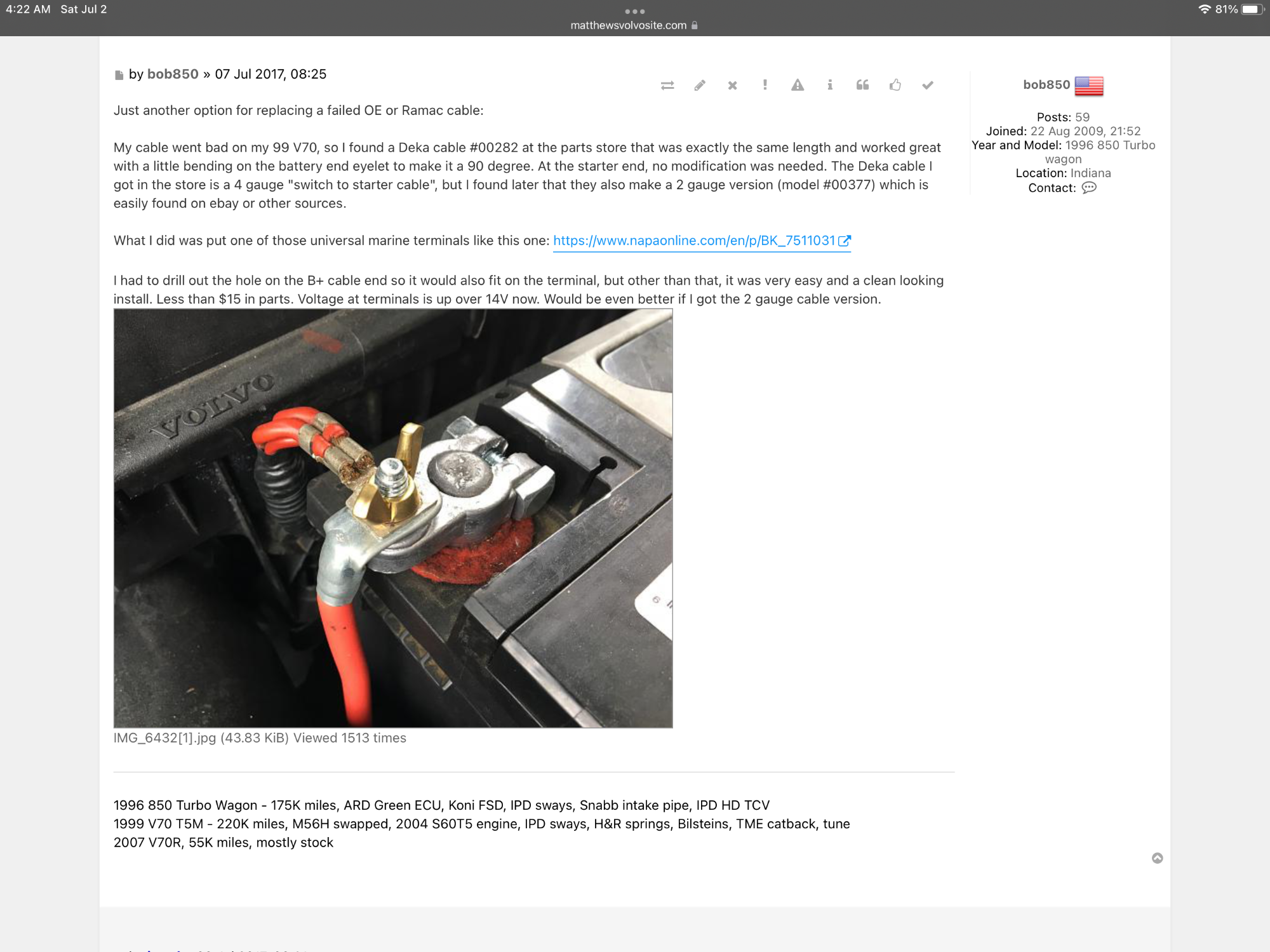

Neat solution frombob850 in the above link
And kudos to bdub for being the guy who will inspire us to routethe cable back in the factory channelJust another option for replacing a failed OE or Ramac cable:
My cable went bad on my 99 V70, so I found a Deka cable #00282 at the parts store that was exactly the same length and worked great with a little bending on the battery end eyelet to make it a 90 degree. At the starter end, no modification was needed. The Deka cable I got in the store is a 4 gauge "switch to starter cable", but I found later that they also make a 2 gauge version (model #00377) which is easily found on ebay or other sources.
What I did was put one of those universal marine terminals like this one: https://www.napaonline.com/en/p/BK_7511031
I had to drill out the hole on the B+ cable end so it would also fit on the terminal, but other than that, it was very easy and a clean looking install. Less than $15 in parts. Voltage at terminals is up over 14V now. Would be even better if I got the 2 gauge cable version.
- 2E356E1D-BCEE-4092-A451-DC9AB75EADDA.png (1.09 MiB) Viewed 1201 times

abscate wrote: ↑02 Jul 2022, 02:20 Neat solution frombob850 in the above link
