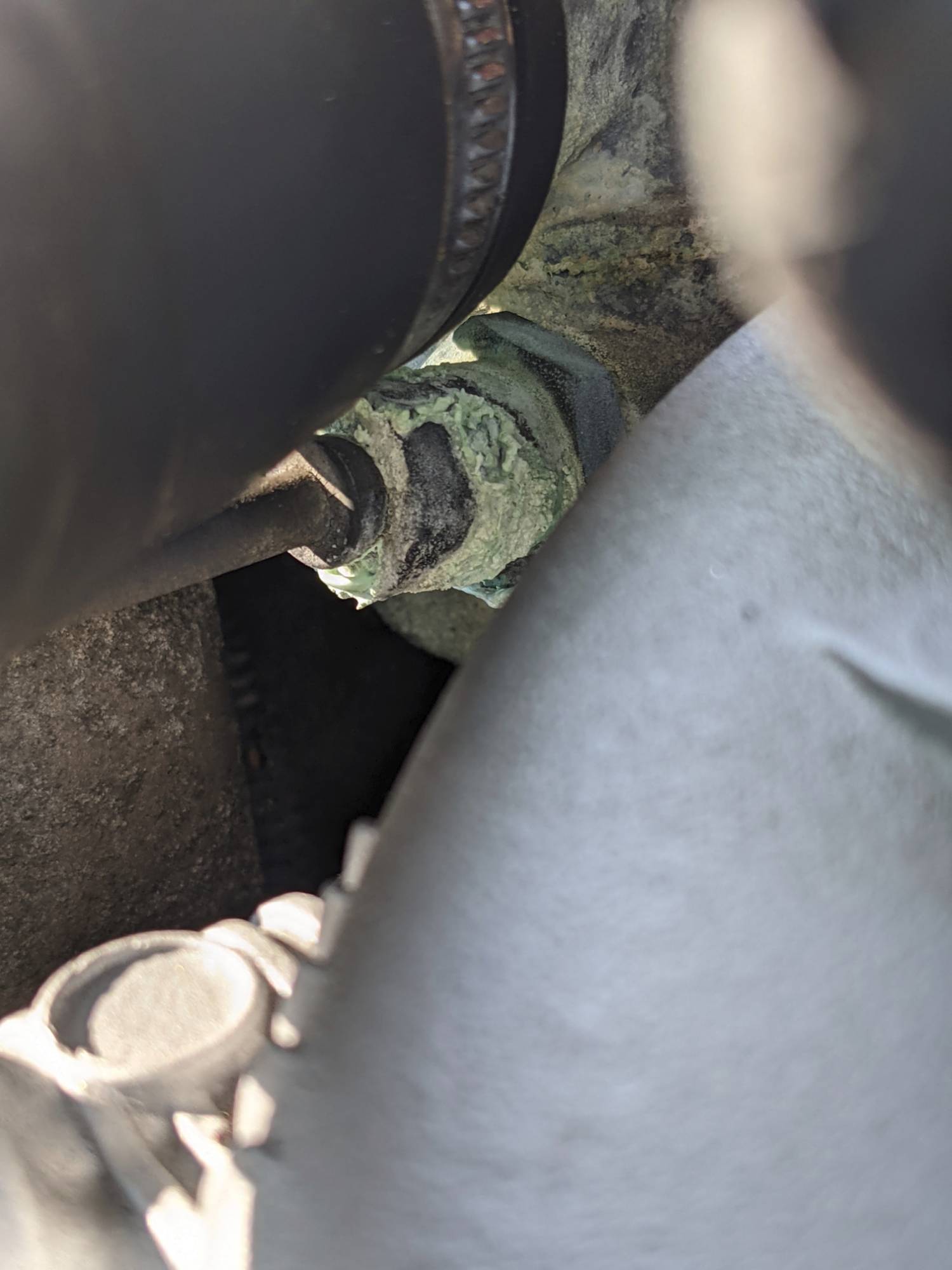

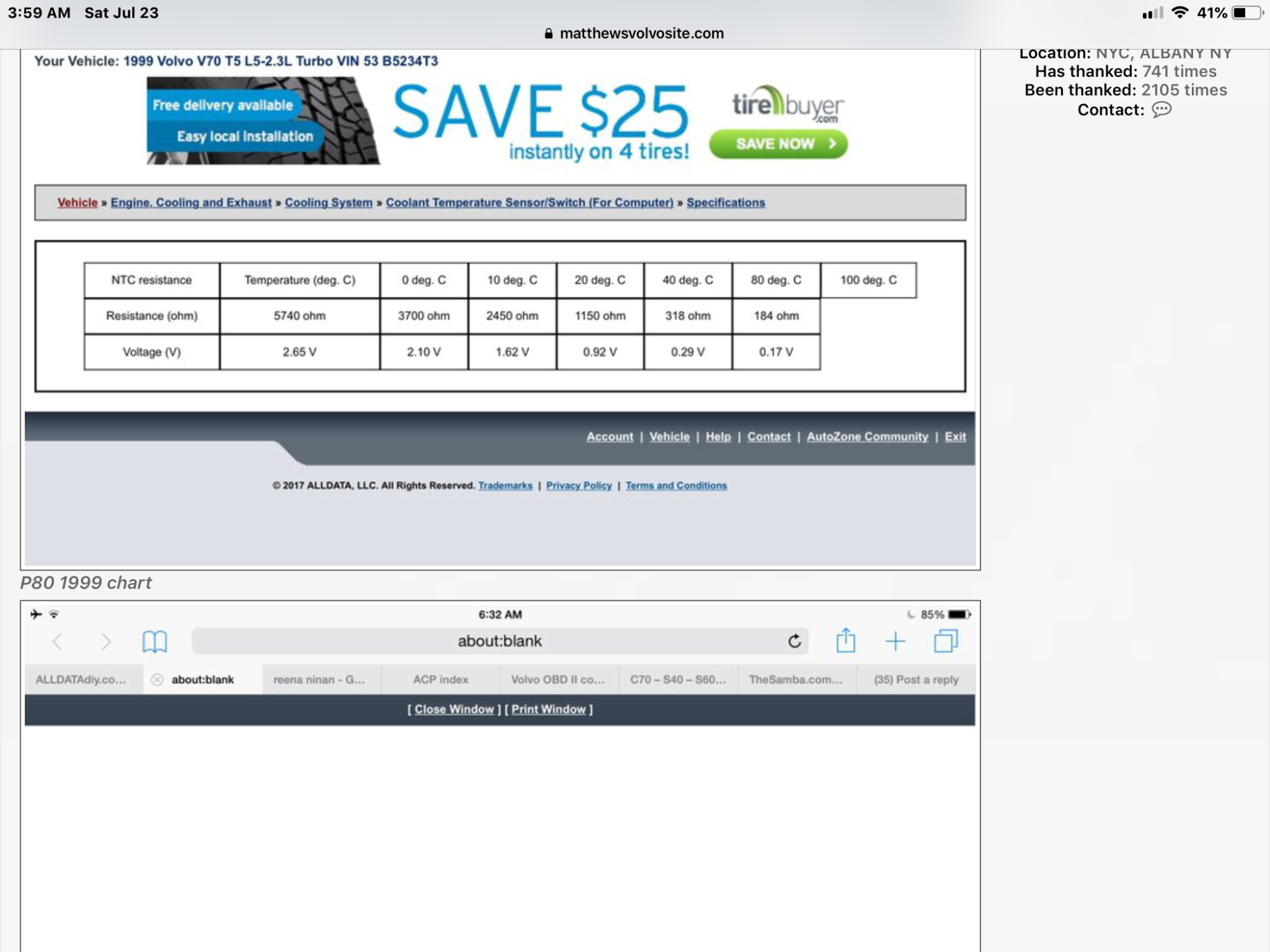

The sensor in my thermostat may be damaged from coolant dripping down from my loose coolant hose. A multimeter reading across its pins read 1.537 k Ohms. VIDA has reported " CCM-135 Engine coolant temperature (ECT) Signal missing " for four months. My dashboard thermometer works fine and VIDA seemed to report temps accurately. Since summer heat started, my engine fan occasionally runs for a few minutes after stopping the car, typically after short drives when the engine is warm, not after five hour highway drives.

Did you try moving the coil to isolate the fault?
See look up table for 1999- on style ECT ( they glitched the formatting a bit and shifted the columns one box over)

Thanks for the ECT data. I'll check mine more closely before installing the one I just bought from FCP.
